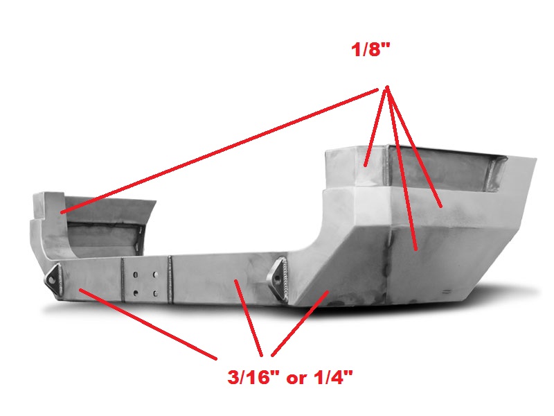

I'm considering building my own rear bumper out of plate.
I know that others have taken this on, on a variety of generations of 4R's. (mine happens to be a 4th gen)
My biggest question at the moment is material thickness. I'm very concerned about weight. I'm strongly considering building the bulk of the bumper from 1/8" plate but using 3/16's or even 1/4" on the core areas.
Take a CBI bumper attached... does anyone know the thicknesses? Are my suggestions reasonable?
Thanks in advance.

BTW, a guy on the 120 forum responded to a similar post saying he used 1/4" on the structurally important areas and 10 gauge for the rest. Kind of interesting.
Any areas that will see rubbing or any sort of trail contact should be 3/16 or thicker. Only the cosmetic panels should be any thinner. Structural ribbing or frame mounting areas should be 3/16 or thicker.
