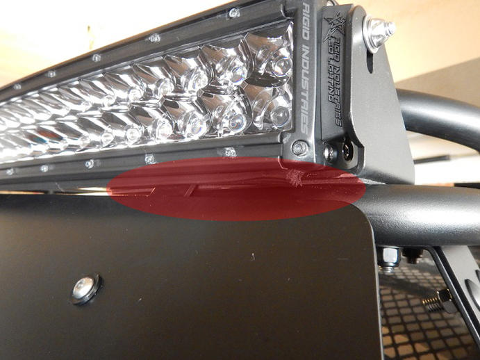

Looks like you have a gap under each side of the fairing -- that could be causing the whistle.
The center bracket should be out as far as it can be, about 1.5" - 2". The sides of the fairing should be touching the rack. This is how mine is, no gap and no whistle. But there is still wind noise when headed into a strong headwind, which I expected.

I'll have to try and readjust tomorrow. It was a lot harder to do with the light bar on. I had it pretty flush the first time around. I adjusted it when the light went on.

So I went out and readjusted everything I could with the fairing. And I still have that gap, and a slight whistle.
I'm almost sure, but I haven't checked with Gobi yet, should the fairing brackets be mounted ON-TOP of the light bar mounting brackets. I would check my brothers rack but he didn't order his Setup for a 40" light bar. I guess I could mount them underneath and slide them up in the L brackets but I'm all out of room on the bottom end. The whistle goes away with some Grateful Dead channel on XM!

So I had the Gobi installed: no whistle.
I installed the 40" curved light bar: whistle.
I tried adjusting the fairing without any improvement. I decided to just start covering all the areas I thought the whistling might be coming from ( with duct tape) and drive around after each area was covered. The whistling started at about 40 mph, so I could do it around the neighborhood. In my case, it turns out that the little gap below the fairing at the ends wasn't the culprit. When I covered the space between the bottom of the light bar and the top of the fairing, the whistle went away. I took off all the pieces of duct tape, and I filled most of the gap with a weatherseal product from Home Depot. The black rubber pretty much disappears between the light bar and the fairing. Even if it doesn't last forever, at least I know where the problem is.
