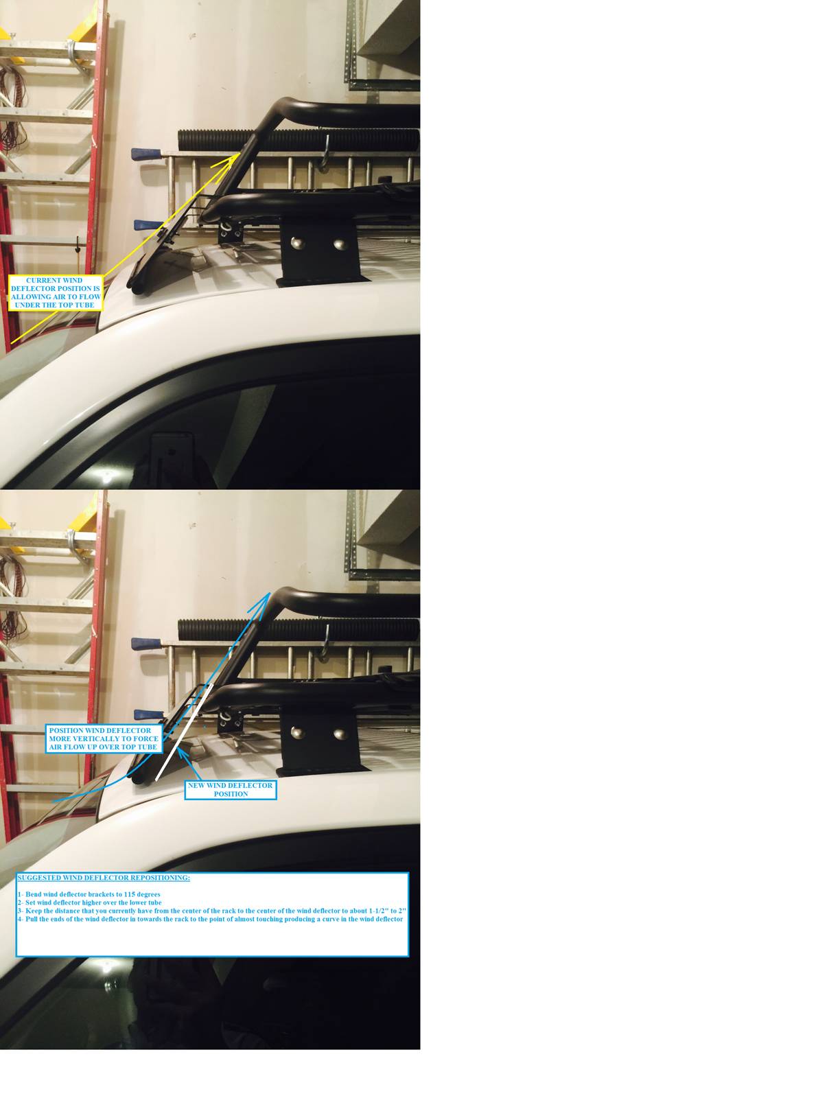

I loved my stealth, ordered it probably 6 weeks before I got my Pro. I did end up selling it and buying a Baja Rack though. Not because I didn't love it, I just couldn't get the fairing to not whistle. I probably tried 30 configurations and couldn't get it right. Ended up driving me crazy. Opted for the Baja Rack and have been very happy with it, but wish I could have got the Gobi to work. I attached a picture Gobi sent me for fairing adjustment. Might help some of you all experiencing wind noise.

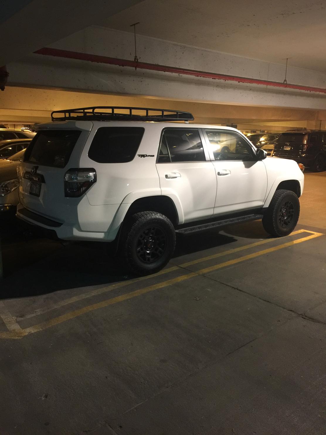

Held up great with 2 boards on it in white out snow!! Whistles yeah, the Light bar doesn't help either. The only thing that sucks is my Yakima Fat Cat 6 snowboard holder spins like a mofo on those round bars. I think there's an adapter. Kinda sucks to buy something extra. [emoji35]
