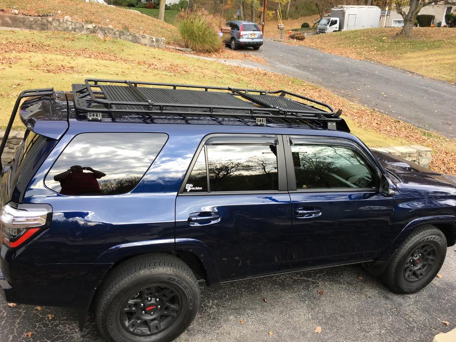

• Took me 30 minutes to do the ladder.
• Took me just about 2 hours 15 minutes to install the rack including taking off my old rack.
• Took me 10 minutes to install the tailgate struts - I did this alone by propping the tailgate up with a long stick
• Climbed up on the roof rack and installed the fairing in 5 minutes
I had carefully read the instructions and had tools, denatured alcohol, masking tape ready. The silicone I bought sucked so I did not use it on everything. My wife and I lifted the rack on the truck and covered the roof with dog beds so we didn't scratch the roof. It worked perfectly. The rack is pretty heavy.
I plan to put my Tepui RTT on the front of the rack, two large Pelican cases on the back and my CVT Batwing awning on the side.
Teeth to the wind,
Sno Dawg - Owner of MARSHA 2015 4Runner TRD Pro

Have you noticed a gap on the inside of the rain gutter where the two bolted down brackets sit on the roof? On the outside it seems flush, but on the inside there is about a 2mm gap and obviously water is going to get in there..
I did but I sealed the hell out of it with 3M 4000UV and am not concerned with it. If you look in the gutter itself, it's pretty obvious that rain gets in there anyway with all the built up dirt only after 6 months of ownership. I don't think the rubber is meant to seal it so much as it's meant to cover the seam of the roof and frame.
^^This
I have my power wire ran under it for the lightbar and it sticks up just a bit on the inside but after many rains no water goes in the car. windshield has a good seal on it and the roof runs are more for esthetics than anything else
Can't thank the OP enough for the fantastic write up. While the Gobi instructions are great, this thread helped me see where the instructions fell short, especially when it comes to waterproofing. I used 3M marine silicone which I got from west marine (too expensive). A few rainstorms later and nada! It's still dry!!
