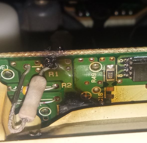

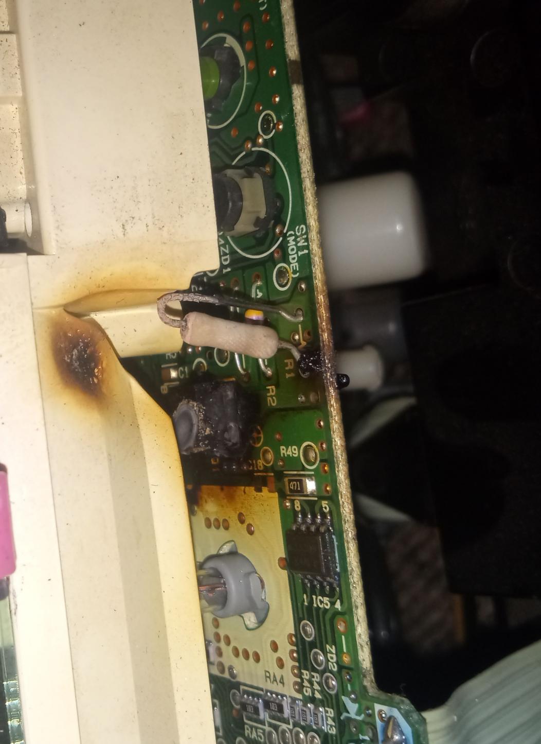

Not sure if you are still working this so many months later. I'll share a short story here. I found the same issue with the backlight bulbs not getting ANY juice to those twin holes with the copper pads. All of my other LEDs (a SuperBright kit) with the NEO3s worked fine once the polarity was found out.
I ended up running a hot and neutral jumper from the smaller bulb that lights the reset/mode to the twin backlight LCD bulbs. Here is where I may have gone wrong, though:
I assumed the contacts the twin bulbs touch were no longer part of any functional circuit on this board. I figured I had trashed some trace I couldn't see in my disassembly. I now have a really baked resister (R1 on the board) and noted how hot it had become one afternoon. I haven't traced the whole board (anyone have a schematic for this board from the 2003 SR5?) -- before I can put it back into service, I'll fully isolate the wiring of the twin LCD backlight LEDs -- feed them off of that reset/mode lamp.
I'm not sure what that resister does -- I suspect it did the voltage drop from 12VDC to 6VDC that may have fed the original LCD bulbs. If I have time this weekend to trace the board, I'll drop more info here.
I also have a baked resistor R1.
