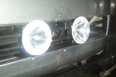

Hello all. its been a while but i am back and have finally got my fog lights on.
To start off they are Hella Optilux 2500 Angel Eyes, freaking awesome. I was not sure how some of you got the bolts through the bumper and after talking to 810moto and pondering a bit i figured it out. I used weedeater line and ran it through the hole to the ends. It is sturdy enough to be able to feed however you want. At the end on the line i made a loop and wrapped fishing line around it and then at the end i tied the bolt to it. Very easy this way. here is the ending result.

When I had mine in I did a similar thing. I got two small blocks of wood that were big enough to not go through the plastic bars on the lower grille. Then using extra long wood screws, I mounted the bracket to the wood through the gap. It worked perfectly and looked good, but I eventually got tired of having those lights after two years.
