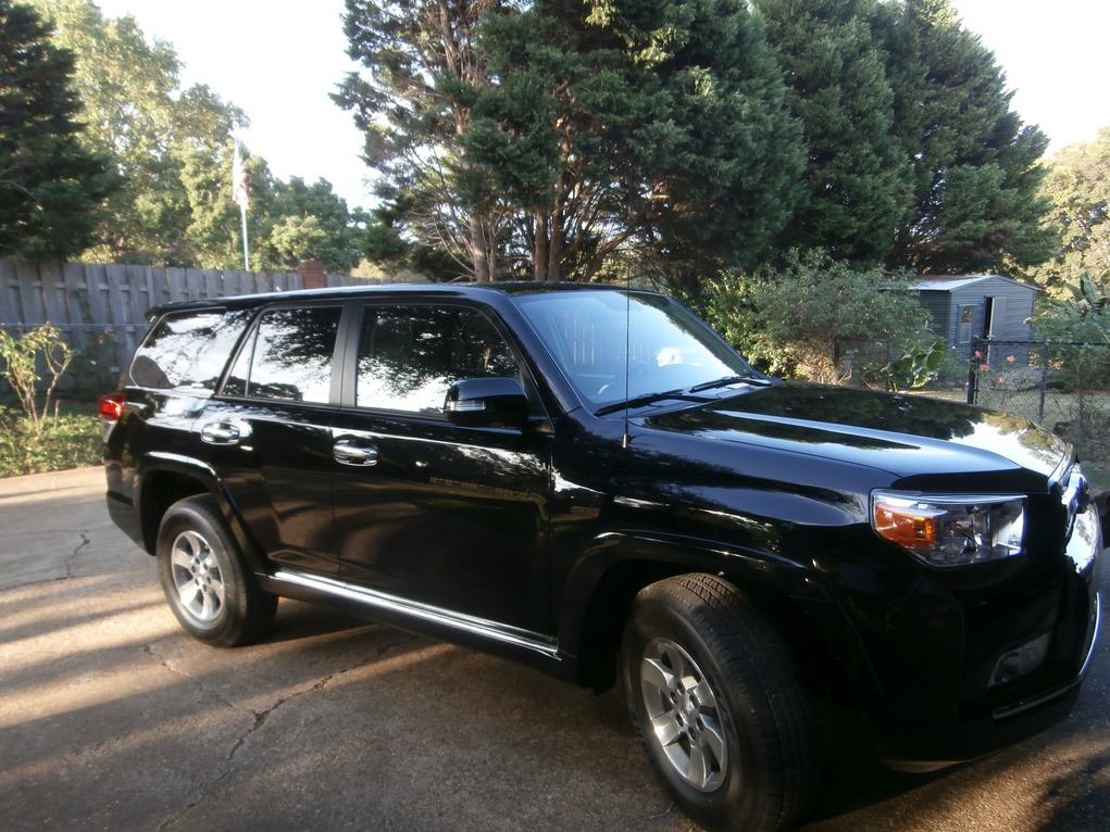

Thank you for the rack removal tutorial. I think this is much cleaner looking, and I don't have any use for the decorative rails that don't carry anything. If I decide to put stuff on the roof, a Gobi should do the trick.
I forgot to pay attention to one thing. Note, do not use the roof as a fulcrum to remove the plastic caps, you will put divots in the bodywork. Use the 3" and 7" method, and the screwdriver to push the tabs, and try to lift up to gently snap the cover out of place.

Sorry! Thats why I recommended using the rag between the screwdriver and the car to prevent denting/scratching. Maybe using something stronger would be the ticket. Glad it worked out! :D
The rag works great for protecting the finish, just cannot use the body as a fulcrum, and you don't need to...just get the screwdriver in at the places you measured and lift up. My local hail repair body guy will be able to pop out the divots!!!

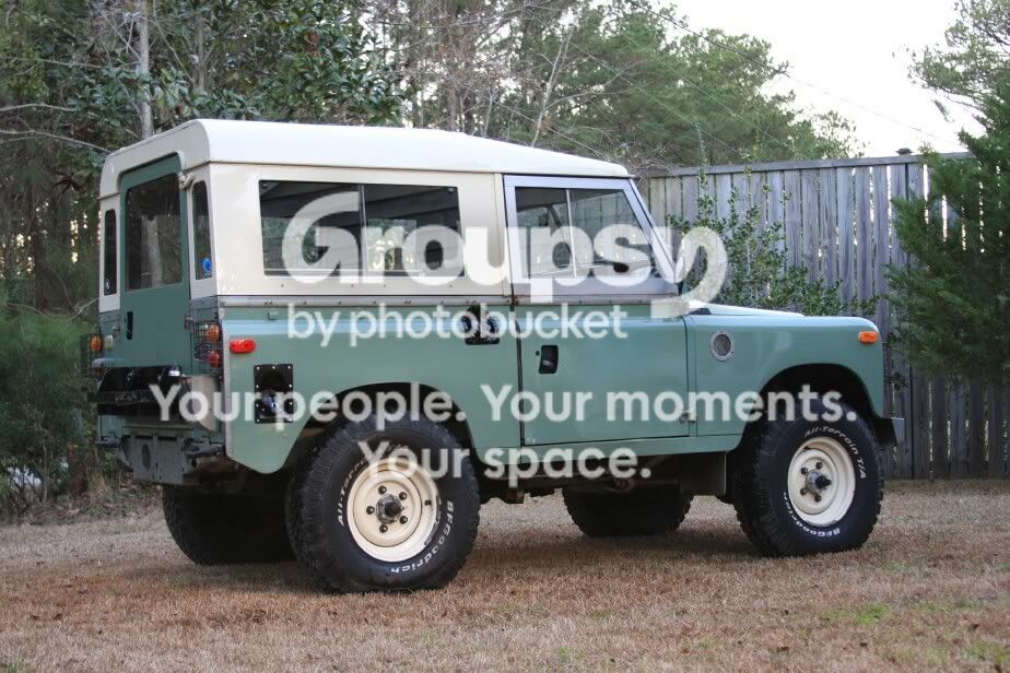

In front of the Rado is a 1971 Series IIa Land Rover w/ Defender 90 axles/coils, transmission and transfer case, military spec engine w/ headwork, etc etc. I'm a huge Rover fan.
IMG_0926.jpg~original
That Land Rover is cool beyond words! If you have a build thread anywhere on the interwebs, I would love to see it!
