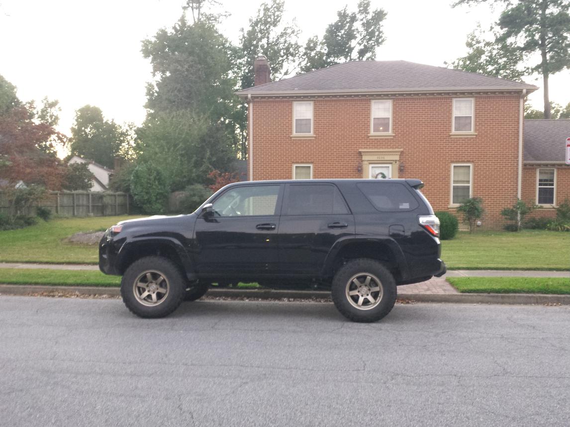

Did mine yesterday. It's better than it was but not sure if I like it. uploadfromtaptalk1445041326650.jpg

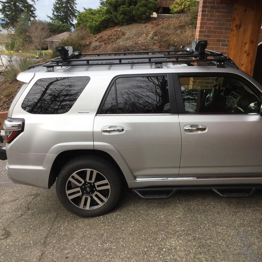

2. I actually want to put a canoe rack on my car and the stock rack is too short. Does anyone have any ideas? I thought maybe some kind of Yakima/Thule or other rack with 78 inch cross bars spread as far apart as possible.
Neither Yakima nor Thule makes anything that will clamp on to the 4 Runner so that you can spread your cross bars apart to carry a longer canoe/kayak properly. Their racks will only clamp onto your stock rack rails, with about 3 feet of cross bar spread. For this very reason, I put a Gobi rack on my 4 Runner. Gives me 6 feet of space between bars. Expensive solution, but I paddle nearly every day and take my boats on the highway in the winter.
