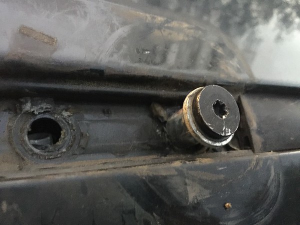

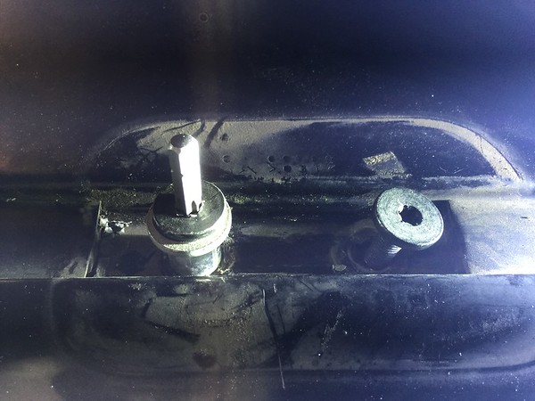

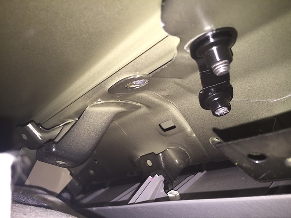

It took me 3 painful hours to remove the roof rack from my 2006 Sport V6 (tubular rack). This is what's under your roof:

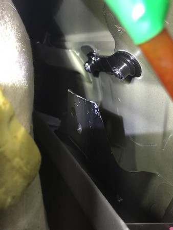

If you remove one of the bolts completely before starting the other one, here's what happens. The bracket breaks loose and moves freely, so you can't get the other bolt out.
Please learn from my mistake. Loosen the 2 bolts a little at a time, alternating and breaking the Thread Lock a little more each time.
If this has already happened, you can still recover without removing the headliner (like I did). See if you can get the other bolt back in, and tighten it back up again. Then you'll have the leverage to break the thread lock on the stuck bolt. Be careful not to puncture your headliner!
There are a few other differences with the Sport rack. They used star-headed security bolts (instead of hex-head), and they used a ton of thread lock compound. I had a hell of a time removing them, even with my 12" socket wrench.

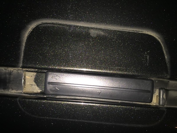

One last note: this is what the result looks like on my Sport V6. I need to buy some new and longer weatherstripping to fill the gaps.
