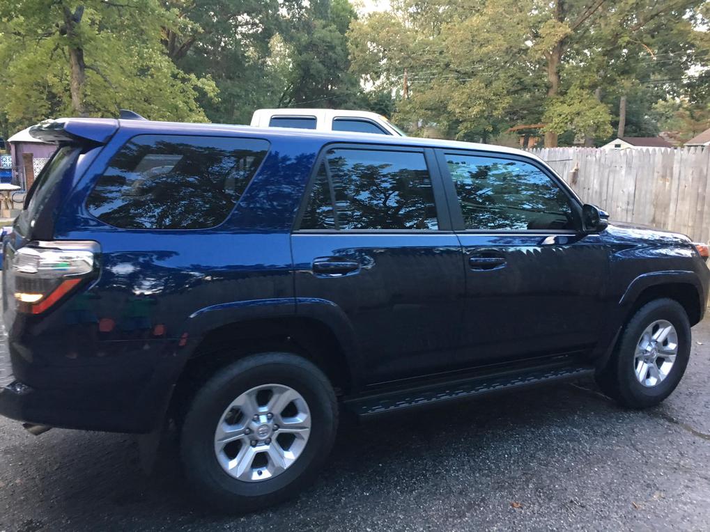

I did mine this weekend... I didnt realize these fancy caps existed so I will be ordering them and updating my bolts with the caps. :biggrin1:

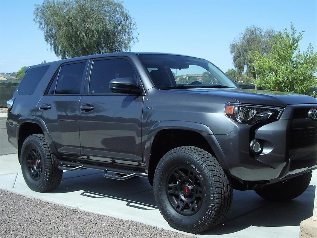

watch out while prying the covers off
Great write up, I ordered and installed the roof rack delete kit. I want to also warn about using a screwdriver even with a rag I managed to put a small dent in the upper roof area below the cover, I used a plastic dent tool to pry the covers off after seeing what I had done. Good thing I bought the paint/dent insurance, they will remove that dent I knobheadingly put on my vehicle. Reason I removed the rack, it's silver, nothing on my truck is silver, and I will never have a need to use it, and as others have mentioned, it's a pain to wash/wax the roof with that rack in the way.
