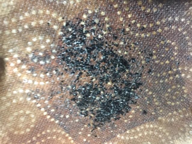

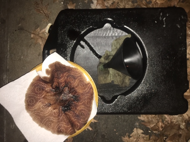

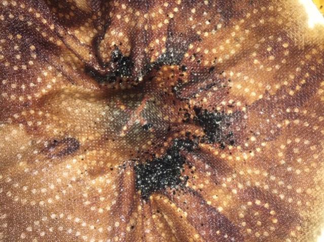

Also considering dropping the oil pan now. Probably should have done it right away. The amount of sludge in the engine was insane, I fear that oil pain might be all covered with the same stuff and I don't want any of it back in the engine.
The sump is easy enough to remove after the skid plate is removed. I've been flushing mine with clean oil through the dipstick tube after the oil drains, with the passenger front & rear tires on ramps to tilt the truck toward the drain plug.
With a paper towel across the drain pan, the pics below show what flushed out after the oil had already drained. Yuck.

[MENTION=172281]waypoint[/MENTION] that looks awful but glad to see it's coming out. Did you drop the pan already? I was looking for some instructions online but didn't find any. May be it's my chance to contribute to the club haha
I haven't removed the sump yet. I've been using a pump similar to this to push oil down the dipstick tube, with the passenger side tires on ramps as described above. Seems to do a good job of washing sludge out of the pan.

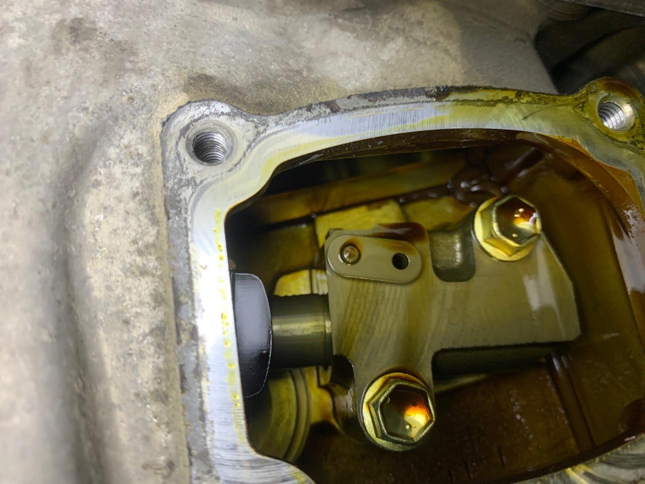

Finally did the water pump at 234,000 and pulled the cover to inspect the tensioner. All looks good so no more timing chain anxiety for me!
