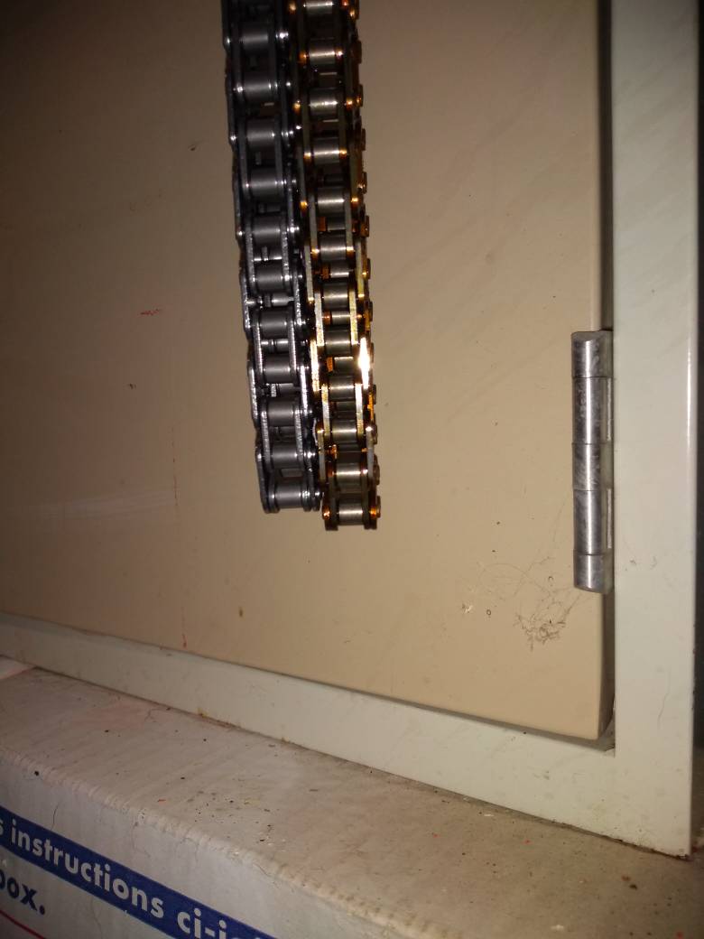

I'm hoping the Toyota chain I bought under the superseding part number holds up as well as other Toyota chains. It had different manufacturer markings on the endplates than the factory chain, hopefully a good indicator of correct quality.

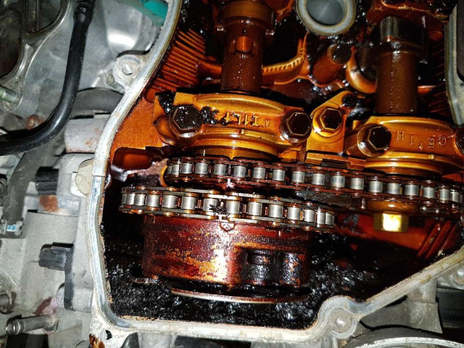

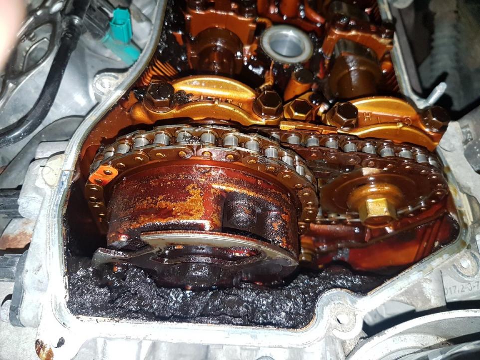

Your previous posts have already helped me a lot, it's was one of the first steps of the diagnostic stage to remove the cover to inspect the tensioner which was indeed over extended with a bunch of oil sludge there. Previous owner did a $hitty job with oil changes.

So I can understand the chain wearing prematurely based on bad maintenance, but I've seen pics of '05 engines with much more sludge accumulation during head gasket projects and the #1 chain tensioner was right on the money...no significant chain elongation. Something must have changed on the 2007 and early 2008 chains.

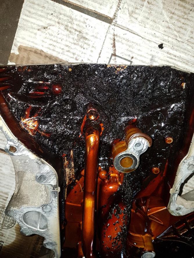

So I am just going to leave those pictures here as a reminder for people to change their oil on time, unlike the previous owner did.
I ended up replacing the the water pump, thermostat, full chain kit (tensioners, sprouts etc), radiator was leaking, AC compressor was broken, pulley were whistling and the belt was worn. Epic job, hopefully it's the last time I am going inside of this engine.

That chain definitely can't be blamed on a manufacturing defect...major sludge.

I'm considering dropping the oil pan sump on mine this Summer, still flushing sludge "coffee grounds" out of mine every oil change. Should have done this while I had the thing out of service for the chain project.

Also considering dropping the oil pan now. Probably should have done it right away. The amount of sludge in the engine was insane, I fear that oil pain might be all covered with the same stuff and I don't want any of it back in the engine.
