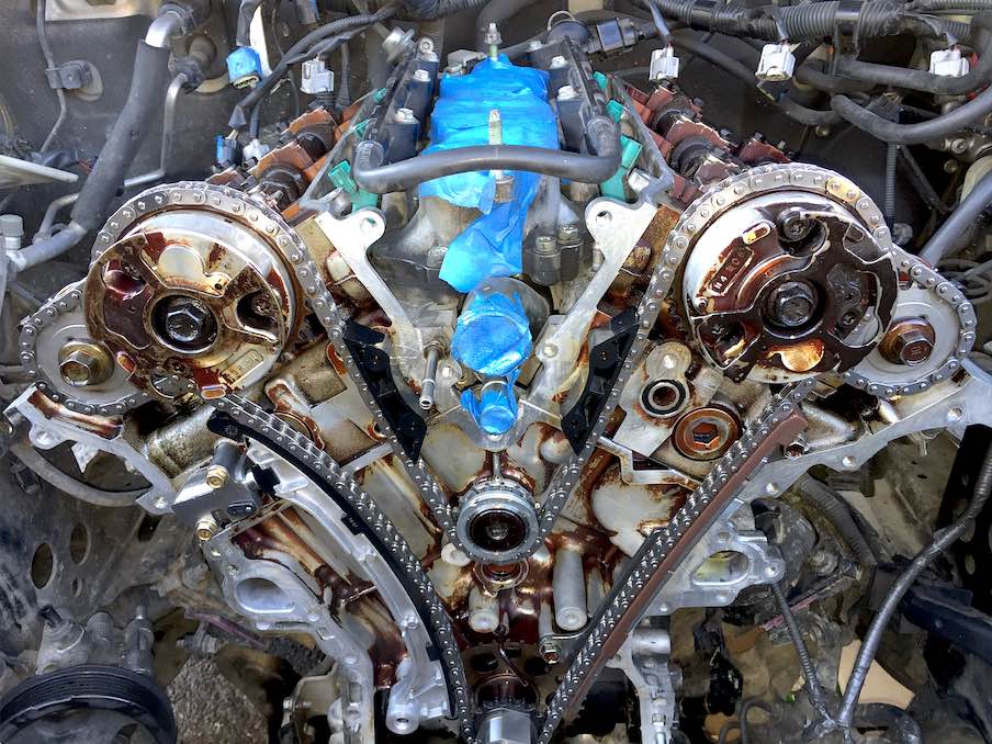

Success, she runs! My boyfriend and I finally got around to replacing our timing chain. We bought a kit from Mizumo Auto on eBay with guides, sprockets, tensioners, and the three chains. I have a rapport with a local autoparts store, so we decided to perform the repair there. Best decision ever! Every day we needed some new tool or part or even just AAA batteries to move forward with the job, so it was great being right there at the store. We were near fast food venues too, which came in handy. We commuted by bus every day after work and eventually enlisted a friend to drive us to and from the 4runner.
This job took two weeks. The labor added up to 76 hours, and there were two of us. xD There’s a reason mechanics charge so much for this repair. HOWEVER, the thing is, we DID pay a mechanic to fix this (three times, technically, two different mechanics), and it didn’t fix the problem! And all three times they kept our money! The problem is, this job is quite complex, and, as some of you have pointed out in this forum, 2007 4Runners apparently had a bad batch of chains, so paying people to do this job and even to swap the engine out for a different used 2007 engine (couldn’t afford refurbished) didn’t do any good. Long sad story. We promised ourselves that if the third attempt at trusting a mechanic with our life savings didn’t work, we’d try it ourselves! And even though it took us 76 hours, because we went carefully and did everything to spec, the repair worked! And we got to learn so much about our car along the way. :) It was kind of fun!

14. Top dead center: We took the spark plugs out to not have to fight compression. Then, with the crankshaft pulley bolt back in, we cranked the engine a million times, watching all the dots and marks and valves to get a feel for it. Then we put a garden flag in the #1 cylinder so we could just watch it go up and down. xD The silver cam lobes point at each other when the cylinder is up. There’s also a spring function that throws you forward or backward if you nudge off of that perfect spot. I don’t fully understand this, but that’s what we felt.
15. We figured out that our timing marks are all good, so we were able to rely on them. :) That made lining up the new chain okay. It was still tricky, and we studied the diagram and counted links to make sure we had the colored links in the right places. Then we placed the color links onto the dotted sprocket teeth. Tensioners weren’t on yet, and idler sprocket was off. This gave us wiggle room. Having two sets of hands was AWESOME and made this task much easier than it would have been for one person. It still took us two tries though, because the first time we did it we were one tooth off on the crank sprocket (the hardest to see), so on turning the engine a few times to test our work, we saw our timing was off again. So we compressed the tensioners and put their pins in and lined up the links again, takin special care to line up the colored link on the crank sprocket’s dotted tooth. On turning the engine over again, several times, everything stayed lined up! Note that the colored links will move, but the sprocket dots and phaser marks and all that will all line up, and that’s what matters. :)

This job is not for the faint of heart. But, with some time on evenings and weekends, careful attention to the manual, a helper if you have one, and a hefty budget for all the unexpected tools, bolts, and other supplies you’ll need, you can pull this off and get it done right! :) Turning that key, passing the emissions test, and sticking that legal registration sticker on to drive another day felt sooooooooo so good. :) And now we have the pleasure of bragging to all our friends and family about our mechanical prowess and can maybe teach them a thing or two. :) All in all, since we were able to get around via bicycle, public transit, and friends for the two weeks it took to finish the job, this was totally worth the time and effort!
PIC: New chains and sprockets on somewhat-cleaned engine, hooray! :D
