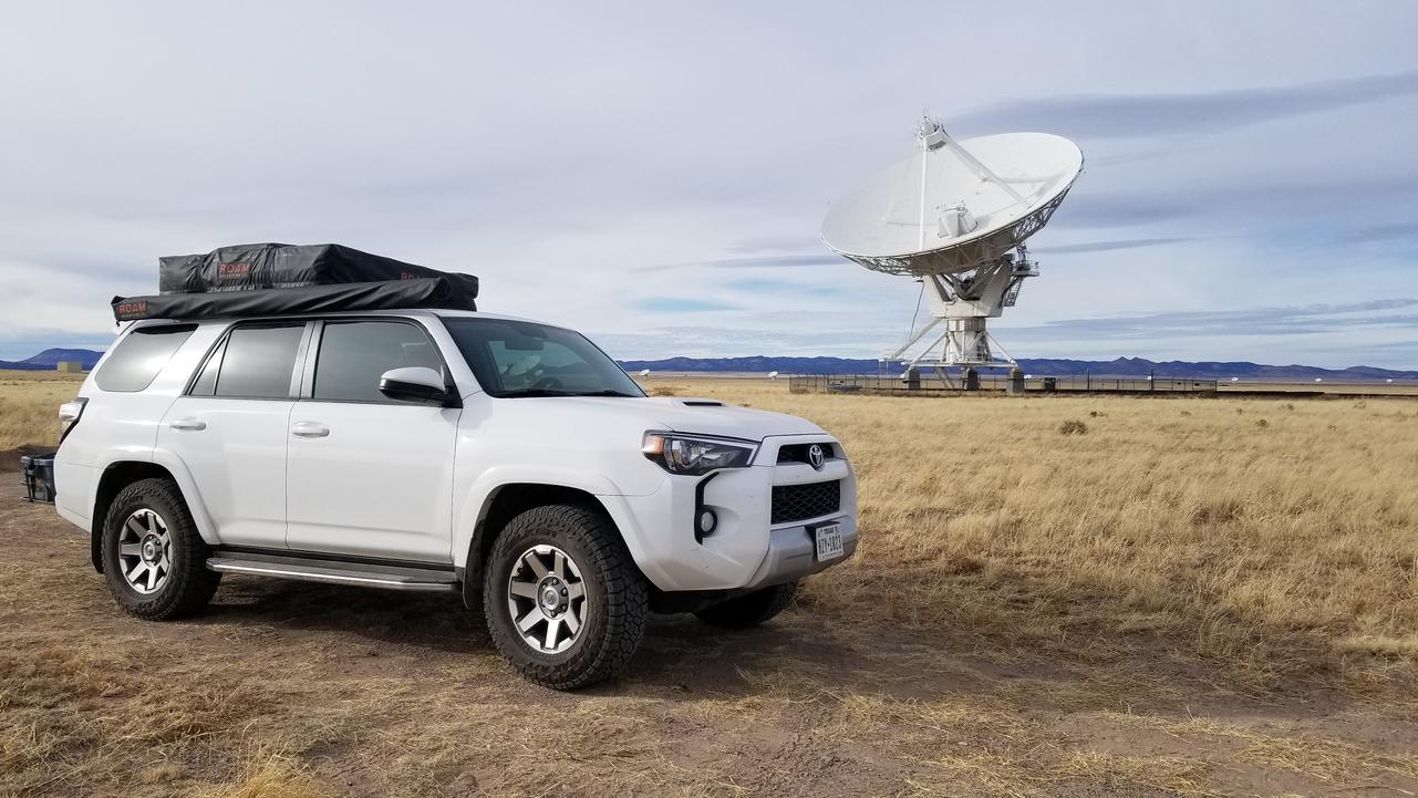

Rocking home built rails for factory bases. No big deal. Not exactly the rocket science that you're making it out to be. Disassemble a folding RTT and you will find that the whole tent is secured to the aluminum extrusions by 4 - #10 screws! Simply weld some end plates onto some 1 x 2 x 16ga steel tubing, couple extensions to mount the awning, viola.
Only suckers spend $1500 on a rack only to cover it completely with a tent.

Nobody said it was rocket science. Totally agree the prices for roof racks are absurd.
Your solution is certainly interesting. Glad to hear it has worked for you.
While I suppose it could, my solution has nothing to do with a RTT. I need a location to place storage boxes and gear for trips. The tracks in the extrusion will help with securing gear cleanly.
