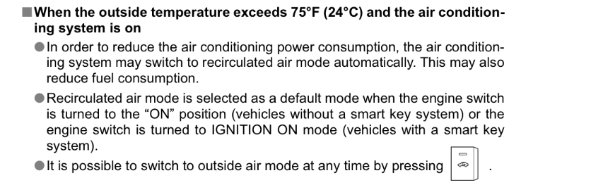

From page 286 of OM

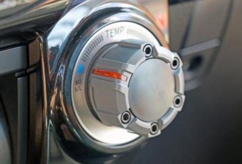

If the temperature knob is all the way to "Max A/C," it will default and stay in recirculate. One click clock-wise (so it's on the blue mark), you should be able to toggle recirculate on and off. It should stay in the mode you last left it in, as long as you don't put it back to "Max A/C".
The attached picture (taken from AJT) shows the knob one-click clockwise.

From page 286 of OM
This doesn't make sense to me. I see no reason why recirculate uses more power than when it's off. In fact, it seems the blower is working harder when it's recirculating.
This entire summer mine is usually set the way you posted on the max cold, but one click before Max A/C and it defaults to recirculate on every time I turn it on. Having said that, I usually turn off all electronics before I shut off the car and maybe the fact I turn them on after starting the car is causing it to default back to recirc on?
I didn't know about the temp thing and will keep my eye on it as the days cool off. That explains why I don't recall dealing with this before the last couple months.
