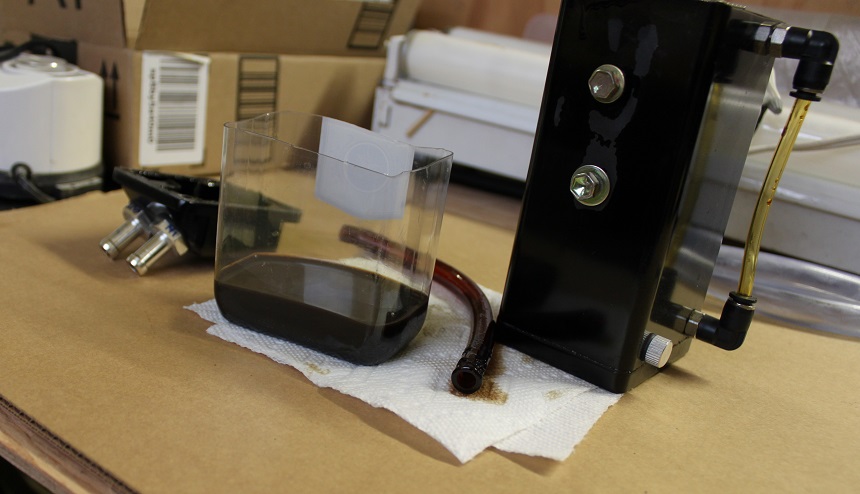

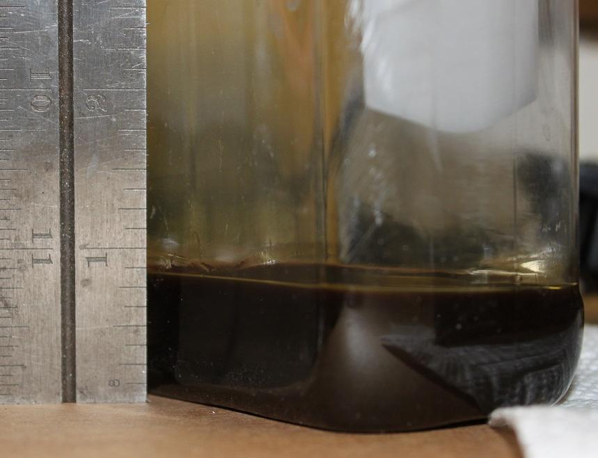

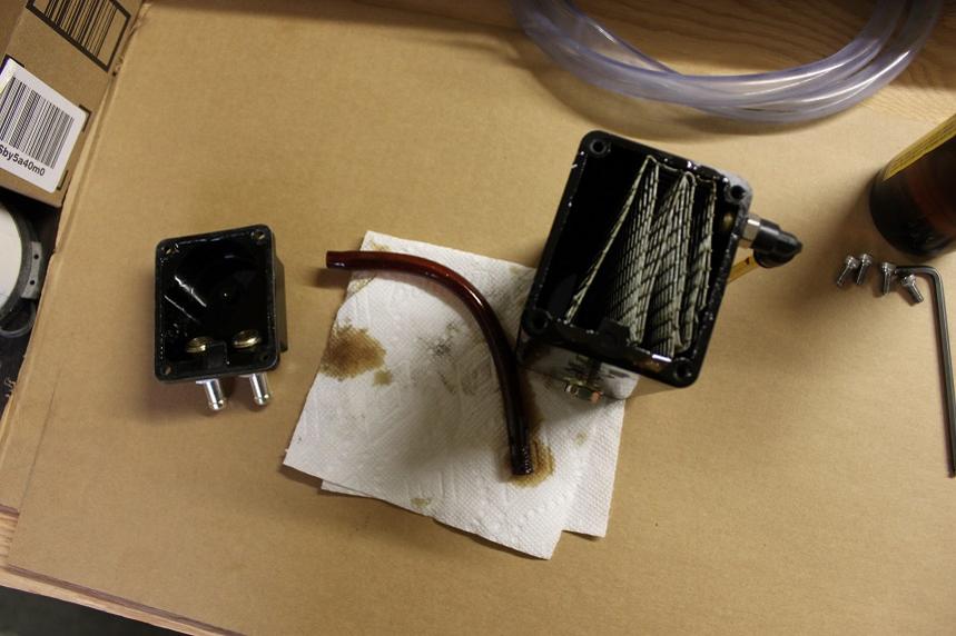

One place some of the oils goes is from the PCV valve to the air intake manifold.
I just added this oil catch can last year. 10 months.
I added metal mesh screen (to grab more dirty vapor) and the down tube (turning black, was clear).
If I did it again I would get a can that the bottom dosent come off nor have that inspection tube, just looks like possible failure/leaking areas.
