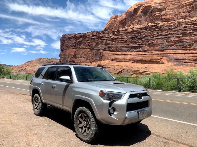

I've had them on for 3 years close to 40k...19 3/4 both sides stock springs - 21 3/4 both sides w/Dobinson 238. Measured today and both still holding 21 1/2 - 21 3/4.
I've been debating going to 285, I think they will fit but don't really want to take the chance of a rub. Think I will stick with stock LTs for another couple of years.
Pic is me and fam in Moab last summer

This is perfect. Thank you for posting this. I think you're the first person I've found in my extensive search for someone with 238 coils front, and 599 coils rear. Have any more pics with this setup? Great looking tire size too! What size are they? (you should probably add details in your signature so people like me don't keep annoying you! :)

I've looked at your rig on here before and like the results! I am curious though. Your numbers for the front are showing that you got about 2" lift in the front. Is that right? From 19 3/4" to 21 3/4"? I'm curious your measurements for the empty rear also.
I have a 21 TRD ORP and currently stock is measuring at 20" front and 22" rear. Looking to keep the factory rake and looking to get a low lift of 1-1.25 on both ends.
Also, looks like you got the 701 rear shocks which are the slightly stiffer ones correct? If stiffer is it too bouncy unloaded? Any insights would be greatly appreciated as this is the set up I am most likely going with. Best...
Yes, it is definitely closer to 2"in the front. Rear is at 23 1/4 - 23 1/2.
I don't consider the ride bouncy at all. It's just nice and firm in my opinion. It tows well too, I rent requirement from time to time (nothing too big) and towed a 95 4runner a couple hundred miles (this may have been pushing it).
