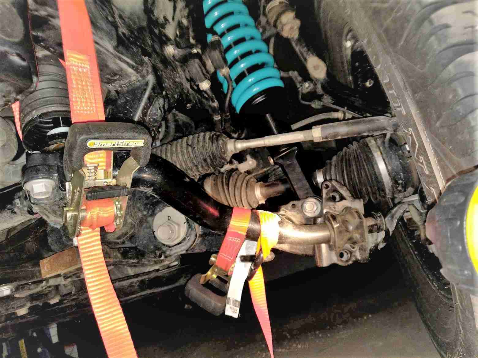

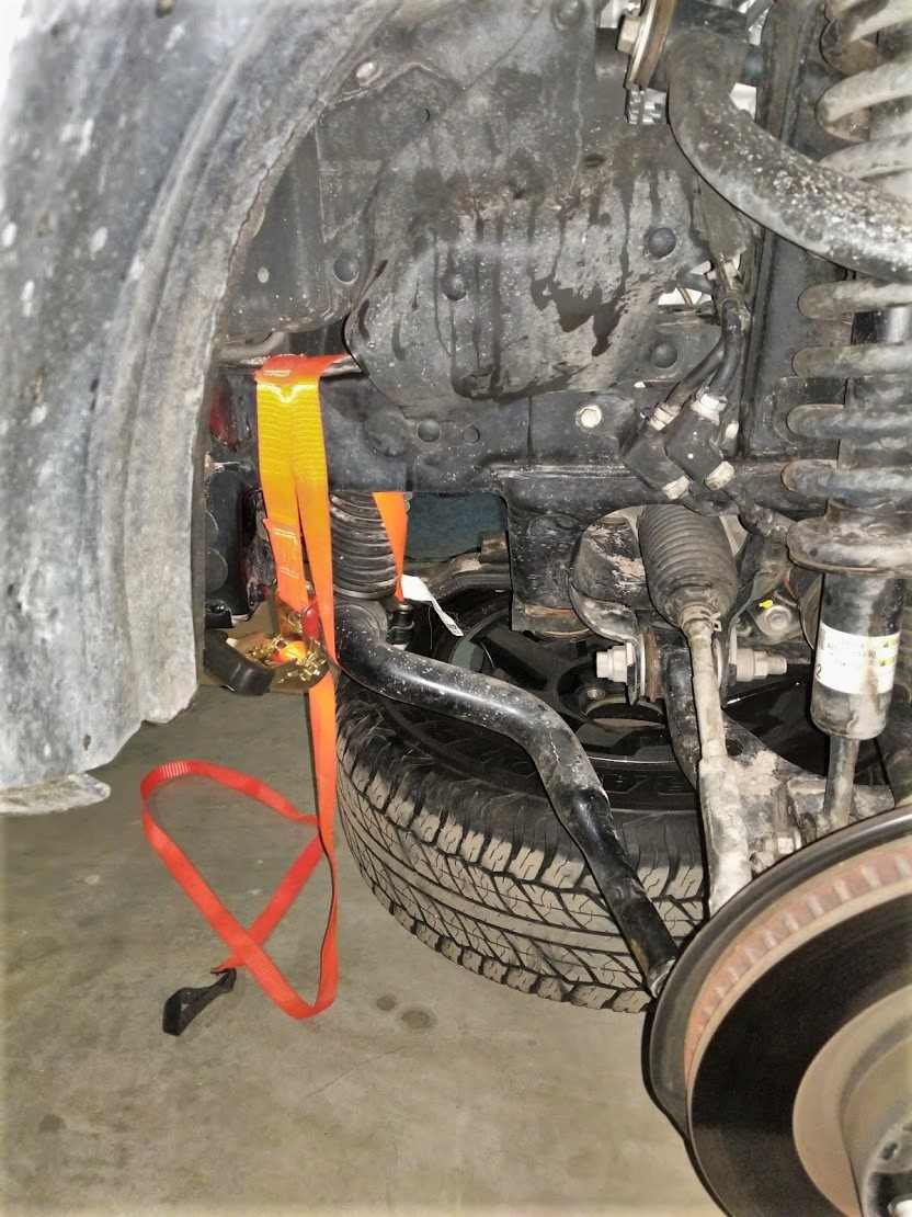

I used ratchet straps to pull the KDSS bar up and back into the LCA. For the rear that lined up quite easily with the floor jack - I believe I reconnected that one after the truck was back on the ground!
Image 1 is a side profile of the drivers side front. It shows how I "pulled" the KDSS piston into the frame.
Image 2 isn't great, but you can see I then used a second strap to "pull" the swaybar into the LCA - the bolt holes are visible and fully lined up

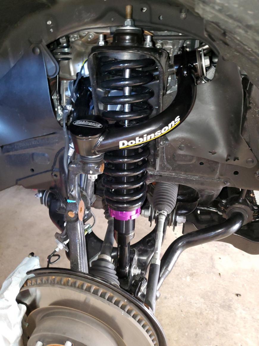

[MENTION=148378]Crikeymike[/MENTION] just ordered a kit for the wife runner as well as sliders and new UCA's. Thanks for breaking it all down in your posts and the website made it super easy to choose the right kit for our uses. Now to wait and then the install right before xmas haha. Cheers and cant wait!
Done and turned out great.
