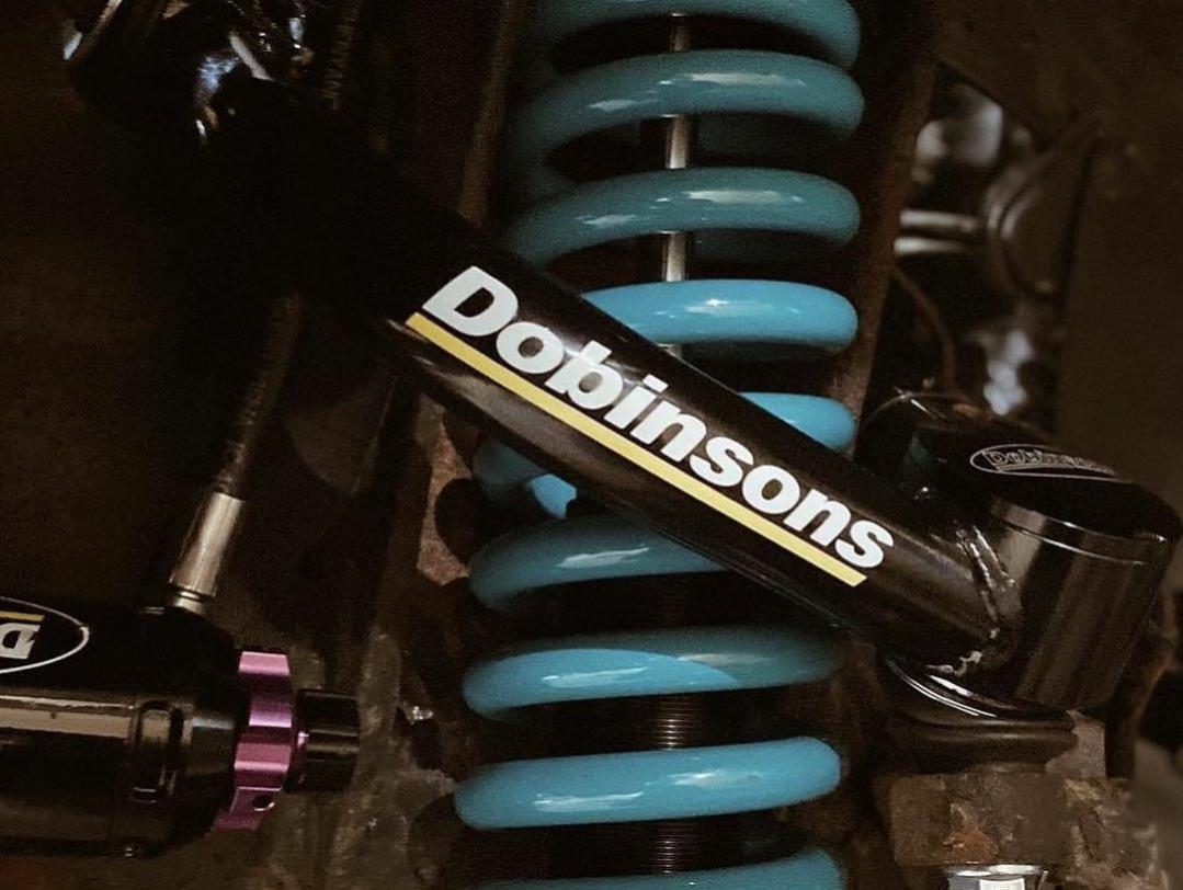

I'm digging the purple collars TBH. I have the teal coils and think it would've been a fun retro color scheme going!
Looks great!
I’m considering going to these sometime next year and would totally dig the purple collar to go with the teal springs.
Looks great!
Thanks. Personally, I was disappointed when I opened the box and saw purple instead of black but figured you can’t really see them anyway.
[MENTION=148378]Crikeymike[/MENTION] Maybe make the purple an option?!
If anyone got the purple collars, that means those were air freighted over from Australia because the regular black ones must have been sold out. At a cost of about $5 per LB, your 20LBS of IMS are now worth an additional $100!!!
All IMS and MRA made for the USA have black collars, but with the way this year has been, with things running out of stock and massive shipping delays, some parts have needed to be air freighted.
So to answer it, no, the purple is not an option. The adjusters are spun on at the factory to make sure all the threads are in great shape prior to shipping.

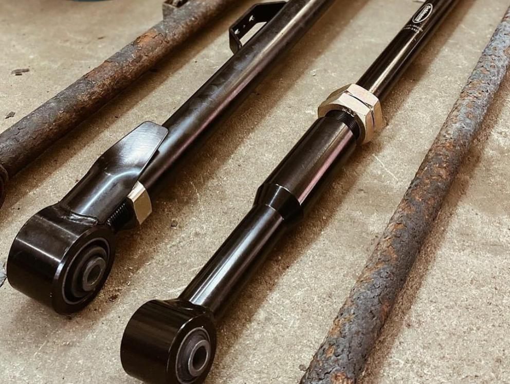

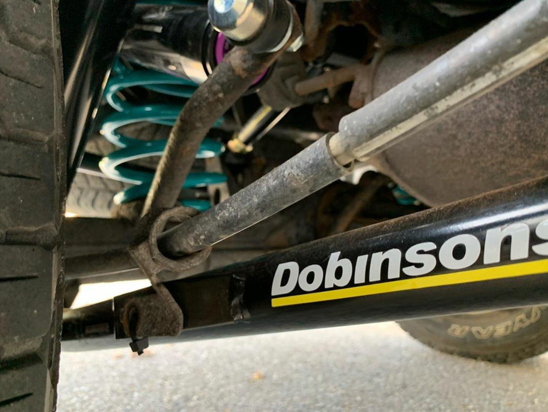

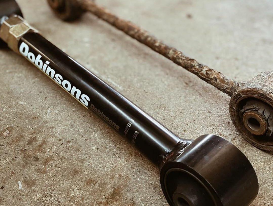

A few bits and pieces got upgraded on this 4Runner recently.
Check out the difference in the last photo, Dobinsons rear upper trailing arms vs. stock.
I'm going through all of the bolts that I touched for the install and verifying torque. What is the torque spec for the castle nut on the Dobinsons UCA?
Edit: I'll assume it's the same as the stock one (82 ft/lb)
