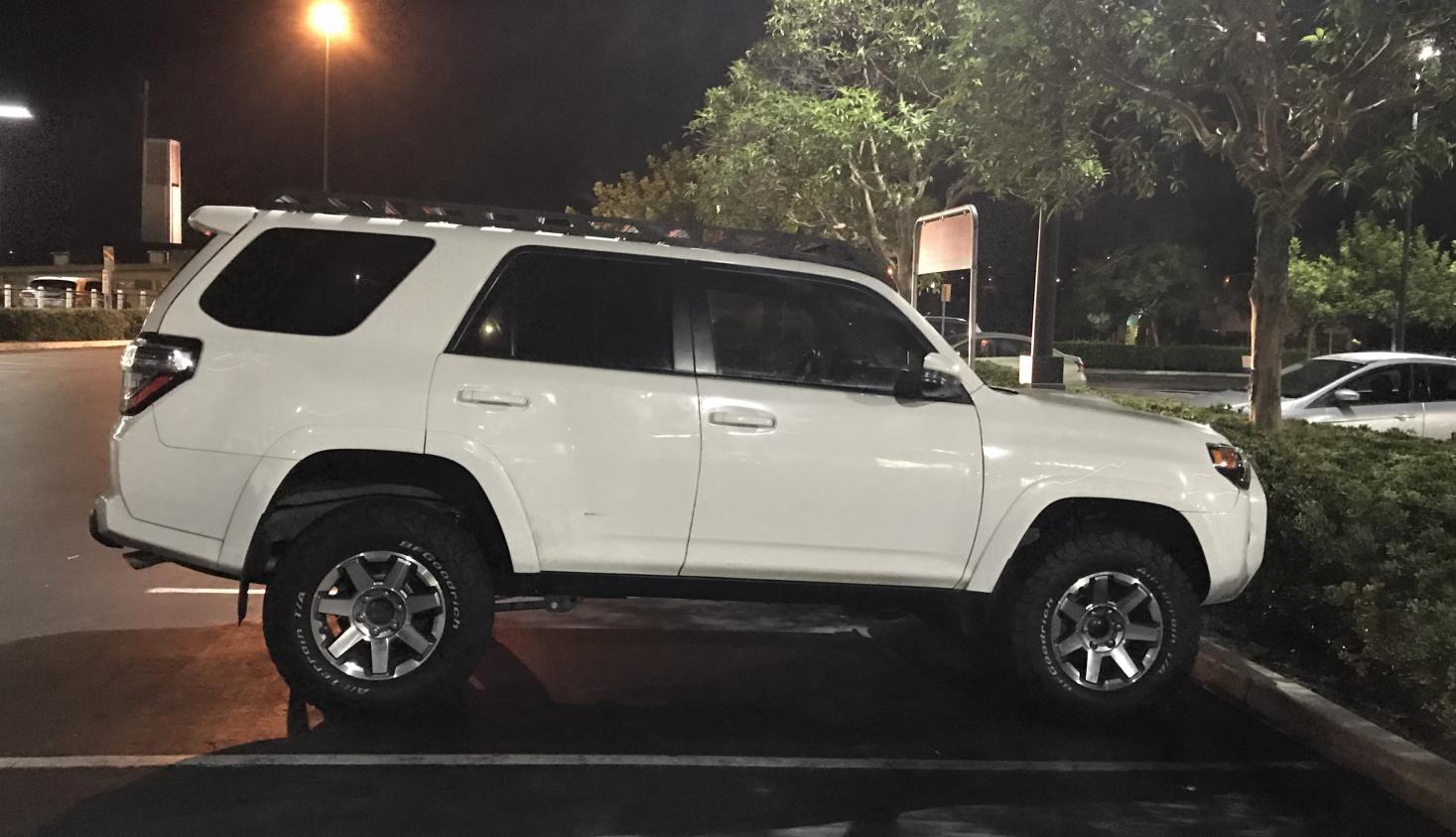

I have almost the exact setup though yours looks way high in the rear. Mine is just an inch higher on the pass side. (Pics are a page or two back, Dobs cont arms and no bags) I’ll be pulling the spacer next weekend. Rear arms too if they arrive by then. I’ll post what happens.

Thanks. Taking the rear spacer out helped but the rear is still at 2” lift and the front is still under 2”
Here’s how she sits now but it’s not perfectly level
