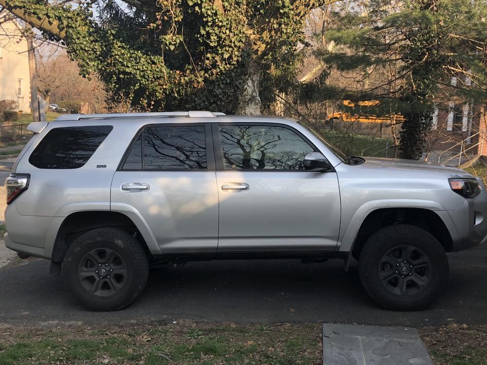

This looks like a perfect, simple lift. Could you take some more photos on flat ground from different angles, and directly from the side?
Also, how did your alignment numbers come out with stock UCAs? How does it steer at highway speed?

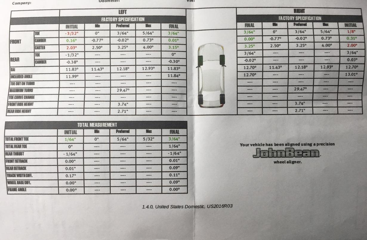

Sorry, forgot to post the alignment numbers. I'm not familiar with these so maybe someone can tell me if they're good.. the truck rides nice though! So I'm assuming they aren't too bad lol.

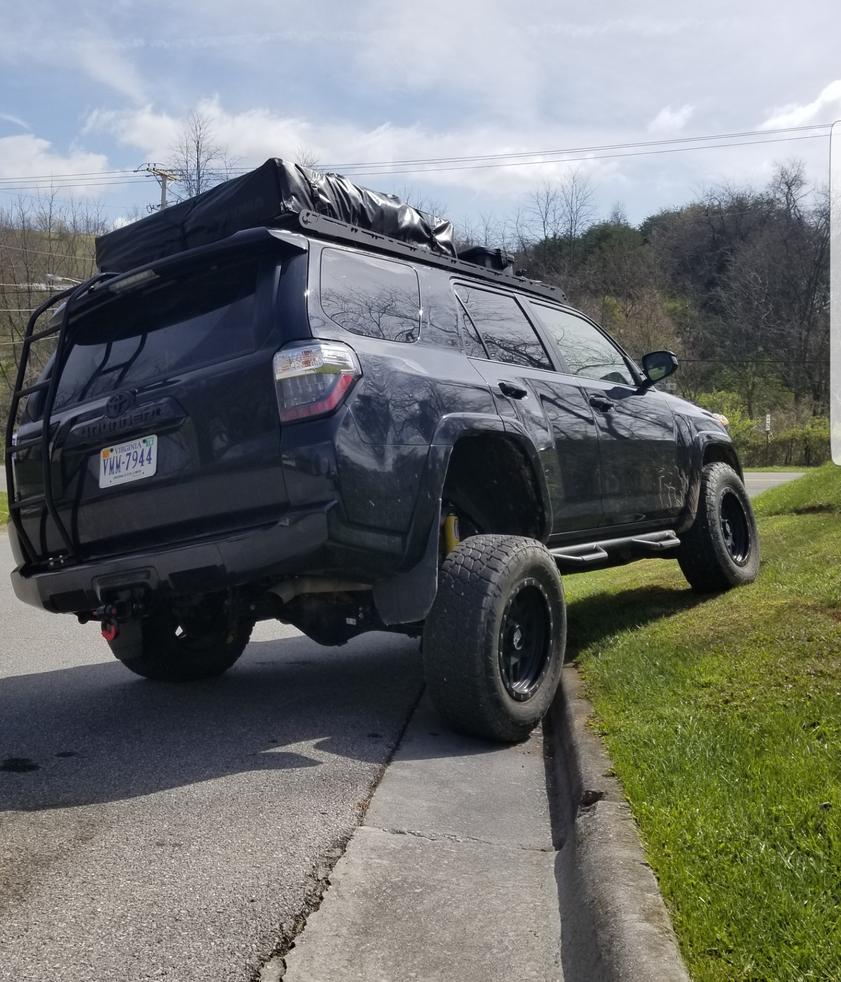

Nice flex. 3 inch front and rear with sway bar links.

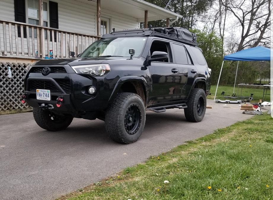

Are you running the C59-675V? If so, do you have hub to fender measurements and maybe a good side shot? Thanks
Yes thats the 1s im running this is the ony pic i got on level ground.

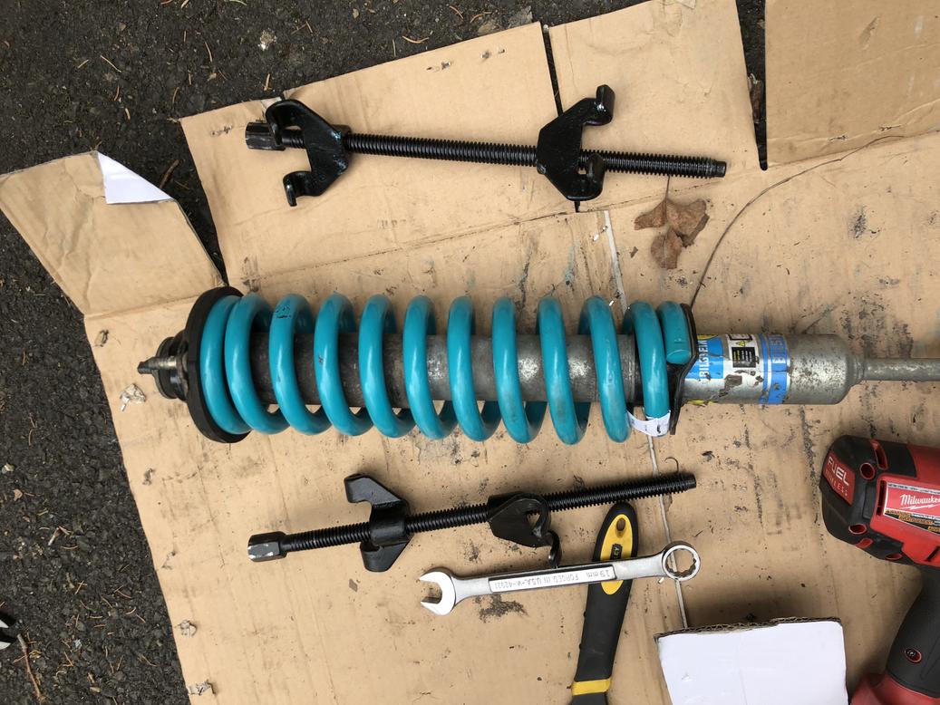

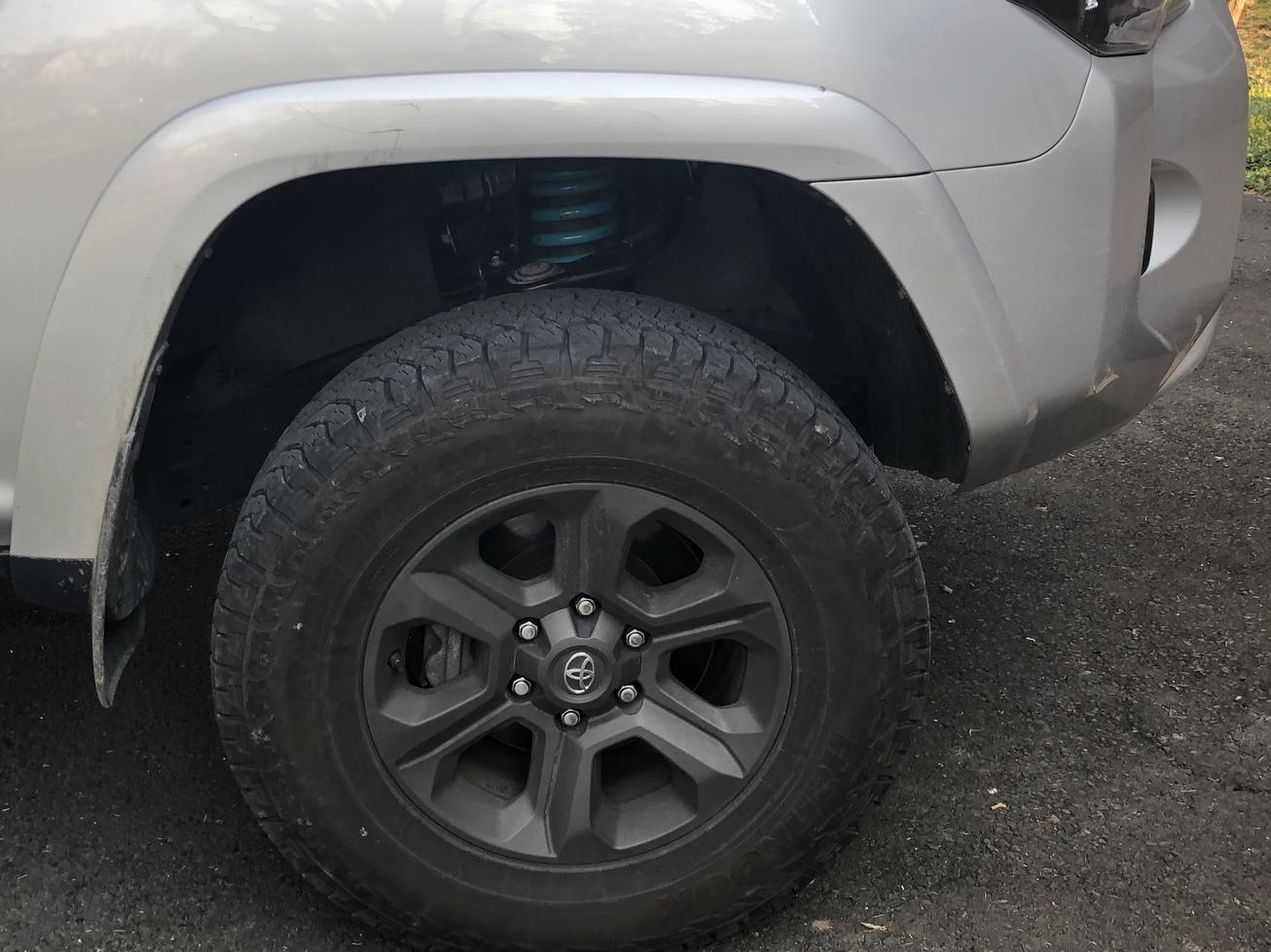

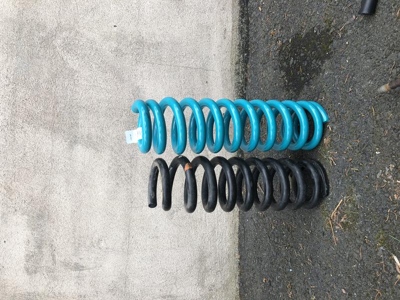

Finally got around to installing my springs I’ve had since November!
Thanks Mike!!!
