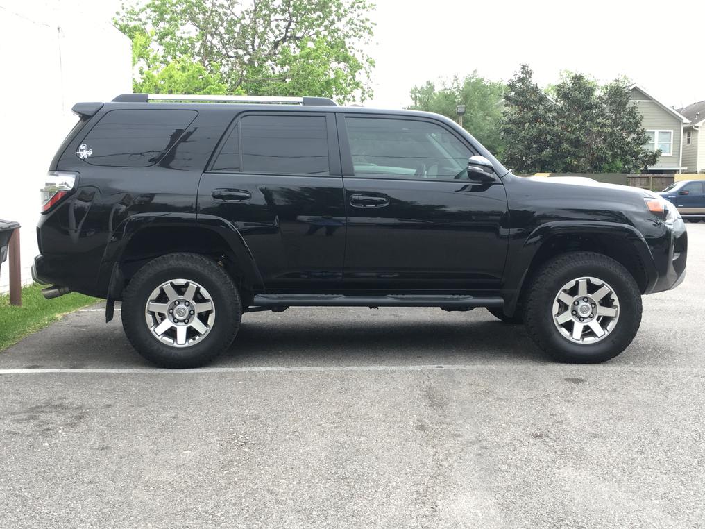

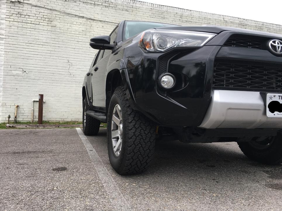

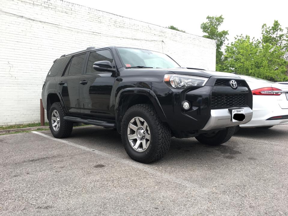

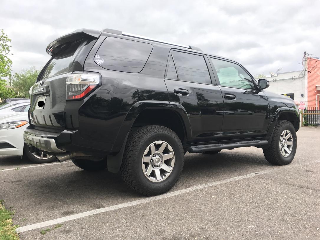

Here you go. The angle shots aren't really the best, but I hope the side shot at least helps.
So I've put a few hundred miles on it and it rides great on the highway, but around town on those bumpy roads it feels a bit less stable than the factory setup. I suspect this is more due to the bilsteins being so stiff. Hopefully they continue to break in and the rear settles more, it still is sitting quite a bit higher than the 1" lift.
