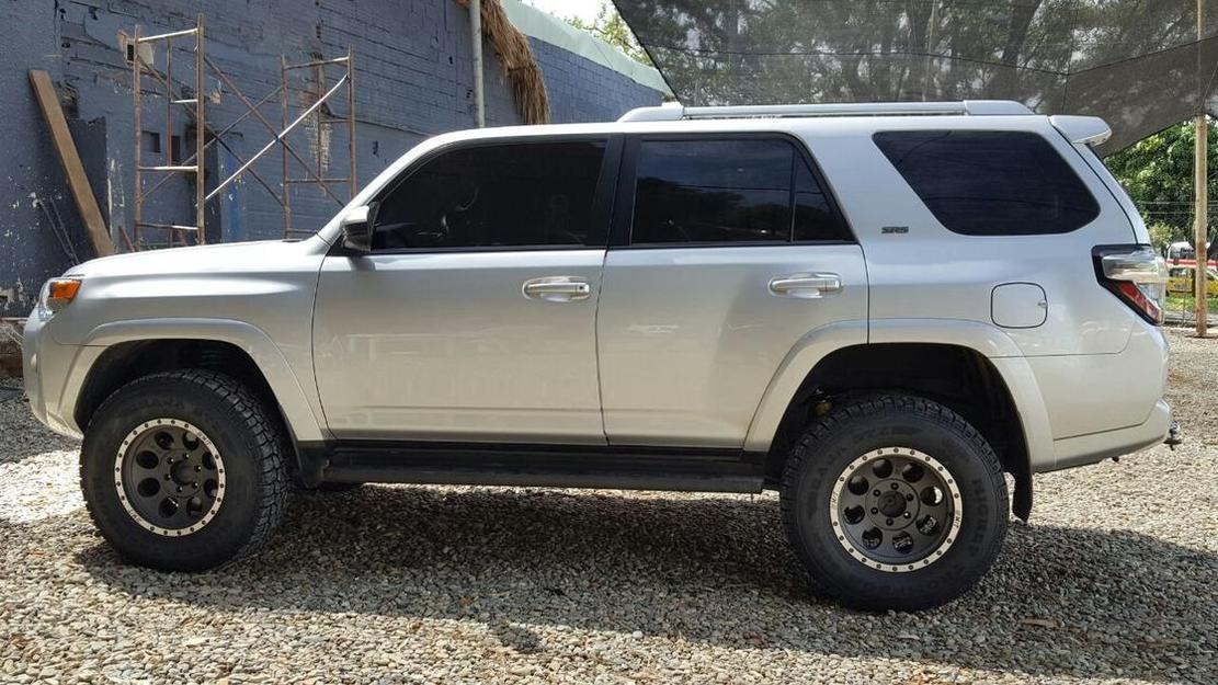

Hey Zach, it really depends on extra weight you have on the truck. 3rd row seat or anything else?
Photo here of those parts installed, all stock weight.
Ty, all stock. But after more research and soul searching I think I’m going to go with the 505/302 setup on springs, I see a possible C4 Lopro in my future. No inventory till 5/18. Is that right?
