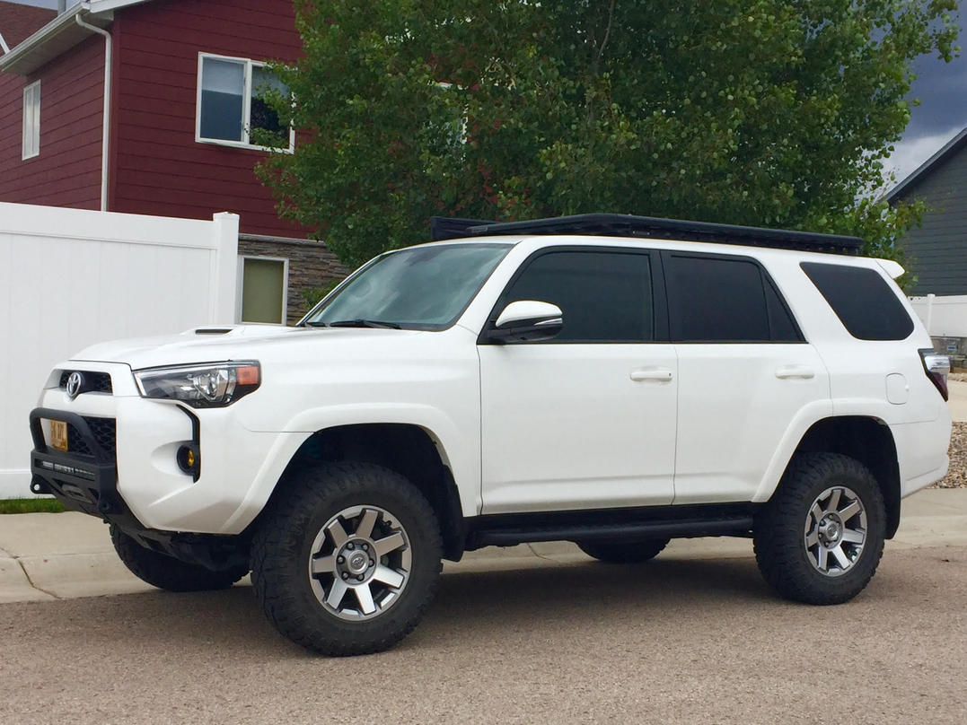

Thought I would take a moment and post this up...I haven't updated anything here in a while. I finally got around to installing my Dobinsons Suspension on my 2016 TEP w/KDSS over Memorial Day weekend. I have since installed a new roof rack and C4 Fab Lo-Pro Bumper (no winch currently).
For those that are interested, I went with C59-302/GS59-700 Front. C59-725/GS59-701 Rear. Still running 265/70/17 Duratracs. Install went well, ride has been comfortable. Happy to answer an questions you may have. Have a happy and safe 4th!

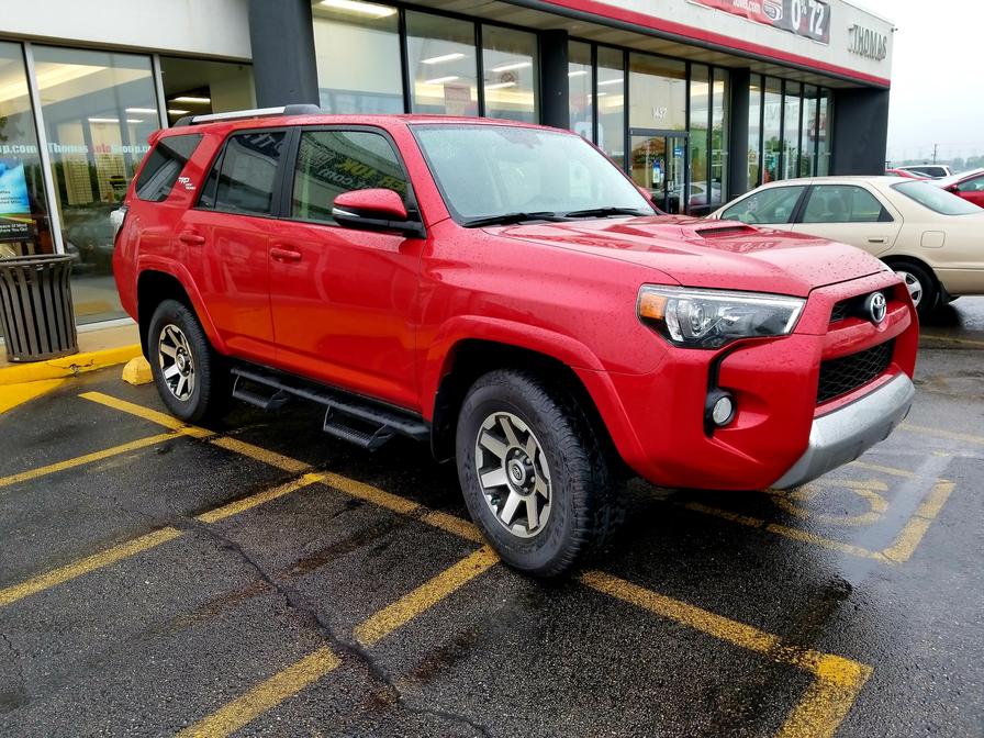

So I put on 300 miles with 2 off road trips and it seems that the back isn't settling. The suspension rides amazing on and off road. Looks like the front settled more and the back went up (I kept the old suspension the back, ~120lbs after install, that measurement was 39 inches from ground to fender)
I'm not super happy with the set up as my rake increased to 3 inches. For reference, I'd now go with the 505s in the back to level it out. My front def went up to 2.75 - 3 inches, but the back went up farther with 325s. It doesn't look terrible, but could be better.
The back springs aren't notched, they're about 1 inch away from the stopper, I'm getting that fixed and remeasure, but I don't see losing more then 1 inch from the back. I'm also keeping my fingers crossed that back springs have some more room to settle.
The set up
Front:
C59-302 / GS59-700 (2.5 inch) (with .25 toytec spacer on top of the coilovers, should add .5 inch lift)
Back:
C59-325 / GS59-705 (2.25 inch) (with 10mm OME spacer passenger side to offset KDSS)
Measurements from the ground to fender:
Front: 37"
Back: 40"

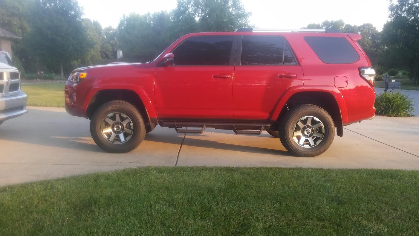

Before
After
2018 TRD ORP Non KDSS
OEM Height Measurements From Ground to Bottom of Fender:
LF 34 3/4"
RF 35"
LR 37 1/8"
RR 37 1/4"
Height Measurements From Ground to Bottom of Fender After Lift and OE 265/70/17 Tires w/:
Bilstein 5100's set at 0
Dobinson springs
C59-302 Front
C59-505 Rear
LF 37 1/4"
RF 37 3/4"
LR 39"
RR 39 1/4"

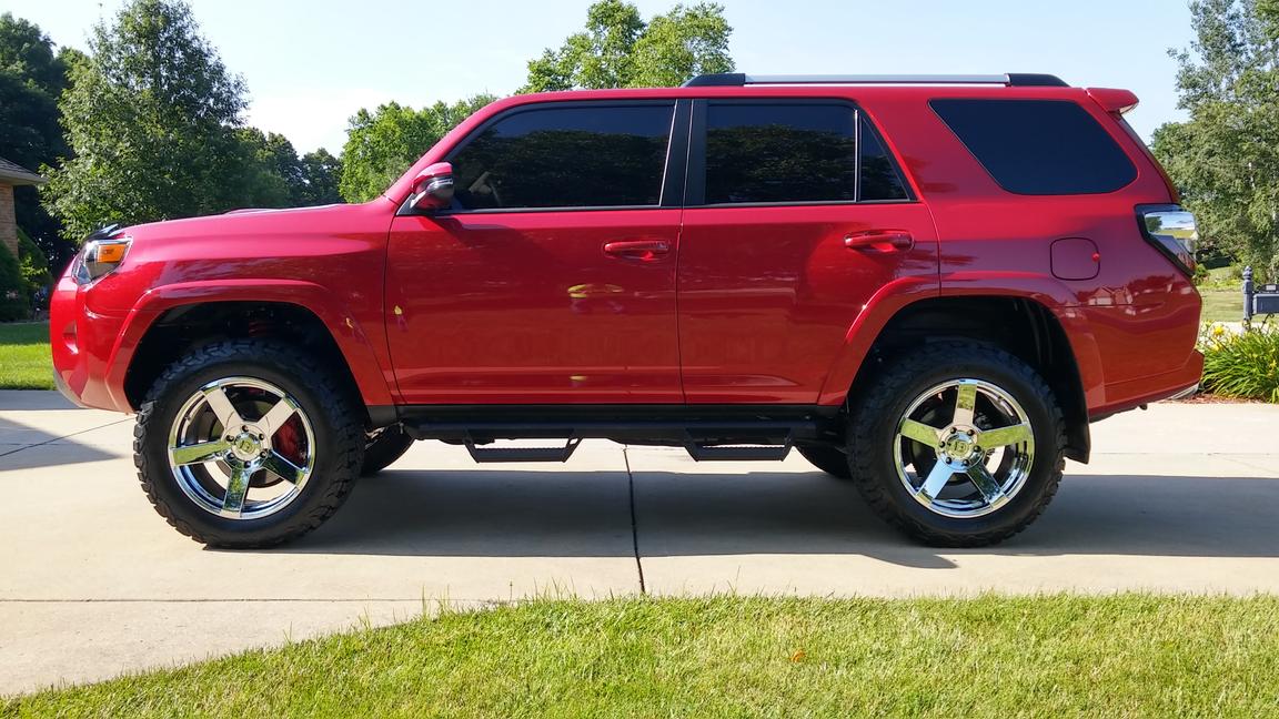

Height Measurements After Lift and 20" Wheel and 275/60/20 Tire Combo From Ground to Bottom of Fender:
LF 37 7/8"
RF 38 1/8"
LR 39 3/4"
RR 40 1/4"

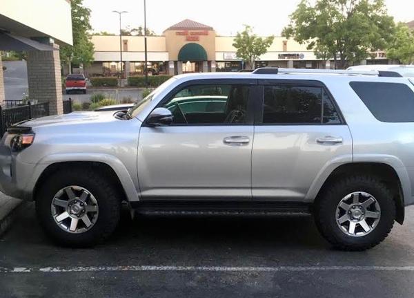

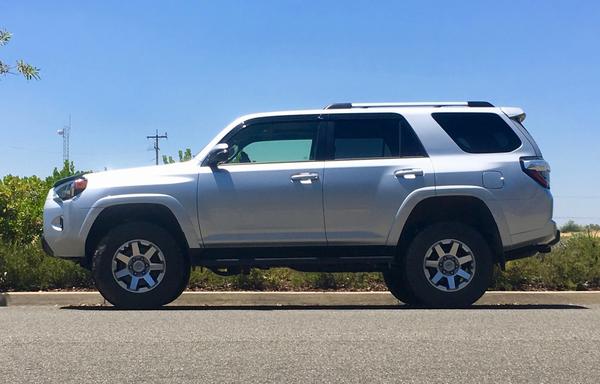

For reference I installed the FJ TRD Pro kit + daystar 1.25" perch spacer + OME 10mm spacer. Wanted to eliminate sag on heavy loads so I replaced my Wheeler T13 with the C59-327 rear springs and here's what the stance and measurements look like:
With Wheelers T13:
With C59-327:
Ground to fender measurement with Wheeler T13
FR - 36 4/16
FL - 36 4/16
RR - 38
RL - 37 15/16
Ground to fender measurement with C59-327
FR - 36 7/16
FL - 36 7/16
RR - 40
RL - 39 12/16
