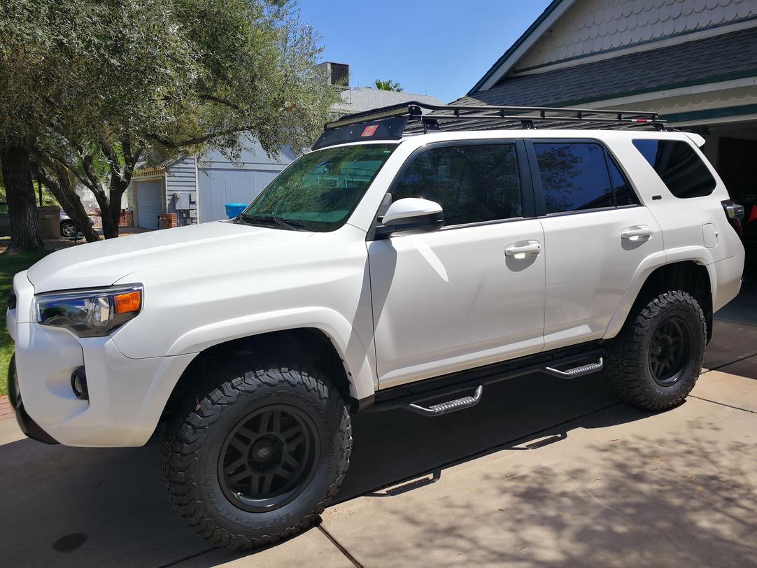

See attached for the same parts installed on his, I just got these photos today. He has a roof rack, so it may be a fraction lower than running a stock rack.
That looks awesome! I agree no spacers.
Looks like he has JBAs too? Any chance you know if those KO2s are 275s or 285s.

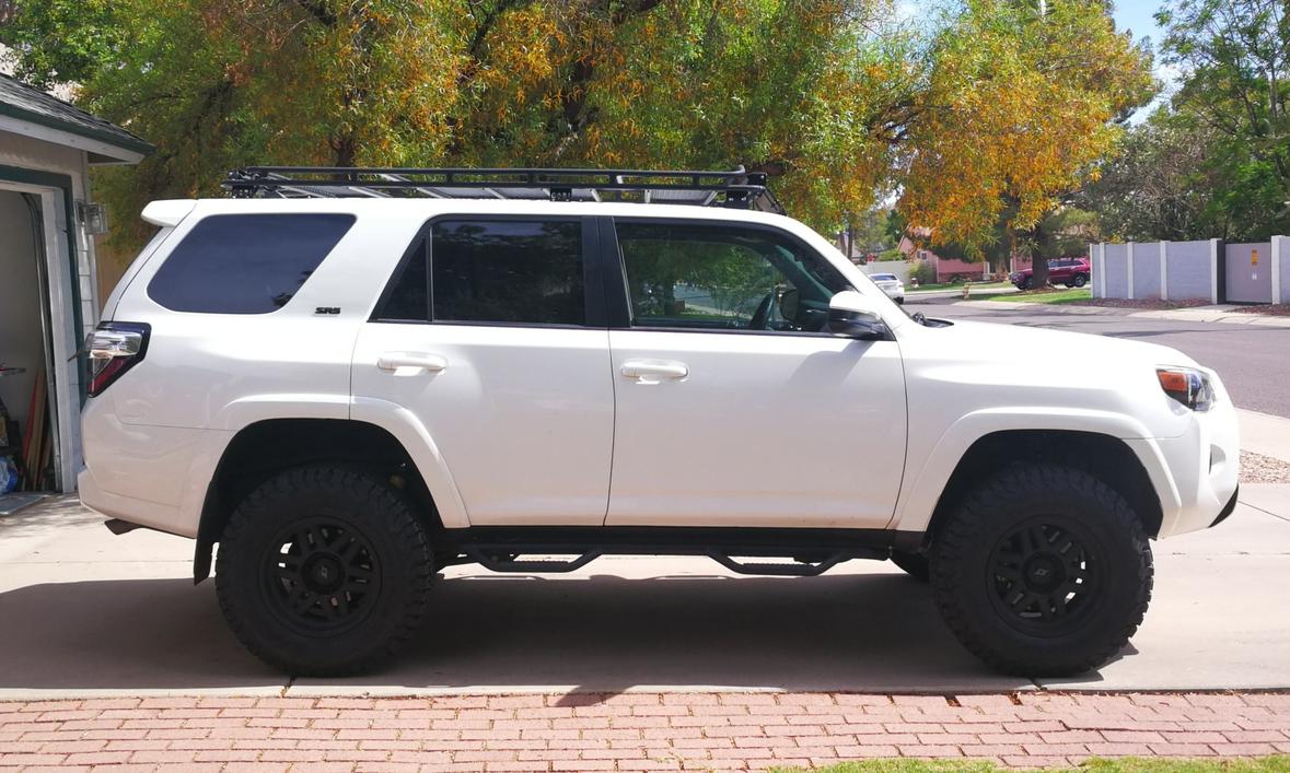

I haven't made any changes since this picture suspension wise, but I did replace the two stock front skids with the RCI aluminum front skid and added an air compressor in the front. Not sure what the net gain is. Anyway, here is the rake completely empty:
So as far as the rake goes, I've been back and forth on whether I want to drop the rear, but then after wheeling Wheeler Lake I'm wondering if I should raise the front. I'm about to load up to the ceiling to move, so I'm going to see what the rake is then. If you don't change any springs it will probably turn out level at the window line. And with the bags you are ready for a load.
