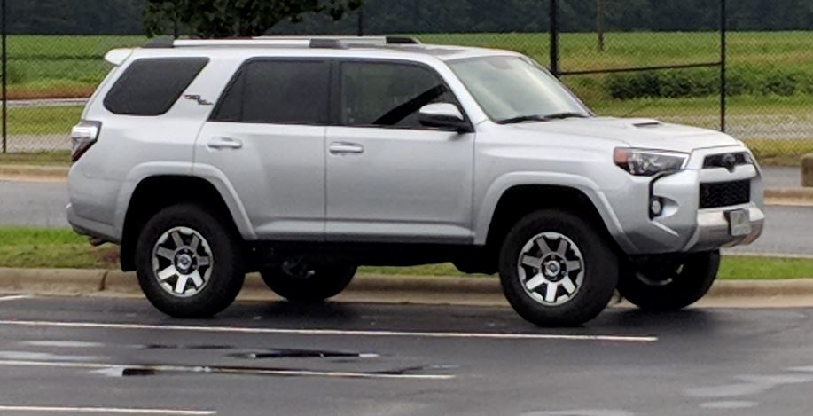

I ordered front 238 coils for a 1" lift in front, but maybe ended up 300s as I got a full 2" on both sides in front. 599s out back gave 1"

Be best to let it all settle and remeasure after 500 miles. The 238 coils are physically shorter and I noticed it when assembling those. The shorter the coil, the easier it is to mount on a strut.
It's not a 2WD, is it?

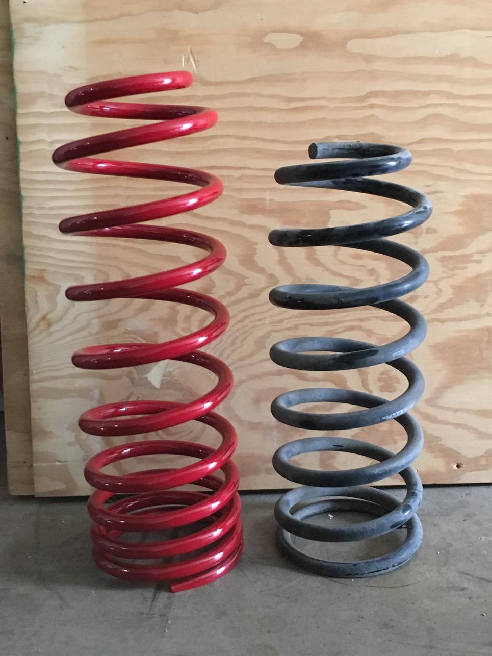

no pics of the new suspension setup yet, but thought i'd share just how tall the C59-677V rear springs are compared to the Toytec Superflex 2" rear springs. ride has been very comfortable paired with king shocks

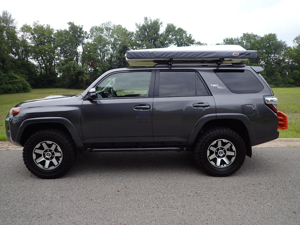

Here's mine with the 300/505 combo. I had originally posted the install back in April (post #756), but now it's had some time to settle.
