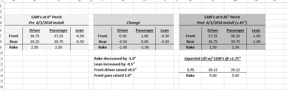

Thanks Mike. I've attached the measurements before and after moving to the 0.85" perch.
5100's at 0" Perch
Pre 8/1/2018 Install
Driver Passenger Lean
Front 36.75 37.25 -0.50
Rear 39.25 39.75 -0.50
Rake 2.50 2.50
5100's at 0.85" Perch
Post 8/1/2018 Install (+.85")
Front 37.25 38.25 -1.00
Rear 38.75 39.75 -1.00
Rake 1.50 1.50
I have the the C59-300's upfront too, and recently moved up to the 0.85" setting.
The Good: Looks much better, and there's no rubbing in the front. Rake is now 1.5" (rear to front)
The Bad: The driver's front raised 0.5" and the passenger front raised 1.0"; therefore the lean is now at 1.0". Also, the couldn't get the alignment within spec, so it's pulling a bit.
So.....I just purchased the adjustable SPC upper control arms, so hopefully this can bring it within spec, and help with the lean.
I'm considering having them move the lift up to the 1.75" perch. I think it would still have some rake to it, I'm just worried about the alignment - but with the new SPC arms, I think I should be ok. Any thoughts?? :ohwell:
5100's at 0" Perch
Rake 2.50 2.50
Rake 1.50 1.50
