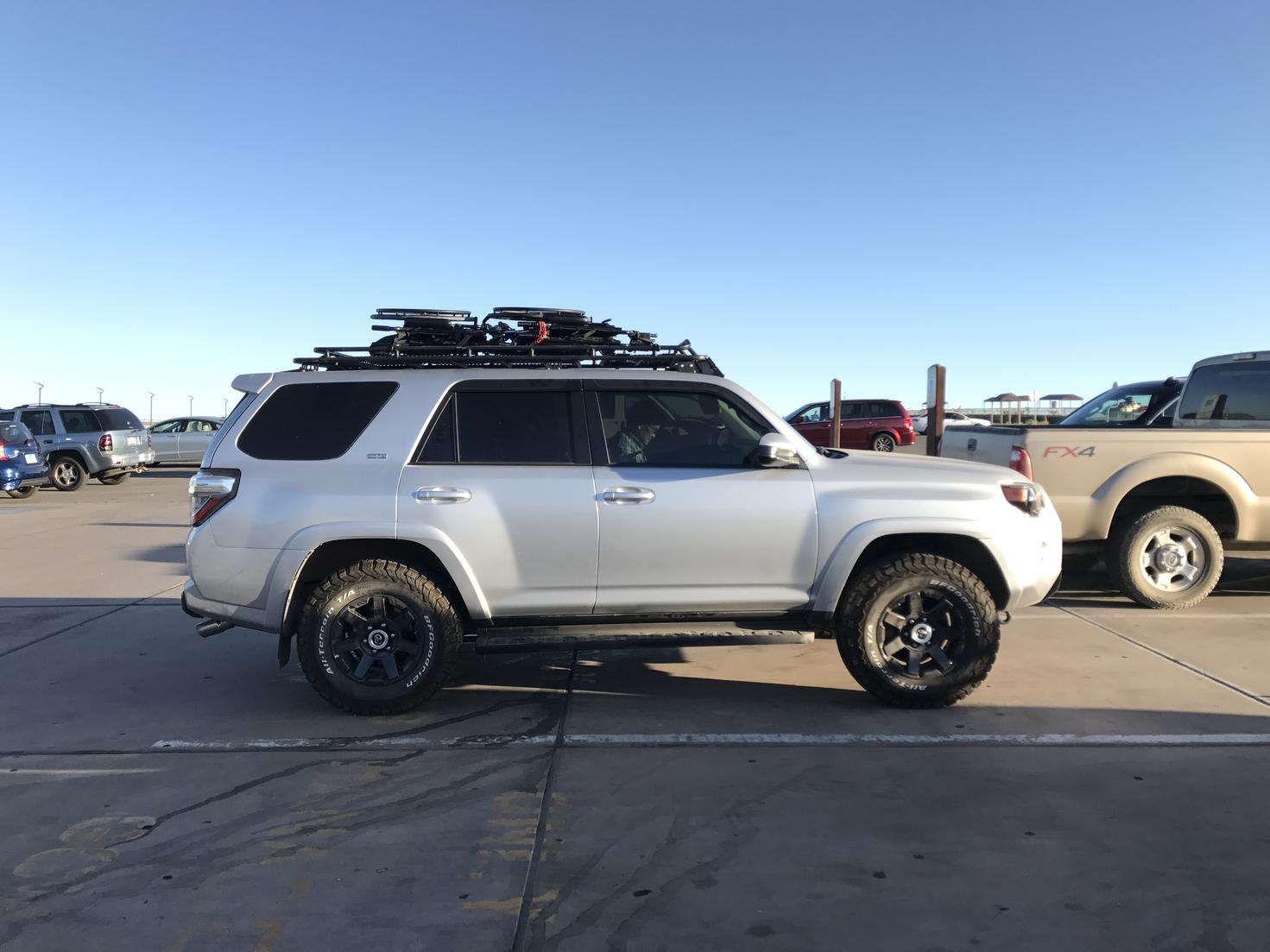

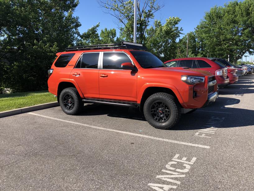

I'm sitting @ 41" in the rear roughly from the bottom of the rear fender with 315's sitting on C59-675V's /24" from center of rear hub to fender. Its sitting pretty much level in the rear with a 10mm trim packer on the drivers side. Haven't beat on the rear since it went on this past friday but road handling is great. The front is a 3.5+ TC kit

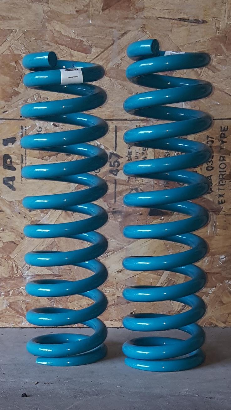

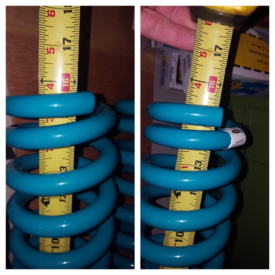

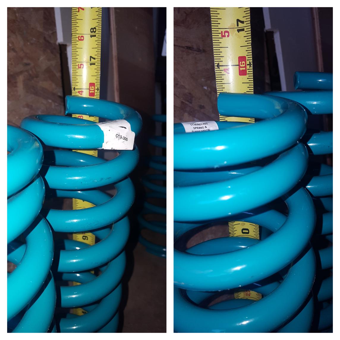

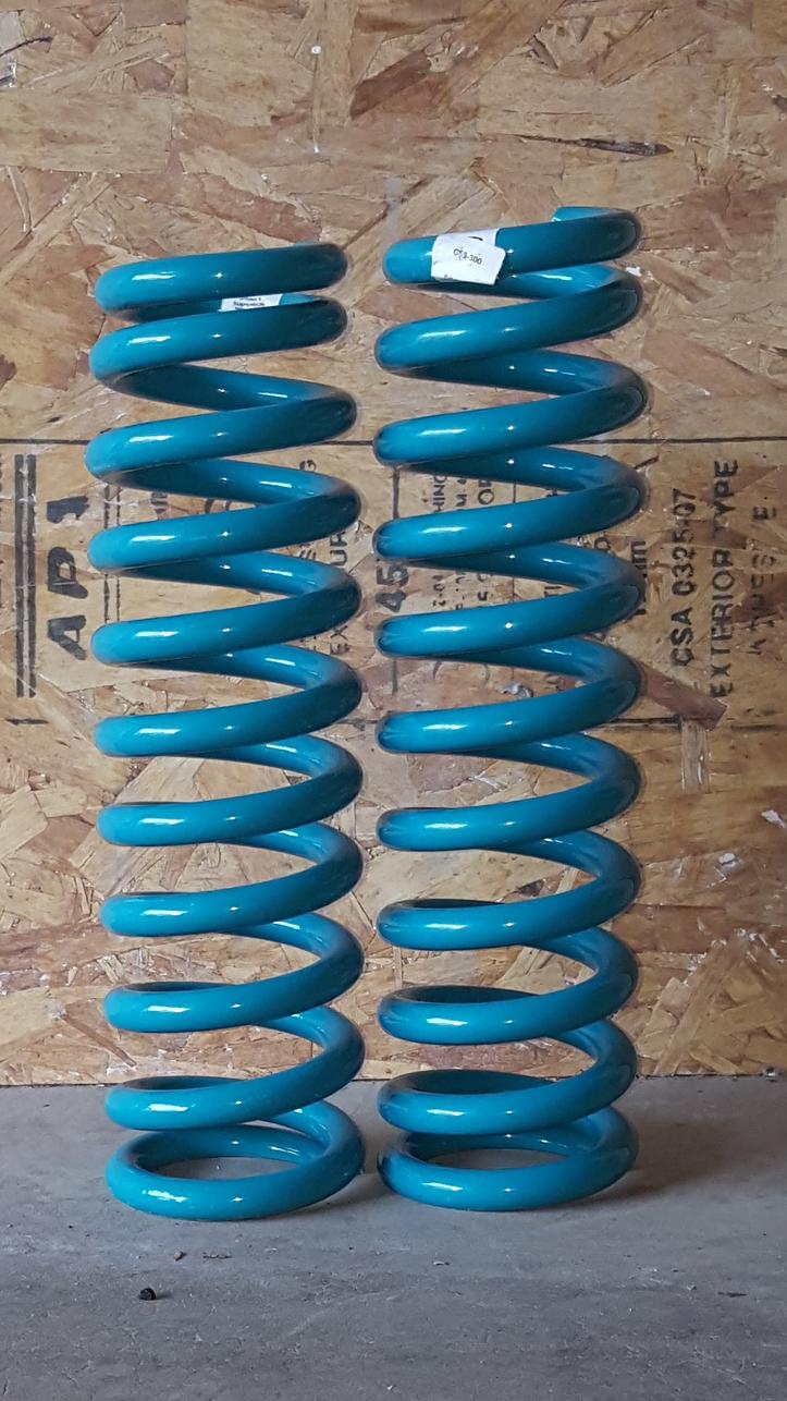

Just received my spring order. Went with c59300 up front and c59599 in rear. Looking at the springs and the rears seem the same size, however the fronts seem to be about a half inch different in height. Are they supposed to be this way?
I’m 99% sure those are both front springs in your photo.
