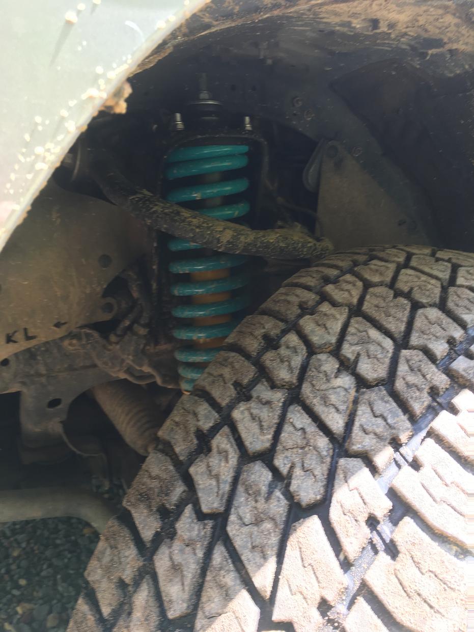

I am now considering "downgrading" or is it really upgrading to the Dobinson's 2'' package to replace my ICON Stage 1 2'' lift. I have needed to rebuild my Icons about yearly or roughly every 15-20k, I only offroad about 10% of the time too. It's always one of the front COs that leaks, the rears have been solid. Basically, I am tired of dropping $400-500 a year on rebuilds at the shop. I was overzealous when I bought the kit and hoped it would last at-least 30k between rebuilds not 15k ... I don't post much but felt I had to vent and look forward to the Dobinsons!
Dobinsons 2” lift
Rocking the Dobinsons suspension this weekend. Awesome performance compared to stock suspension.
#hiluxsurfoffroad
#dobinsons
#GTPeaceautomotive
Someone else just did this, but with our 3" gear. They were having to rebuild with their truck down too often, and this year, the rebuild took a lot longer than expected, and their family summer trip was getting pushed. I haven't heard from them since the install and the trip, but I think maybe they're still on it!!

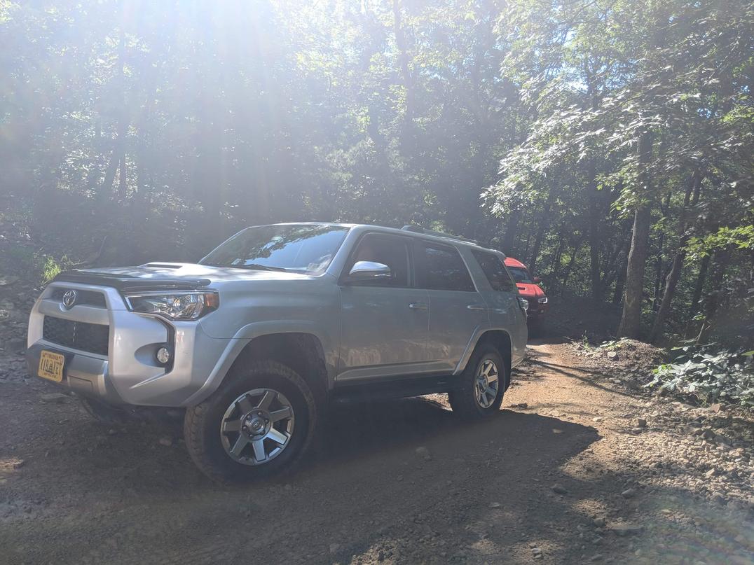

Upgrades all installed this year with the SSO bumper being the last part. Sporting:
* RCI aluminum skids (getting beat to hell -- go for steel everyone for the front, the aluminum will suffer of any hard real world use)
* SSO slimline hybrid bumper with cutouts for eventual winch
* Dobinsons mid-weight coils and 2" lift
* RSG sliders (not seen)
* Falken Wildpeak AT3W (P-rated, but no issues so far with regular off-road .. run at 28psi on trail)
Original install of Dobinsons had a poor post-alignment but after I had a new shop re-do the alignment it drives smooth and handles well. Night and day off-road with the lift and extra clearance.
On-road driving (expansion seam and speed bump test) is smoother as well. Overall less "crashing" of the suspension.
