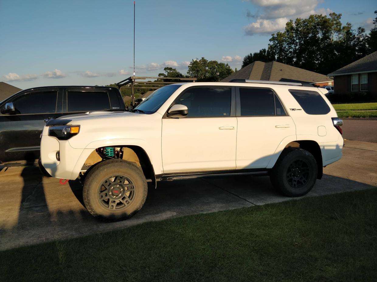

I was not really interested in a "lift" but I added a SouthernStyleOffRoad Slimline and a winch, REALLY sagged in the front after that. Hard braking made the truck wallow back and forth and nose dive was extreme. All because of about 120lbs added to the front.
On the advice of Mike at Dobinsons I purchased the C59-300 springs. Paired with Bilstein 5100s. Resulted in a level stance. I didn't get any pics when it was sagging but the springs gave me 2" over what it was prior to installation. As it sits I measure 21 1/2" from the center of the hub to the fender well.
Note*** I purchased new top hats from Monroe, part #907922. Toyota tech REFUSED to install them. Said "These are complete junk. Take them back and get your money back". He re-used the original Toyota top hats, they had less than 8k miles on them.

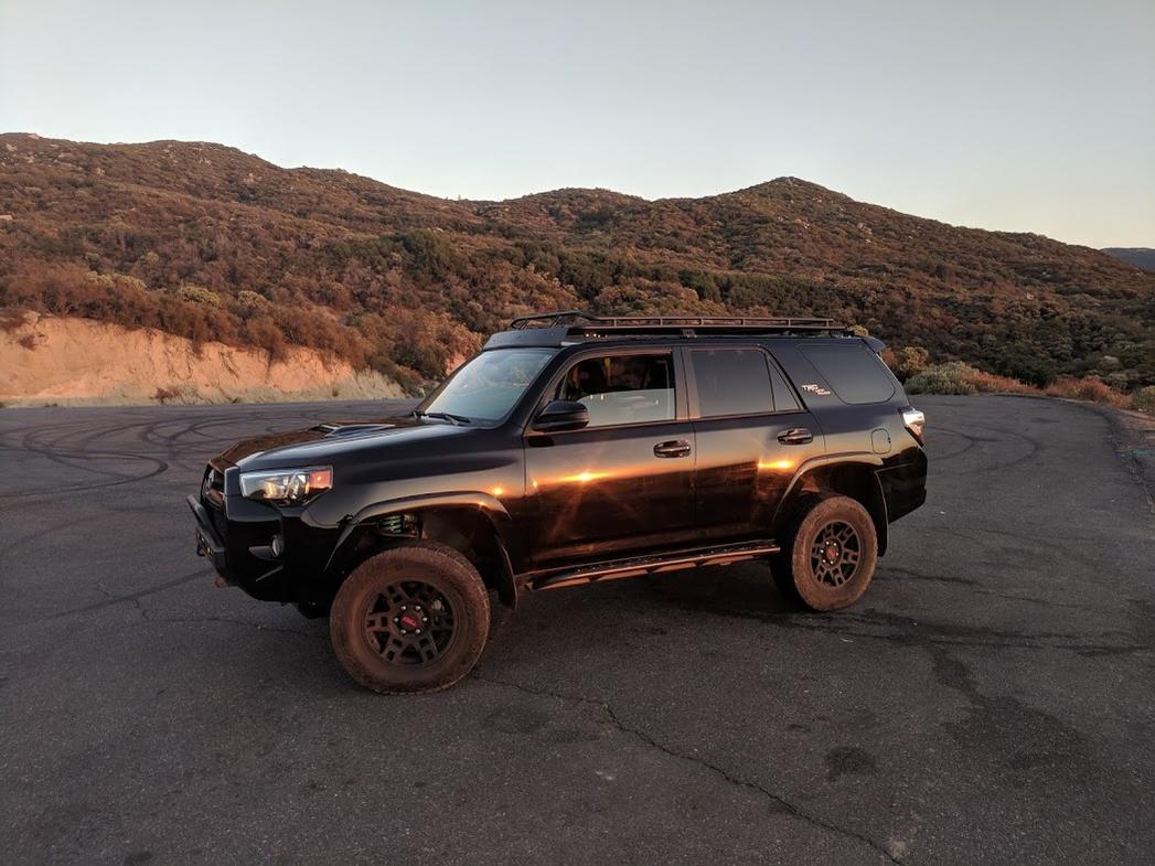

Just wanted to drop by and say that I have really been enjoying my setup that Mike helped me out with.
I went with C59-726 - 100-220LBS heavy load front weight, 2" lift. 385/380mm, 18mm wire, 730LB up front and C59-723 - Stock rear end, 1.25" to 1.5" lift, offset height coils for KDSS leveling. 420/405mm, 17mm wire, 228LB in the rear.
It handles the extra weight when I load up for camping great and I have been impressed with how it feels at high speeds off road since that isn't what I bought this for really but it handles everything I have thrown at it so far with ease. I got just about what is stated above for lift over stock, but it brought everything up 3+ Inches after I installed all the aftermarket parts on stock suspension. Has been a huge help having the extra clearance offroad.
Thanks again Mike.

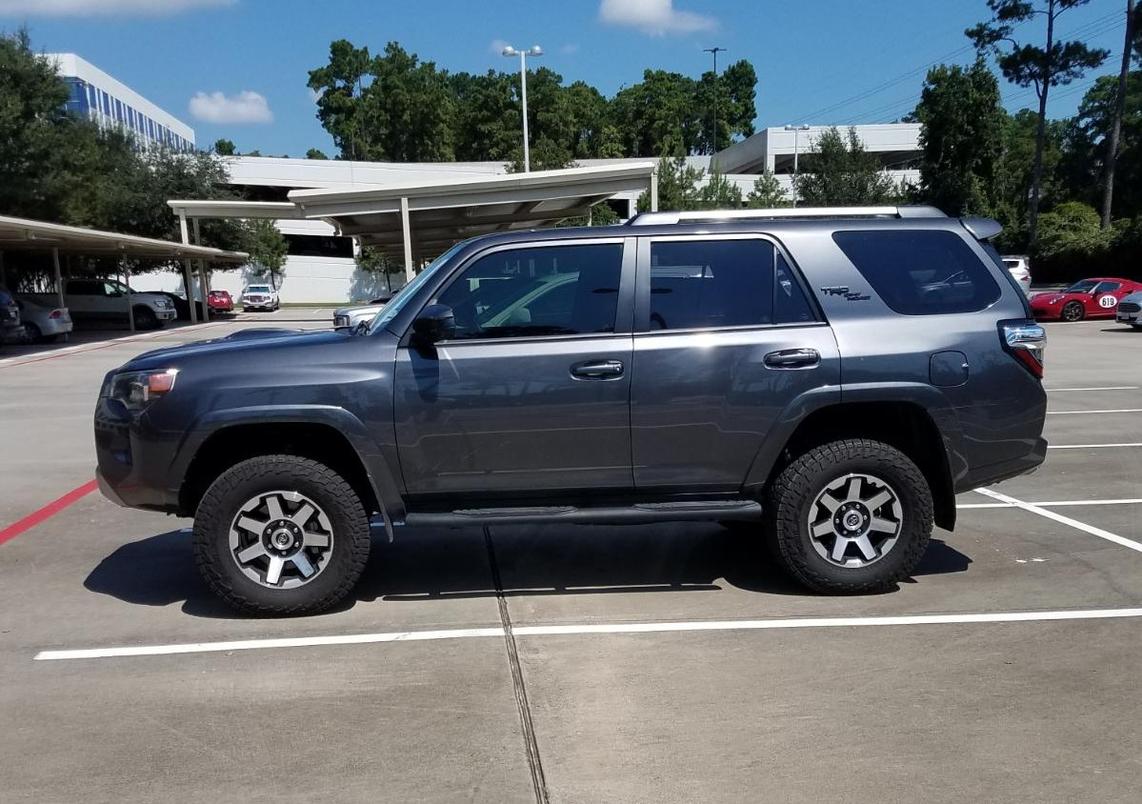

Dobinsons 2.5 Lift
I like that it is almost level. Went with Dobinsons springs and bilstein 5100s
c59-302 front(2.5)
c59-505 rear(1.5)
Stock Sized tires(falken wildpeaks)
Picture quality is not very good, but just an idea of what this combination looks like. I wanted to keep the stock sized tires for overall functionality. Ride is significantly better than stock. More solid suspension, with almost no nose dive when braking.

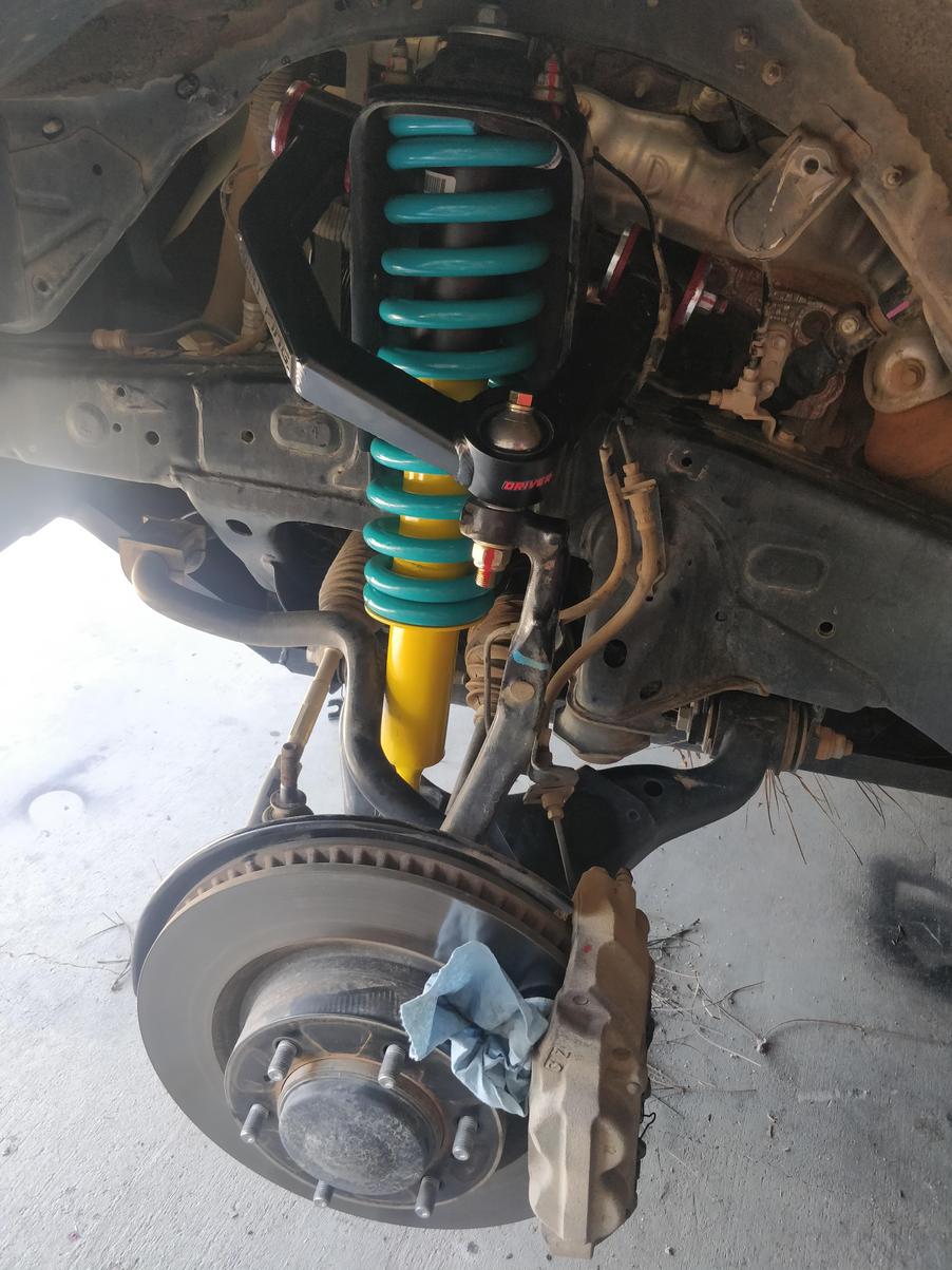

Time for my story, I decided to take advantage of the Labor Day sale and so this is my order summary:
Front Springs:
C59-302 - 2.5" lift with stock front end load, 2"
Rear Springs:
C59-675V - Variable rate comfort option, stock rear weight, 3" lift.
Front Strut Options:
GS59-574 - Twin Tube, fixed mount (not adjustable), long travel, adds 1" lift
Rear Shock Options:
GS59-705 - Twin Tube, suits 0-2" lift, softer valving for empty rear ends.
Front Optional Install Parts:
DD59-527K - required with 3" lift, could also be used for 2" to 2.5"
Basically I wanted a 3in lift without falling into an LT setup that would require a whole bunch of other upgrades. It might come later but I figured I had to start somewhere.
I decided to pair my Dobinsons coils & struts with a pair of Dirt King Upper control arms that I had bought earlier on a group buy right here on T4R.
I don't have that many pics of the install but they will be attached to this post reply.
Installation took 2 days, but realistically it could all have been complete within the same day, we had a pretty gnarly heat wave that pushed the temperature to 111F with 100% humidity... We could only work on morning time !
This is why you will see pictures of the 4R with only the front raised :spider:
The right quality difference is there, very well done Dobinsons.
So far I'm loving my setup.
Only two critics :
- Paint on struts is VERY VERY fragile. Do you recommend a specific paint marker to prevent rust from developing ?
- Diff drop kit is still backordered, but I never got notified. Had to call the office to ask if it was maybe shipped on another parcel, but no it's backordered.
Overall extremely pleased so far with my Australian suspension ! :bounce:
The paint on the struts is enamel, never had anyone say that it's fragile before. Enamel touch up paint is what you'd need for them. Where/how did you mark them up? It looks like you left your sway bar touching them in that first photo, before it was reinstalled.

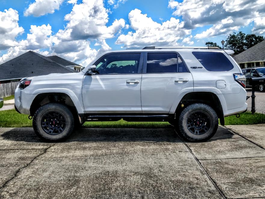

Still loving my Dobinsons kit. Thanks Mike! Slapped on some new KM3s today.
302's with LT struts. 325's in the rear.
