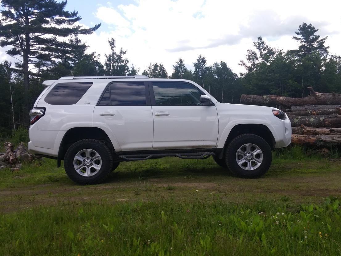

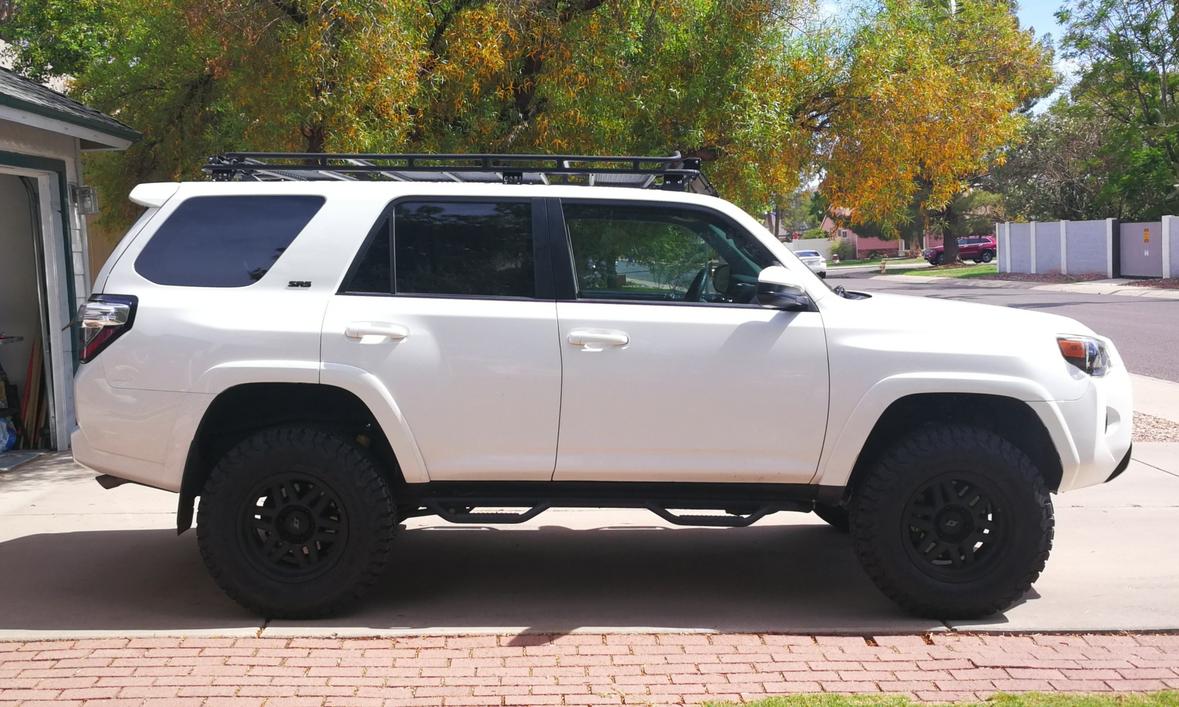

The 302 front and 325 rear would be a good option for you. That's 2.5" in the front unloaded. In the rear, that's 2" to 2.25" when empty, and you'll definitely have about 2" of rake to play with.
Here are some photos of those same coils on 5th Gens.
I'd suggest GS59-700 front struts, and GS59-705 rear shocks, if the rear will stay empty. If you'll end up carrying some weight always, then the GS59-701 shock valving is better suited. You can't use the long travel front struts with those, as they add lift as well. And the rear LT shocks would give too much down travel with those coils that the coils would come loose at full extension.
