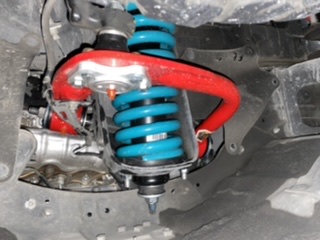

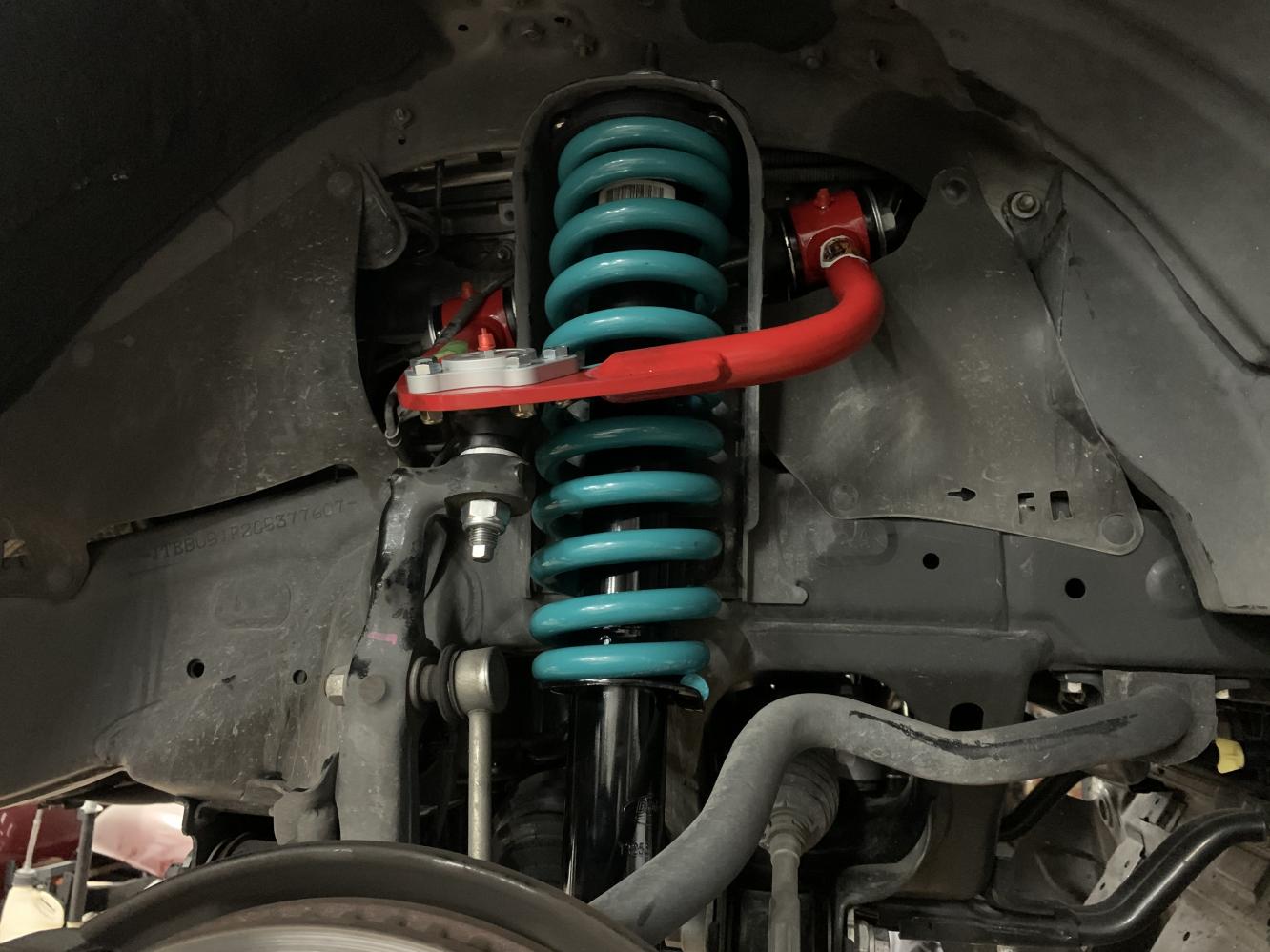

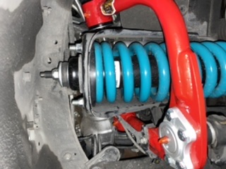

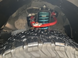

So I had my 300/574 front and 325/705 rear installed today with JBA UCA and a body mount chop.
I’ll be getting 285/70/17 falken wildpeaks on 17x8.5 -10mm rims.
Check the install to ensure proper installment. How does it look?

Looks like the parts in the last photo were all put in upside down!!!

mike, i hope i didn't install my fronts wrong by looking at this pic, but my front driver and passenger side struts, i have the coil mount perch facing the rear. is that a problems?
No, not a problem. That's the way they should be on a 5th gen.
It doesn't make a difference though on a 5th Gen with the Dobinsons twin tube struts, as it's only for sway bar clearance on some vehicles that require it to face on way or the other, and there's no clearance issues with these struts and the sway bar.
