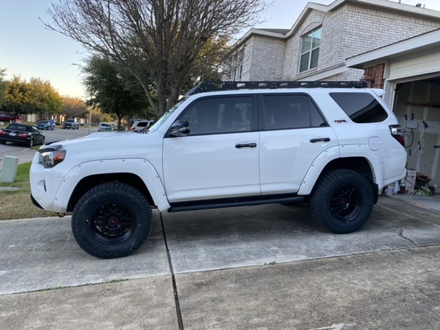

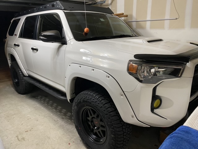

I need to get pics on level ground. This was in my driveway on an incline. It sits pretty level. Hope the front settles an 1”. I was hoping to keep 2” of rake higher in rear but only have an inch. The combo of 300/574 front gave me a little over 3”.
The garage photo is on level ground but can’t really see it how level it is. Better pics coming soon.

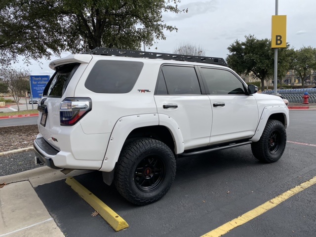

The 300/574 and 325/705 is settling now. In the front I initially got 3.25” of lift but has now settled to 2.75” which is where I wanted it. This is after driving around 150 miles. Rides fantastic too. Not at all firm or stiff to me.
