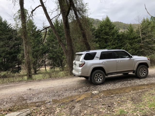

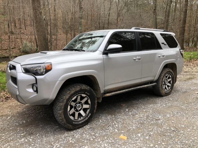

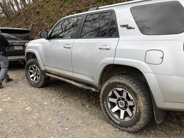

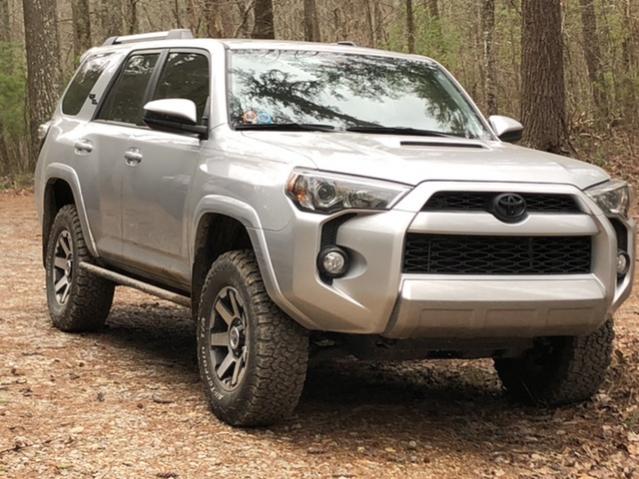

302/505 setup(stock uca) doing the Georgia traverse. Stock size ko2’s with a cargo full of camping gear. Thanks to mike and everyone here with all the help. 1000 miles round trip. Properly broken in :)

Looking good. How did it handle the trail?
Handled it great! We did the middle portion going west to east. we did the north loop that goes into tenn and back into ga. lots of diff types of terrain. climbing switchbacks with slick rock, with muddy moguls. the suspension fully loaded with gear in the back felt like butter as opposed to the stock suspension which would have been more bumpy and jarring. heard some squeaking in the rear and i wondered what the heck did i screw up when installing, but ended up being water bottles still in the kirkland case. lol. i have no other suspension to compare to besides stock but i love it so far.

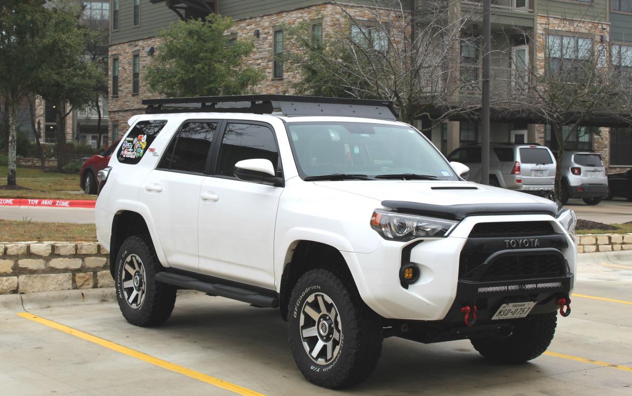

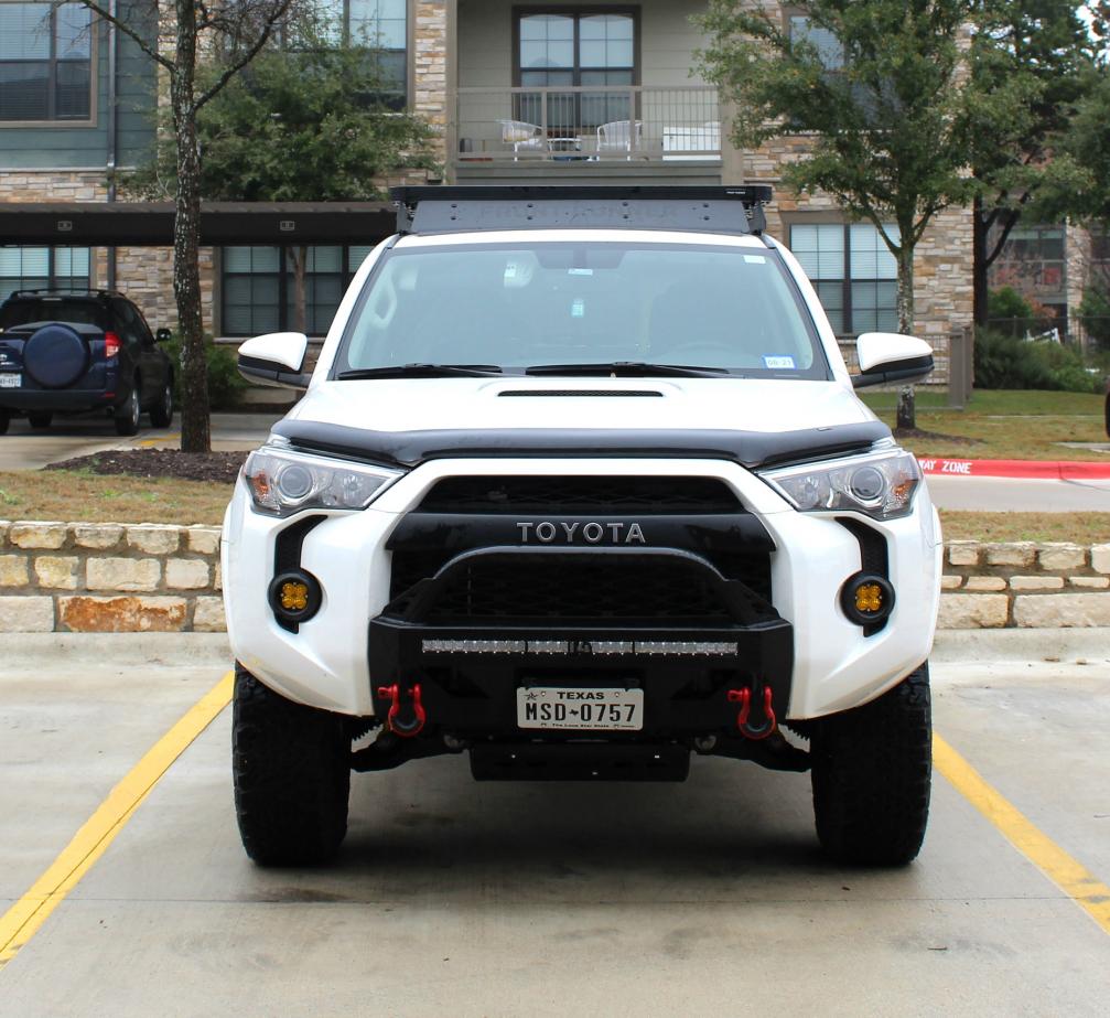

Got a question for you guys.......
I recently bought a 2017 TRD ORP that had the King OEM performance coilover and rear shocks. I ordered the Dobinsons C59-327 springs as that is what I was recommended to order.
This weekend I installed my front bumper and winch and the rear springs. I set the preload on my front coils for 2.75" of lift, about. Then installed the rear springs. I noticed quite a bit of rake, and to my surprise when I measured from center of wheel hub to fender, I had 22 7/8" in front and 25 in the rear. I have determined that I definitely have the wrong springs in the rear.
I'm adding a drawer system soon in the rear, but i'm still thinking I need either the C59-505 or maybe the C59-325 to get the rear lift down to the height of the front. basically I need to drop the rear 2".
What do you guys recommend?

New springs take about 500 miles to break in. Measuring as soon as parts are installed isn't advisable.
C59-327 with no rear weight generally give 2.5" lift once settled. Drawers, depending how much they weigh and what you put in them, will drop it about 1/4".
