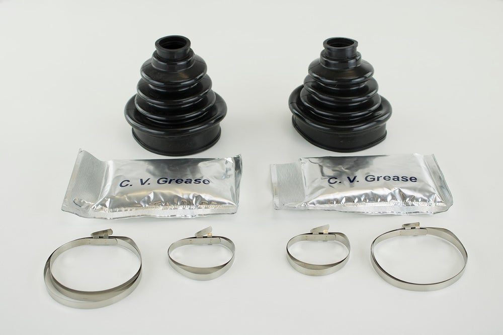

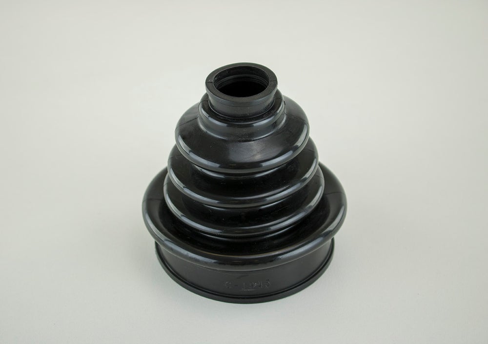

Dobinsons CV boot kit for outers
Just added this to the site and here on post #1 as well.
CV Outer Boot Kit
CV59-554K - High clearance stretch style CV boots for the outer position of the front shafts. High quality silicone, includes all new grease and clamps - great for lifted vehicles with higher angle CV's which are prone to boot failure
Dobinsons High Clearance Outer CV Stretch Boot Kit for Toyota & Lexus
These can be installed the standard old fashioned way, or with the proper stretch boot tool, installation can go much faster with less work. Check it out here: https://www.youtube.com/results?search_query=stretch+cv+boot+installation
