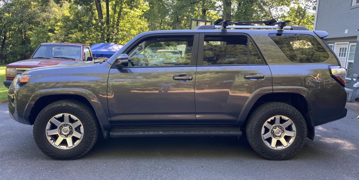

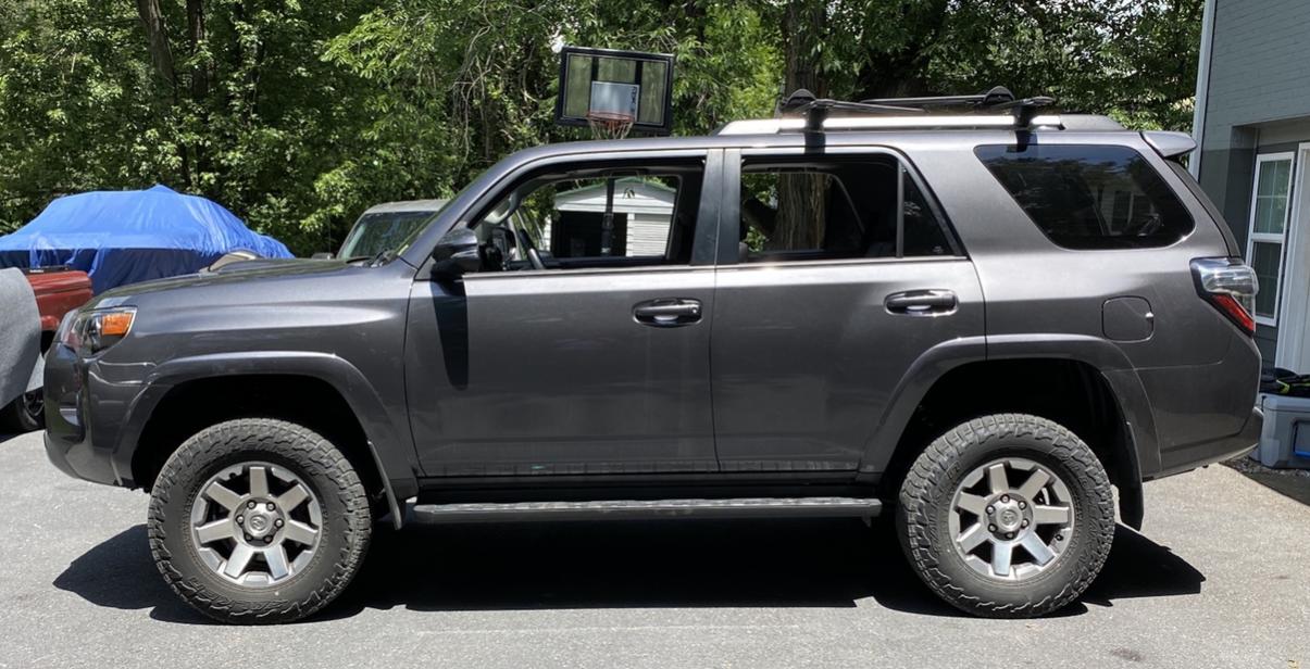

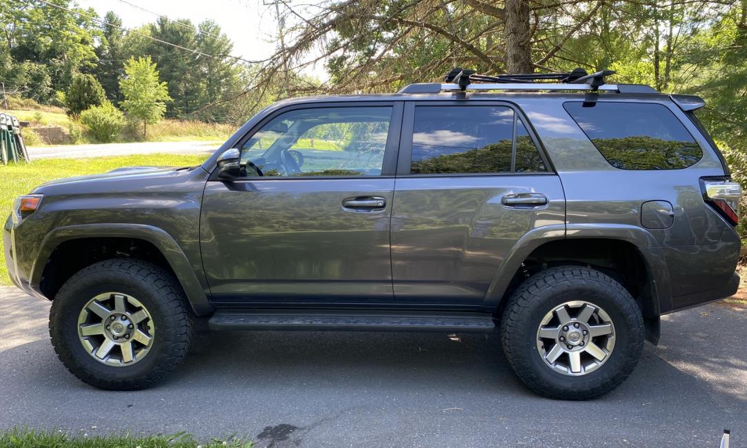

I wanted to come here and provide some feedback on my lift. This may be long (first time I’ve ever said that…) so I’ll break it up by topic.
Exit Offroad/Mike - Mike at Exit Offroad was awesome to work with. Extremely quick to respond. I even changed the rear shock I wanted after placing the order and he got with the warehouse and within hours my order had been changed. (The warehouse ended up not sending out the right ones but Mike hurried out the correct ones and I had them in two days. He was quick to make it right.) Definitely recommend Exit Offroad!!
What I Got - I ordered an IMS lift for front and rear. 302 front springs (2.5” nominal lift stock), 505 rear springs (1.5” nominal lift stock), 50700 IMS front shocks and 50705 IMS rear comfort tuned shocks. Also got the front and rear passenger side shims to address KDSS lean. I wanted a softer riding suspension than what is typically found in a digressive tuned shock (these are progressive tuned) and something high quality that would last.
Install - Not going too detailed with this since there are tons of other write-ups. But these are some things I learned that I don’t recall seeing in other instructions. I bought new strut top plates so I could pre-assemble my coilovers using my spring compressor. These springs are stiff but mine aren’t HD so my compressors worked but may not work for everyone. (Be careful with compressors!!) Drivers side front went in super easy with no KDSS disconnect. Passengers side front was a pain and I disconnected sway bar from LCA and from the fixed link. With a jack and leverage went back together pretty easily. I set the fronts a little high so I could easily clean the threads and lower the seats as needed to dial things in.
Rear was pretty easy as well. Was able to leave both sides of the sway bar connected since I used spring compressors to remove and install springs. (Thanks [MENTION=118321]Jetboy[/MENTION]) I installed the spacers/shims front and rear on passenger side to address potential lean.
I’m pretty mechanical and I had help so it took about 5 hours total and that was not being in a hurry and enjoying some cold beverages. Looking back, it was easier than I was expecting. YMMV. Also, get some flex head ratcheting wrenches. Makes life so much easier!!
Results - I over analyzed what to get because I didn’t want to screw around with this multiple times! My Numbers are below, hub to fender.
Pre Lift
Front
19.25 19.00
Rear
21.75. 21.75
As you can see. Fair amount of sag up front exaggerating rake and a little lean up front and no lean in the back.
After Lift (After a couple of days and 200 miles)
Front
22.75” 22.75”
Rear
24.25 24.75”
I knew it hadn’t finished truly settling but it was clear to me the rear didn’t need the spacer. I had read the lift could exaggerate any lean so that’s why I installed it in the beginning. So I removed it. And that eliminated the rear backwards KDSS lean. I was surprised the front was high on the passenger side but would correct by lowering seat rather than removing the shim. My camber was way off and since I had gotten an extra 1/2” of lift in the back than I was expecting with the 505’s, I was going to have to leave the front a bit higher. So I decided to get UCAs to ensure the correct ride and good alignment since I would be pushing or over 2.5” lift in the front.
Went with Freedom Offroad on that per [MENTION=411635]Sundy[/MENTION] recommendation. After that install it drove and handled much better even before an alignment. But what was weird, the UCAs affected what I was measuring for lift. Strange but perhaps the extra camber created a measurement of more lift?
After UCA install and after the alignment and my current numbers are below.
Front
22.75” 22”
Rear
24” 24”
I’ll drive it for about a month and then if it all stays pretty much the same, then I’ll lower the front left a little and should be good!!
Performance
The initial imbalanced bouncing I experienced is completely gone. While the ride is firmer than I was hoping/expecting, it’s ride is predictable and stable. And on larger bumps and dips it handles it well. It’s almost smoother the faster I go over dips. There are some RR crossings that used to be quite rough, but it floats over them at speed. Wish it was softer over smaller road bumps… I haven’t gotten off road yet, but hope to soon.
Pics. I’ll try to load in order. Pre-lift, then after lift but before new tires, then after new tires.
