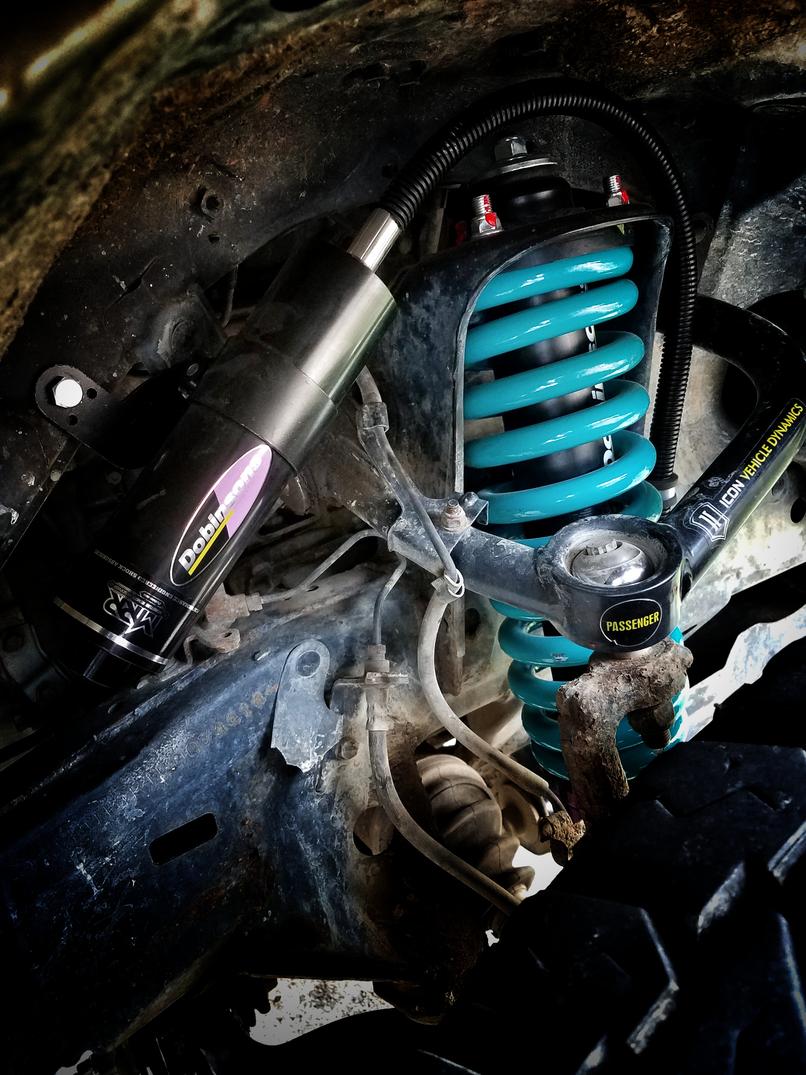

Here are some shots of my new setup.
It's Dobinsons C59-350 w remote Resi in the front, and their C59-677v in the rear.
Perfection. Very supportive, good ride height.

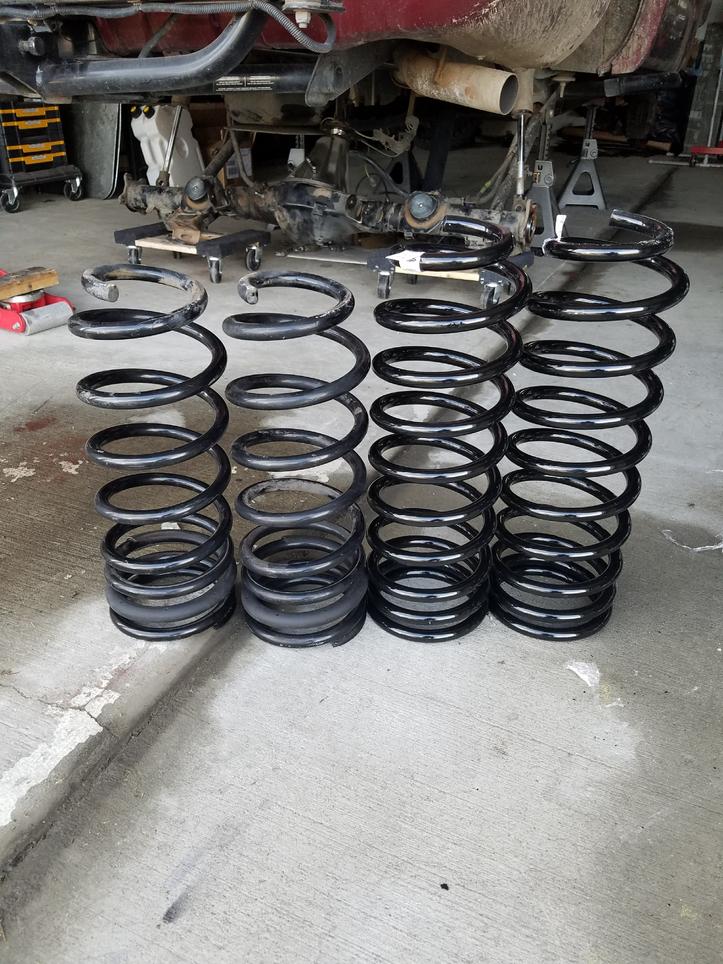

Got my 701's installed yesterday afternoon. These springs are stiff! Once I lifted the axle to a certain height it was lifting the body off the jack stands! I'm going to have A LOT of weight in the back (900-1000lbs) fully loaded once I get my drawer system. I may have to drive with all my stuff in the back till that gets put in as I'm sure it'll be stiff. You can see the difference in height between the Dobinsons and the Overland Icons. Thanks to Mike for getting these out to me so quickly. Hope to have her running today then it's 500mi of baby driving till the new gears are broken in.

I need to ask, what are you carrying that makes up 1000lbs? Are you planning on wheeling with that much weight because you might need to consider upgrading your rear diff to something larger than the Toyota 8".
I don't disagree with you...at all. But with a 250lb (est) drawer system, R TT, awning, rear steel skids, rear Wilco, larger spare, fuel, water, fridge, tools, camping necessities, food, beer, my overweight ass, etc it adds up. It might be closer to 800-850 but I wanted to go heavier rate first and my Excel sheet stated I would be close to 1k. I'm hoping to shave some weight in other places. With that said...Im not a rock crawler. I could if I wanted to as Im "prepared" for it but I do more stuff like forestry trails and backwoods shit. I'm not out doing Rubicon or crazy crazy Moab stuff. Know what I mean?
