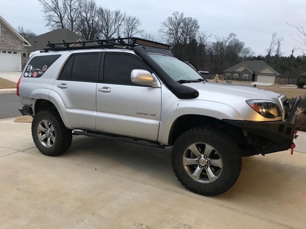

Aww nuts I ordered too soon. Anyhow I can finally post a picture of my truck with the lift since I just had 5th gen trail wheels and 255/80 st Maxx’s installed. 302/723 spring setup with dobinsons shocks.

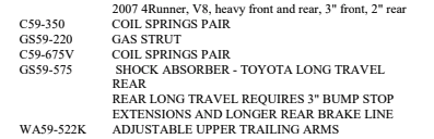

I think you need to go with our 730LB front coils, same as Tennessee Overland is running, so C59-350 with GS59-220 for 3" front lift, then C59-677V 3" rear with GS59-575, and add bump stops and rear brake line if you don't have those already.

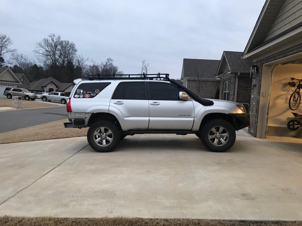

Here is my Dobinson suspension setup with their long travel rear. Dont mind the missing rear bumper, I took it off to finish up some welds and paint it.
When loaded down with the weight of the bumper and spare tire this suspension rides amazingly well. I cant recommend this set up enough!

Looks good man! I just ordered those JBA arms myself and I'll be ordering the Dobinson rear shocks and coils here soon as well!

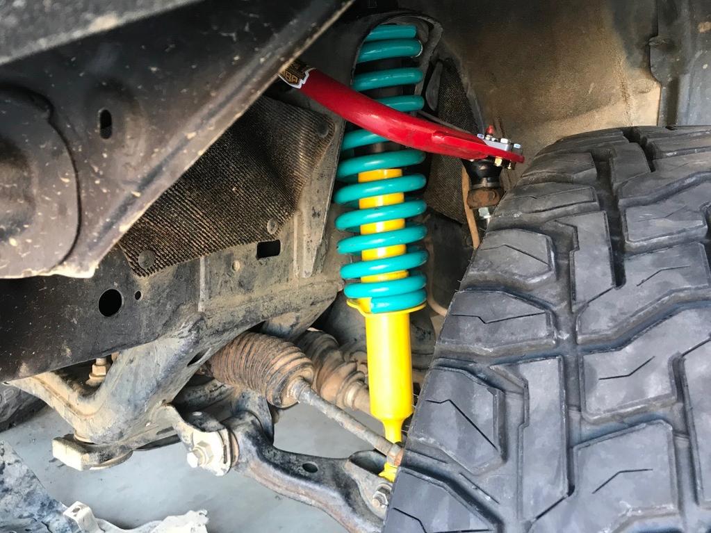

For 3" lift on a V6 with 150LBS on the front, GS59-220 struts with C59-302 would be the right combo to be sitting at the correct height. And we can ship them preassembled, so you can swap out the front in just an hour or so.

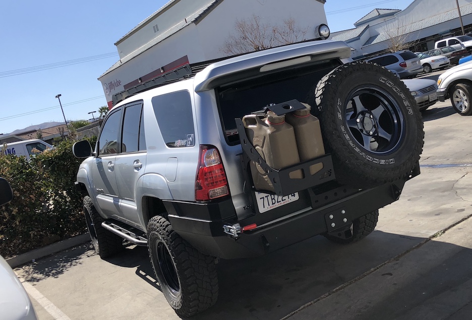

Got my springs in last week, they're beefy! made the car ride beautifully though, i got the 677 in black, granted i had OME 895 which couldn't handle all the new weight of the back bumper but the 677 made the car feel like stock again, super drivable, would definitely recommend if you guys are looking for something that can handle the weight of a rear bumper plus more.

That's great. Can you let us know how much weight you've added on the back, and what your hub-to-fender measurement is on the rear?
I've had several people ask this week for the 677V's, but we need some more real-world feedback on the 4th gen's for final ride height with extra weight.
From hub to fender each side is 25 1/4'' and thats with the OME Trim packer on the driver side, in terms of weight i believe the CBI bumper and attachments is at 235lbs, and the spare tire is about 80lbs so total 315lbs.
