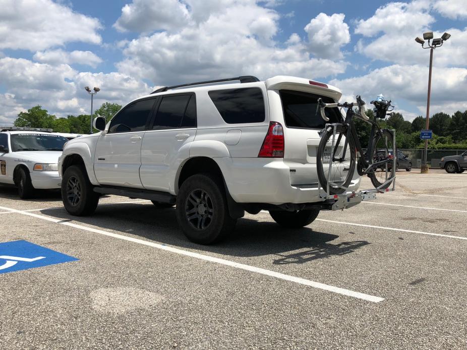

Installed my Dobinsons springs and shocks last weekend. Only have the one pic below so far. The bike and rack don't weigh much - only about 25-30 lbs.
I have a 2wd v8, which weighs about 30 lbs less than a 4wd v6. So I chose the springs based on the v6 options. I installed C59-296 springs in the front for 1.5" of lift and GS59-220 shocks with the higher spring perch and an additional 1" of lift. In the rear, I have the C59-505 springs for 1.5" of lift with a 10mm spacer on the driver side and GS59-705 shocks. I ended up with just over 1" of rake from front to back and about 1/4" of driver side lean. Can't complain about any of that.
The fender heights are below. I have 265/70/17 tires.
Ground to Fender
Front Driver - 36 3/4"
Front Passenger - 37"
Rear Driver - 37 7/8"
Rear Passenger - 38 3/8"
Hub to Fender
Front Driver - 22 3/8"
Front Passenger - 22 5/8"
Rear Driver - 23 1/2"
Rear Passenger - 23 3/4"
