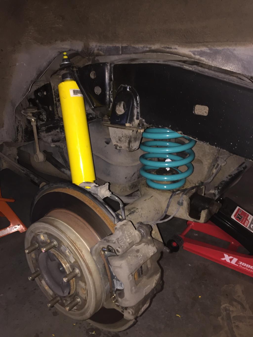

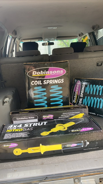

Hello there!
I just bought and installed my new
Dobinsons Nitrogas Suspesnsion
There is any way to know what i got?
GS59-220 / GS59-221

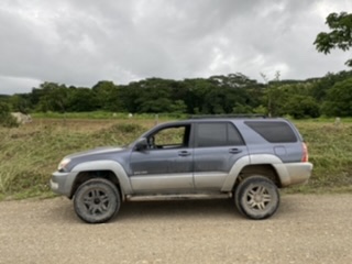

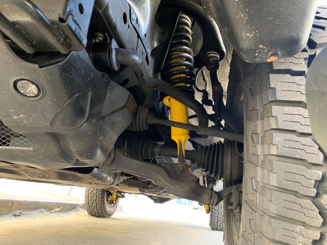

Is it okay that my rear have more lift than front?
Hello there!
GS59-220 / GS59-221
All of the struts and shocks have the part number stamped into the metal base of the shock.
The coils have a white label attached to them with the part number on those.
Yes, it's fine to have the rear higher than the front, that's normal rake, so that when you add weight to the back, or fully load the vehicle up with people, it can support the weight.

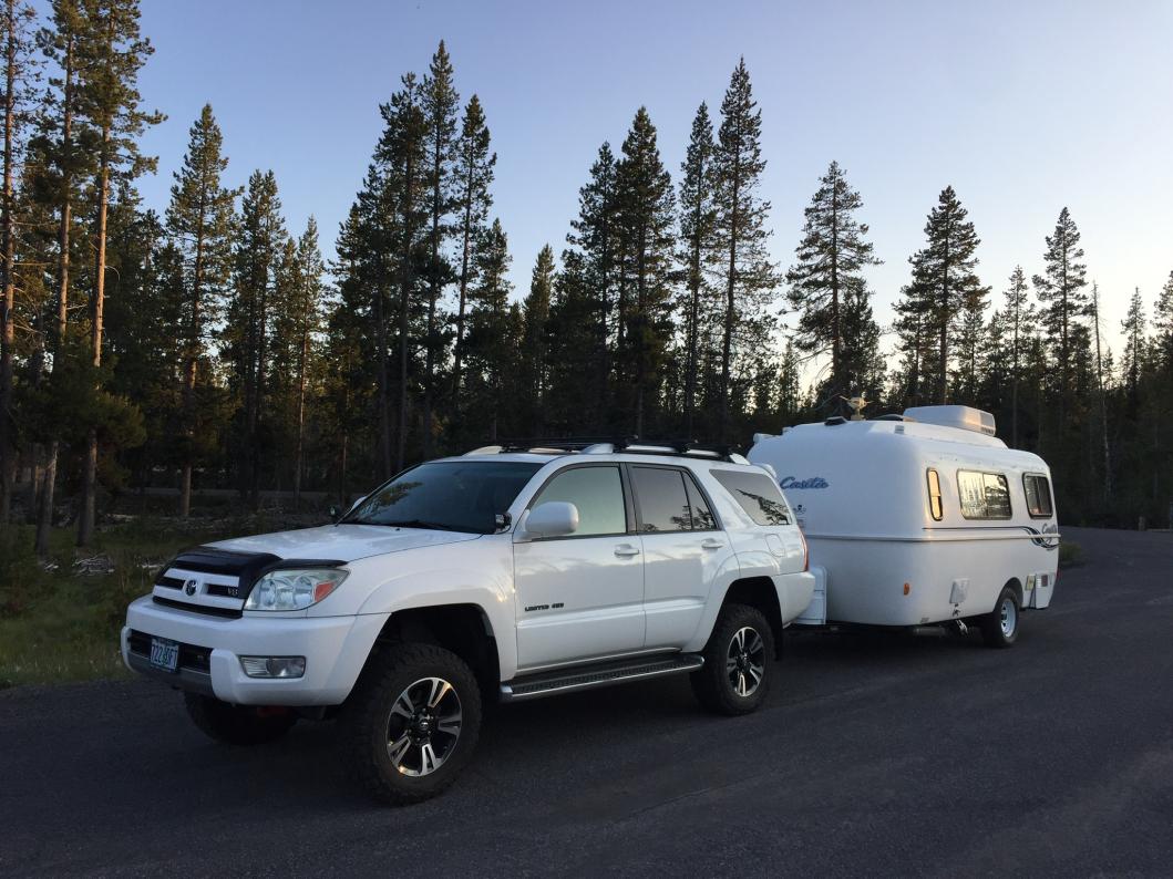

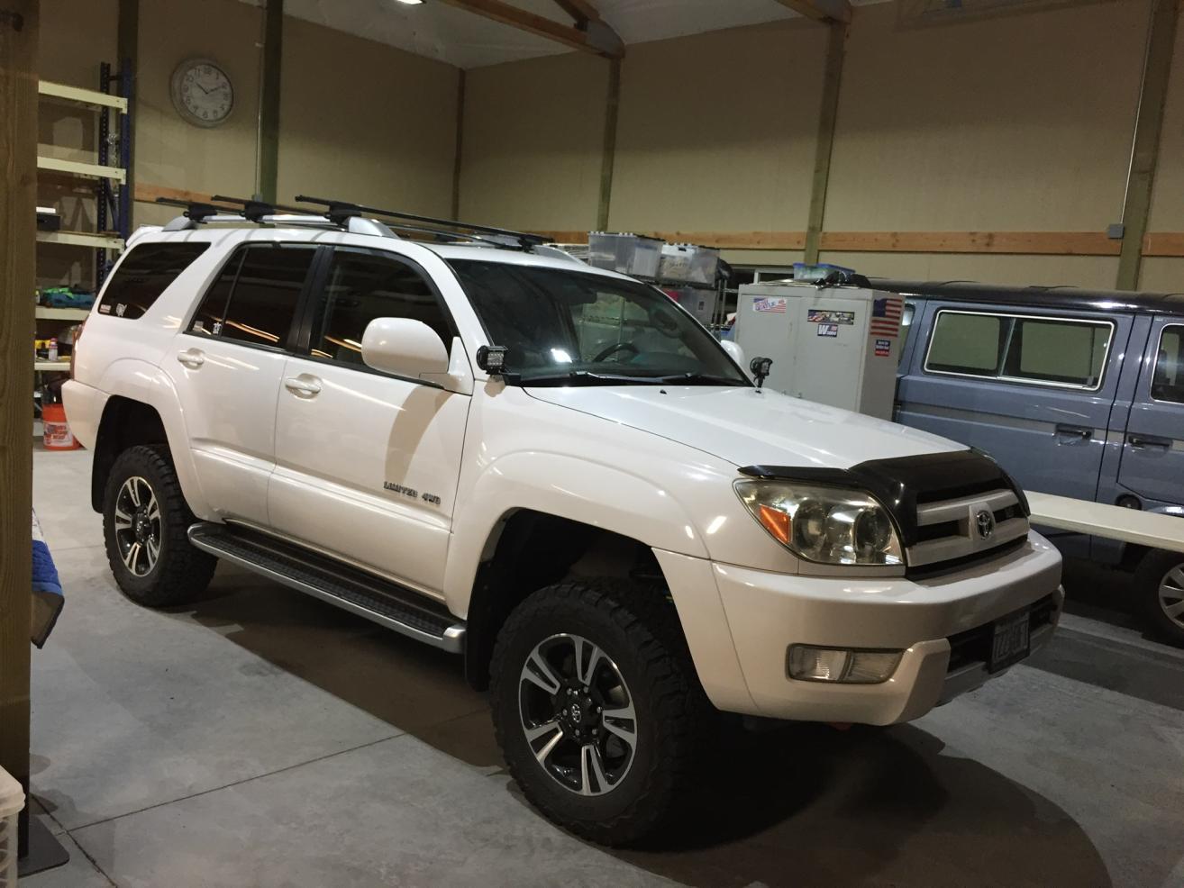

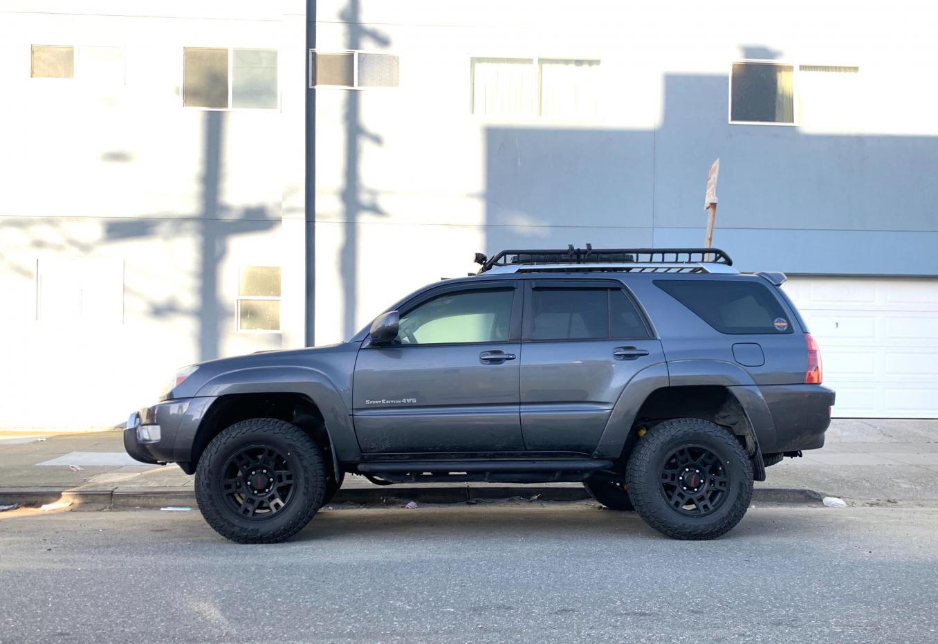

Just want to shout out to Mike for helping with my lift setup back in January. Six months on, many trips later, and the suspensions have been fantastic on and off road. Extremely glad I went with Dobinsons.
Front Coils: C59-300
Front Struts: GS59-221
Rear Coils: C59-325
Rear Shocks: GS59-705
Rear Coils: C59-325
Hey! Thanks for the update and the photos. It's looking really good the way you have it setup!!

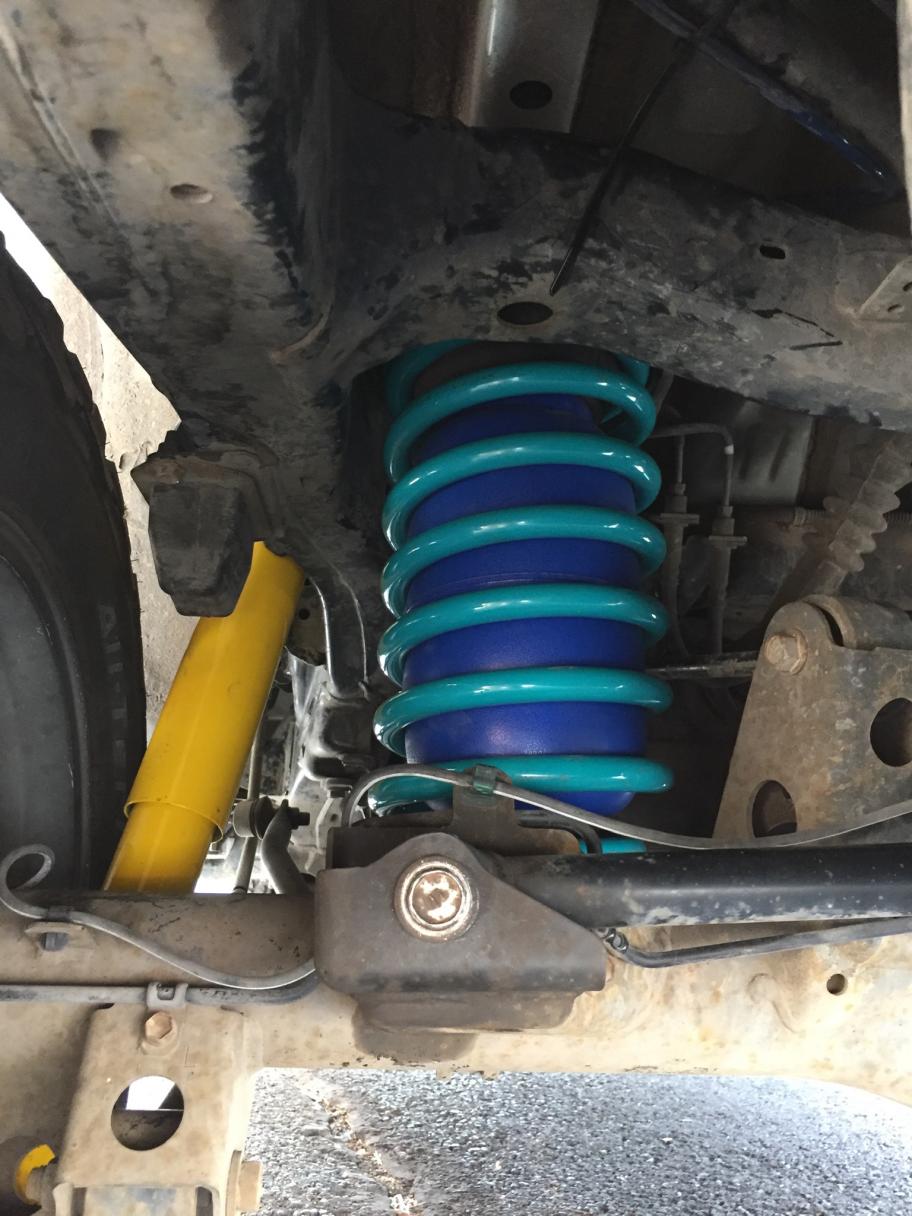

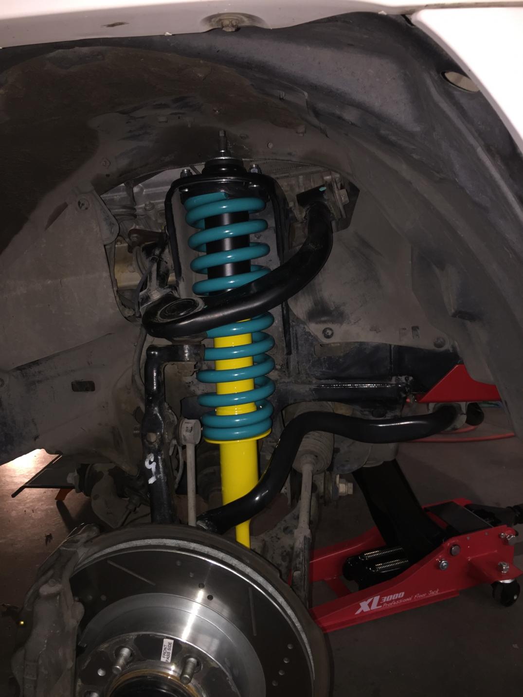

I think I owe Mikey and Dobinsons some feedback. Installed the:
Front Springs: C59-314 - V8 - Stock front end load, 2.5" lift.
Front Shocks: GS59-221 - Twin Tube,
Rear Springs: C59-505 - Stock rear end load, 1.5" lift.
Rear Shocks: GS59-701 - Twin Tube
Added in ft 1/4 inch spacers for a full 3 inches in front. Ended up adding some Firestone air bags (1 inch longer then stock option) in the rear to help with trailer towing. Overall very happy with the result. Runner sits flat now. Much more even damping front to rear compared to before as the front springs were toast after me putting on 180k on them. I’ve owned all the first 4 Gens and love this one. But a recent “Mojave Trail” excursion told me this truck needed some love. I should go back to that trail soon to see how she does now.
Here’s a couple photos of the Dobinsons installed and with the Firestone bags too. Fortunately where I live I didn’t have to deal with a ton of corrosion, pretty good for a 17 year old Runner. Install pretty straight forward and did it myself alone in my quarantine shop
That is an extremely clean 4th Gen!!! Glad you're happy with the ride and everything it's done for you!!

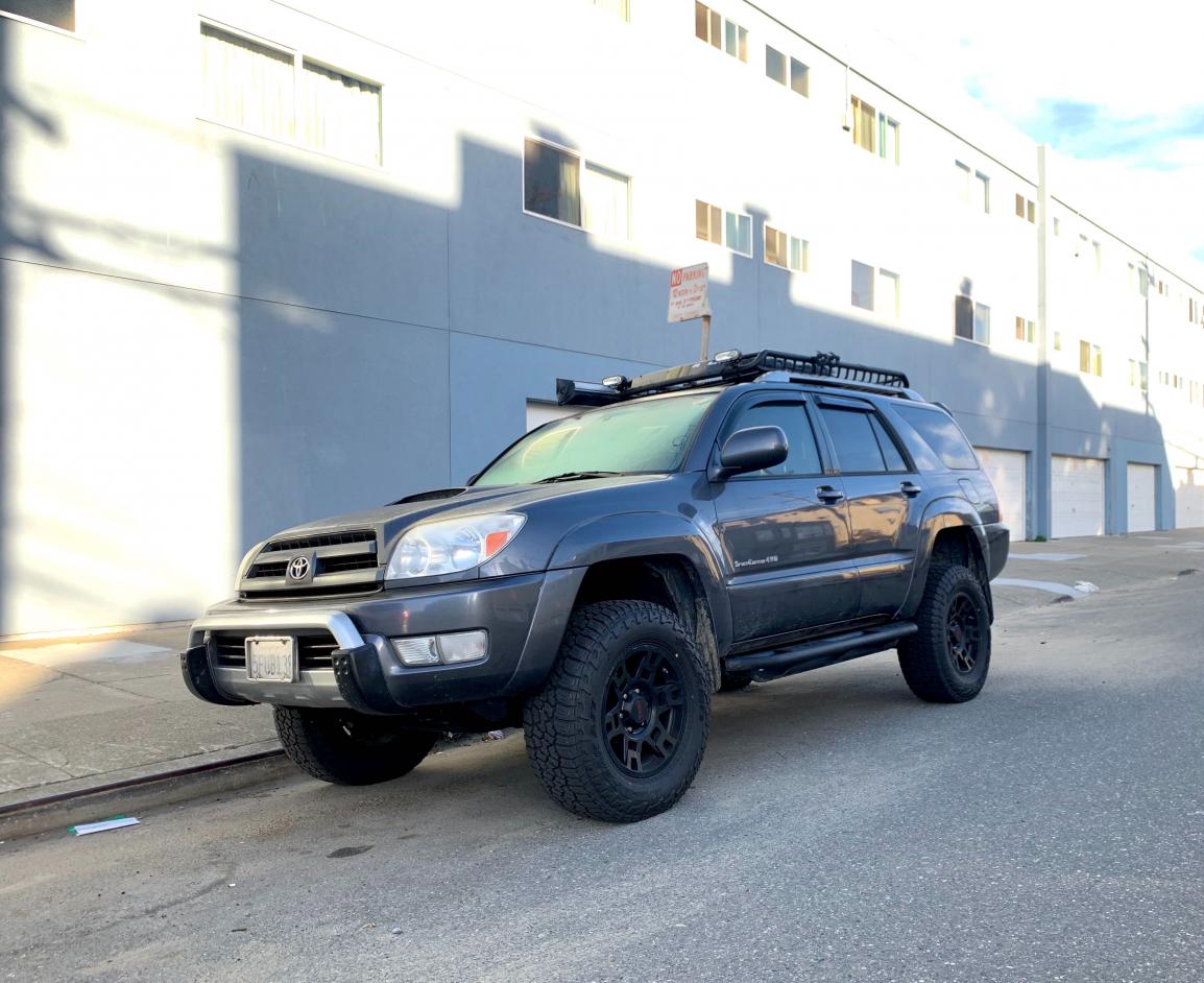

Decided to swap out my 5100s and FJ coils which I've had for about 100k miles. Mike has been top notch and answered every little question I had. The truck rides great!!
Before: 5100s set at 0.85 with FJ coils
After: front C300 GS 221 rear C599 GS705
