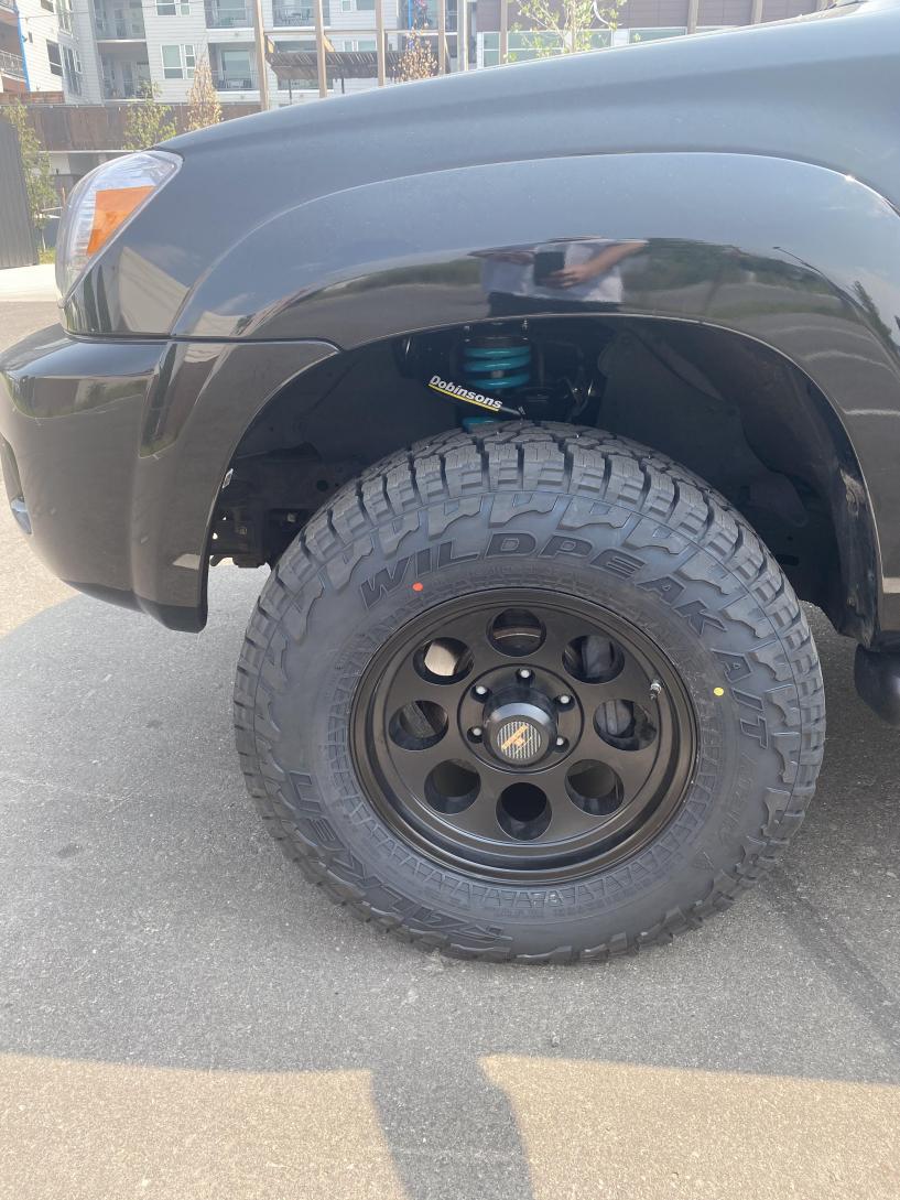

Decided to swap out my 5100s and FJ coils which I've had for about 100k miles. Mike has been top notch and answered every little question I had. The truck rides great!!
Before: 5100s set at 0.85 with FJ coils
After: front C300 GS 221 rear C599 GS705

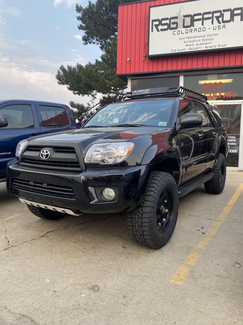

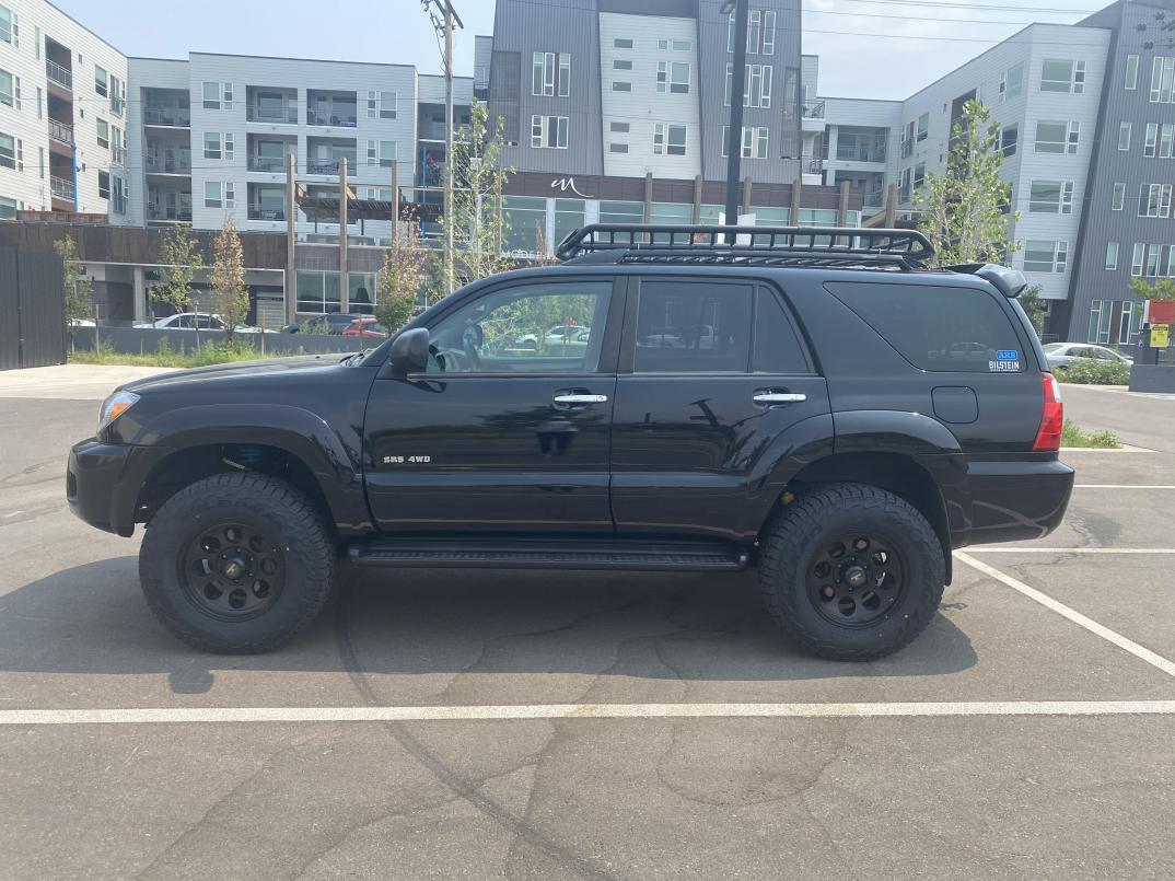

Here is my 2008 V6 with the following suspension installed:
Front: 302/221 (2.5" lift) + Dobinson 1/4" driver side spacer (PS59-4030) + Dobinson UCAs
Rear: 505/705 (1.5" lift) + Dobinson 15mm driver side spacer (PS59-4025) + Dobinson rear adjustable swaybar links
Also had a diff drop installed while I was at it
Tires are 275/70/17 Falken Wildpeak AT3W, Load range C, on Level 8 Trackers (17/8.5, -6 offset)
Extremely happy with the way it turned out and the ride quality! Haven't taken any measurements yet, but let me know if someone needs them.
