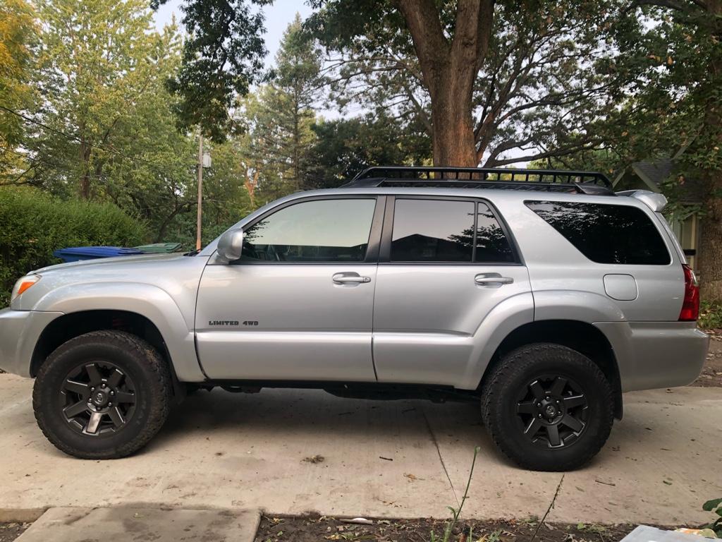

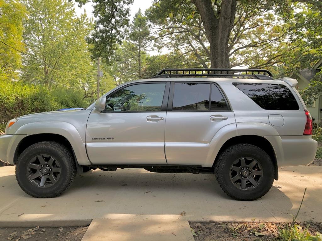

After hours and hours researching different set-ups for the 4th gen (seriously....so much information on this site) I finally decided on Dobinsons coils (599 rear and 300 front) and Bilstein 5100s (set at 0). I had actually purchased Moog FJ coils but the more I read about them I saw a lot of examples where they wouldn't seat correctly and the ride was questionable so I decided I only wanted to replace my suspension once so I should do it right and go with Dobinsons.
I'm only about 20 miles in (all on road so far) but I'm really happy with how everything rides and looks. I previously had the stock XREAS suspension with Daystar leveling spacers in the front. Considering it had 135k it still rode fine but was getting a bit tippy and bouncy. That feeling is gone now and it feels firm and stable but not harsh at all.
With 265/70r17 tires here are my approximate old and new measurements (hub to fender):
Old (stock XREAS, Daystar leveling spacers in front):
Front Driver: 21
Front Passenger: 21
Rear Driver: 21
Rear Passenger: 21
New (Dobinsons 300/599, Bilstein 5100s at 0):
Front Driver: 22
Front Passenger: 22 1/2
Rear Driver: 23 1/4
Rear Passenger: 23 1/4
The stance is perfect and I definitely got more lift than advertised due to my saggy old springs. Very happy with how it turned out.
Front Driver: 21
Front Passenger: 21
Rear Driver: 21
Rear Passenger: 21
Front Driver: 22
Rear Driver: 23 1/4
Front Driver: 21
Front Passenger: 21
Rear Driver: 21
Rear Passenger: 21
Front Driver: 22
Rear Driver: 23 1/4

Thanks for the writeup!!
I consider hub to fender 20" front and 22" rear to be a baseline (that's an average of what they were when new, same as a 5th Gen), so with your 22" front (2" over stock/new) and 23.25" (1.25") rear lift, you're right on the money with where it should be. The rear will settle a bit more most likely though over 500 miles.
Do you know what kind of ground clearance you gained with the new springs? How does it feel driving around town over potholes, bumps, etc?
I didn’t measure ground clearance specifically, just the standard hub to fender (before/after is noted above). It feels more sturdy and stable now. Firm but not harsh. XREAS was fine but had started to feel a little floaty and bouncy especially over uneven terrain or bumps there would be a lot of body roll back and forth. All of that is gone now. 300/599 coils are a great option for anyone looking for a mild lift that doesn’t need to support a bunch of excess weight with bumpers, etc. The ride is great and in my case with replacing an aging suspension, it rides better than stock did for me.
