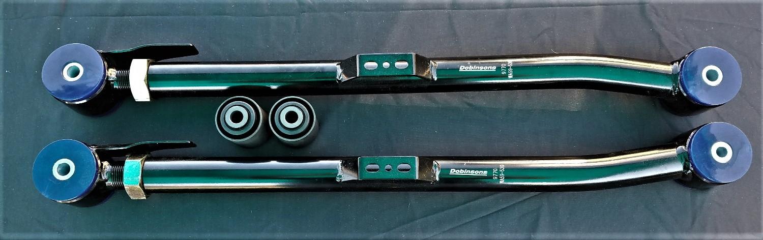

Rear Lower Adjustable Control Arms - WA59-520K - Comes with poly AND rubber bushings, so you can run your choice. 5mm (0.2") wall thickness HSLA steel.
Rear Upper Adjustable Control Arms - WA59-522K - Comes with poly AND rubber bushings, so you can run your choice. 5mm (0.2") wall thickness HSLA steel.

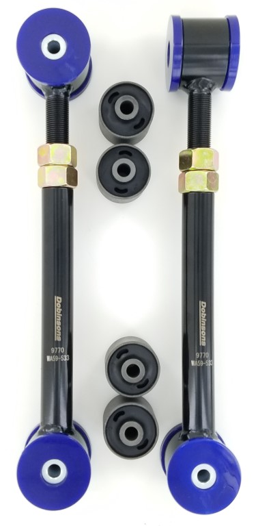

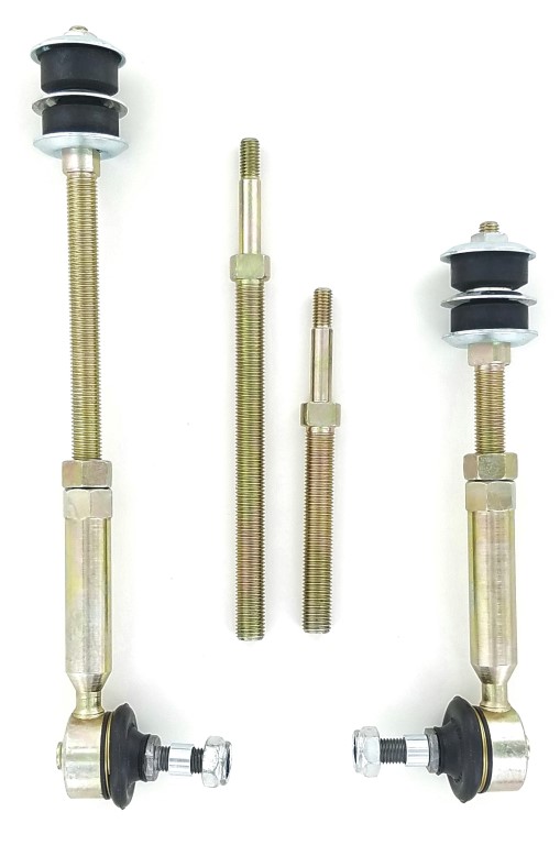

Rear sway bar extended length end links
Comes with 2 length rods to suit any length of lift up to 4". Uses factory style ball joint ends, gold zinc plated. SE59-529

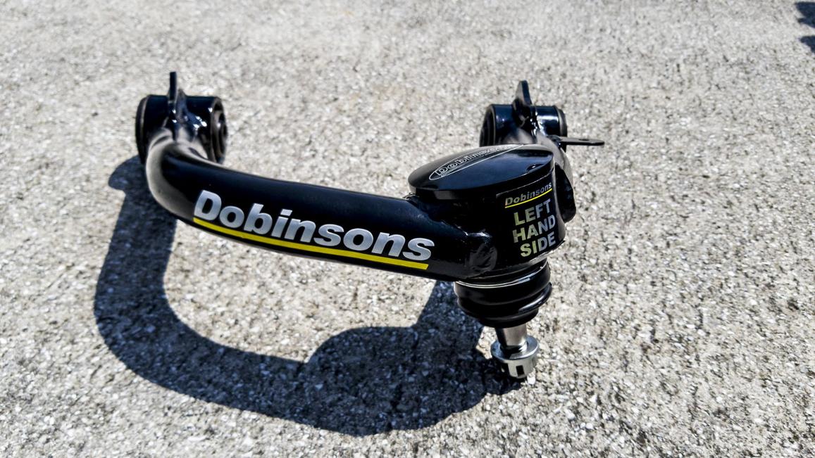

Front UCA Set with Senkei 555 Ball joints - UCA59-002K - Pair of replacement upper control arms to fix alignment issues with 2.5"+ lift heights. Use OE type rubber bushes on the frame end, and replaceable high angle ball joint on the wheel side. 38mm OD tube, 5mm wall thickness (0.2") HSLA steel. Fixed caster of 3 degrees built in.
