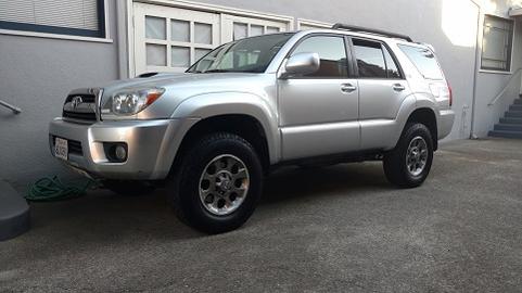

I have their lift springs on mine. It's 2.5 front and 1 inch in the rear. Giving me a level look in terms of fender gap. I took a chance because of the price I bought from another member. It's matched up with 5100 with the front set at 0. They ride really well. Soaks up bump and cornering is more neutral. I can't speak for their branded shocks since I don't have it. My previous set up was 5100 set at .85 on Tacoma springs which gave me close to 2.5 in lift and 1.5 spacers on FJ springs. I call it the Frankenstein set up. I took every bit of pieces of information on here and tried it out. It rode like crap. Borderline dangerous because it was stiff. If you hit a bump on the freeway it would want to leap across. I drove like that for over a year because I couldn't make up my mind on which springs. The only con to these springs is the god damn color. The color is green/teal. It stands out like an odd ball. LoL

Just finished an 11 hour install. New 5100's all the way around with Dobinson stock height springs. It definitley gave me an inch or two because my old springs were the original so they were saggy-baggy.
I repaired a damaged brake line (my fault) from when I did the brakes too so it was a full day. I also replaced my front swaybar links since they were leaking..
