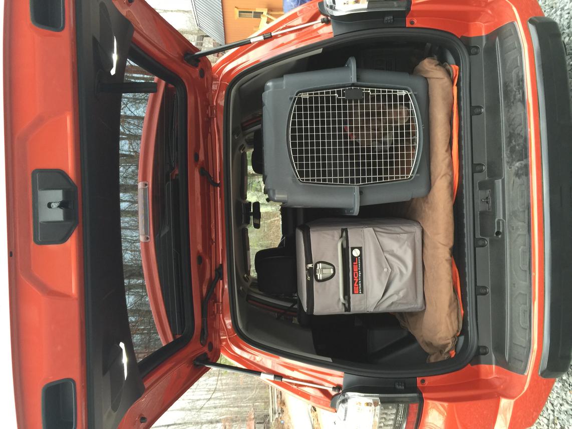

Some test fitting for an upcoming installation. Kennel may change to a ruff kennel. Fridge is a engel mt45.

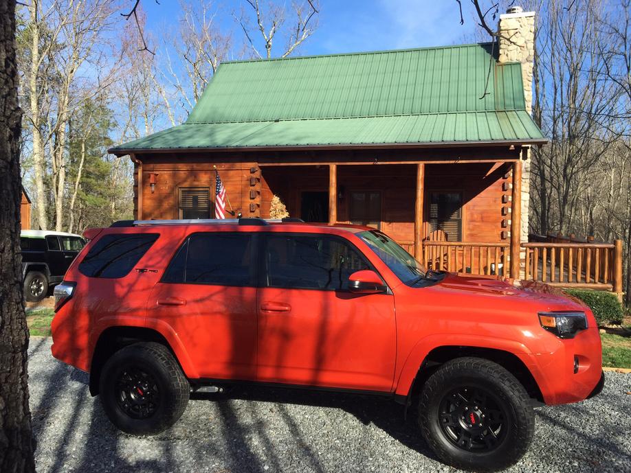

Year: 2015
Model: 4Runner
Trim: TRD PRO
Color: Inferno
Port Accessories: Sliding Tray
Aftermarket See Below
Well it looks like my truck came in to the port 12Feb15 and made its way into the Tire/Suspension shop at the port 13Feb15. Also, had the suspension done and the wheels and tires installed. Was told still needs an alignment, skid plate and Pre-Delivery Service done before it is on its way to the dealer. We are going to head down to Florida to pick it up on Monday hopefully missing all the snow and crap weather that is hitting the Blue Ridge Mountains. I'll start to do lots of little mods while I am down there. I will take lots of photos and notes.
Here is a picture of the 4Runner right off of the Ship into the Tire/Suspension Shop for the Port Accessories.
Here are some pictures after the Suspension is installed. As well as the tires and rims. Note the orange colored Scion to the side, just for those who always wonder how the color Orange compares to Inferno.
We are heading down on 16FEB15 to Florida to pick up the vehicle.

Engel MT-45 Install and Kennel Install
Tools:
Electric Drill
Parts:
Engel Slide Lock
Engel MT-45
Difficulty:
Easy
Installation:
My 4-Runner has a Pull Out Tray.
Take the slide lock and position it on the pull out tray. I positioned it on the left and the rear edge of the tray. Note: you will need larger screws than supplied as the trays core is foam to allow it to hold, also make sure that the slide lock tray is positioned with the release on the front left. With the slide lock snapped together Screw in the 4 corners. I also screwed in the two middle screws.
Clean up any mess before installing the fridge. The fridge slides in to the slide lock. Pull up lightly on the front and the rear of the fridge to make sure it is secure. I ran the power cord to the factory plug for now. I plan on running my own dedicated plug in the future.
Kennel Install:
I also installed the kennel while I was at it. I am not sure if I will replace this kennel with a rough Kennel. I am using a XL Kennel. I installed the kennel so it can be removed easily and with a small modification.
Parts:
Paracord
Cutter
Lighter
Kennel
Drill
5/32 Bit
Difficulty:
Easy
Position the kennel on the tray with the tray pushed all the way to towards the front of the vehicle. Drill one hole in the right corner. Take a long piece of paracord with the end burned with the lighter. Tie a large knot or monkey fist after running the cord through the hole under the tray. Note: There will be quite a mess of foam from the tray you will need to vacuum up the mess. Tie the cord to the tie down point on the kennel. Cut the end of the cord and burn the edge. Continue to do so for all the other corners. When finished I would pull out the tray to verify that you are not caught up anywhere.
My Helper
