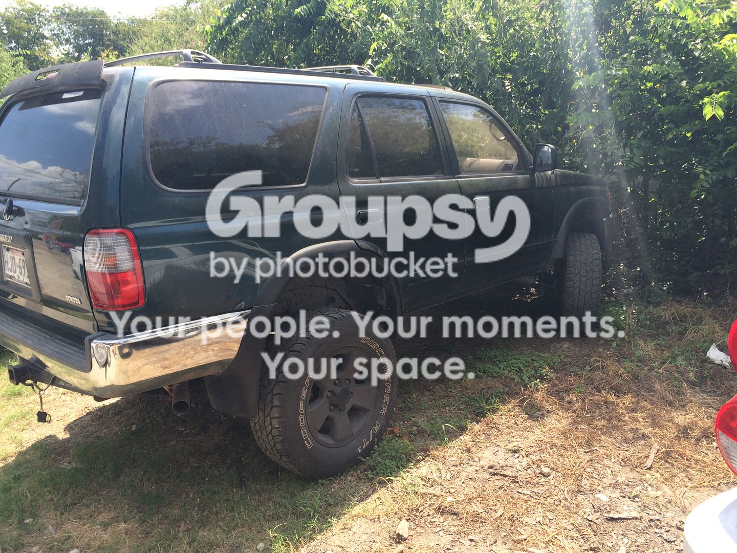

Since then I've put in new bearings in the rear diff and new pinion and axle seals.
<a href="http://s686.photobucket.com/user/LHKing4/media/IMG_1261_zps375f3ab6.jpg.html" target="_blank"><img src="http://i686.photobucket.com/albums/vv224/LHKing4/IMG_1261_zps375f3ab6.jpg" border="0" alt=" photo IMG_1261_zps375f3ab6.jpg"/></a>
<a href="http://s686.photobucket.com/user/LHKing4/media/IMG_1260_zps9c9d68f4.jpg.html" target="_blank"><img src="http://i686.photobucket.com/albums/vv224/LHKing4/IMG_1260_zps9c9d68f4.jpg" border="0" alt=" photo IMG_1260_zps9c9d68f4.jpg"/></a>

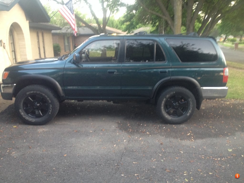

I bought a set of powder coated taco wheels with nearly new Cooper Discoverer AT3's on them.

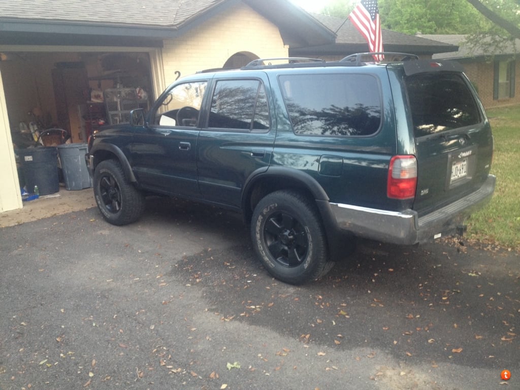

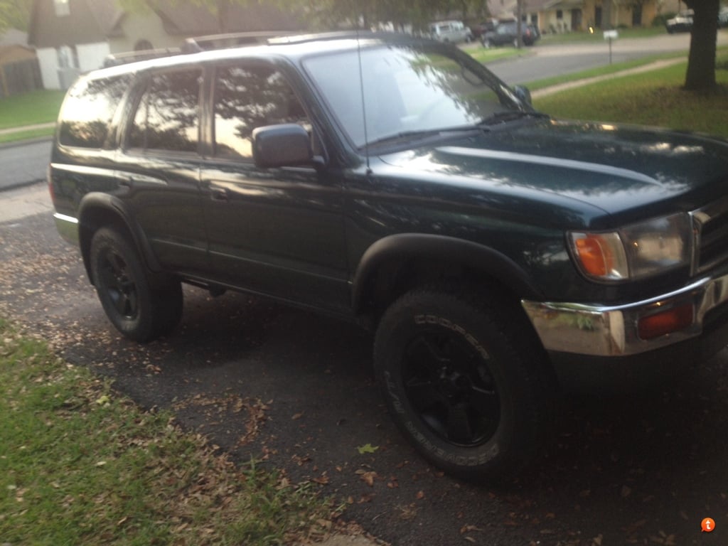

New wheels and tires:
Got my fender trim painted and replaced and whip mod done

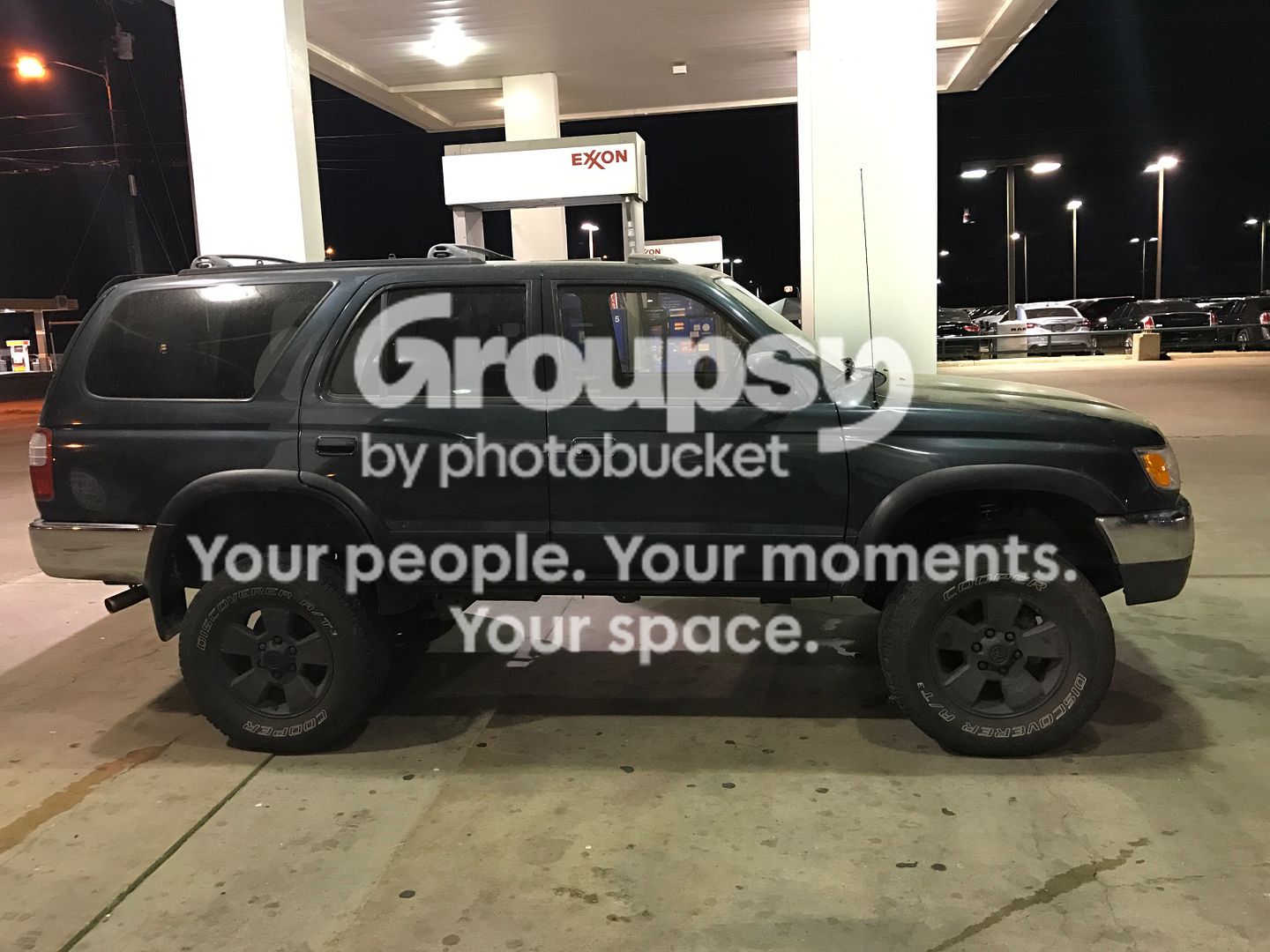

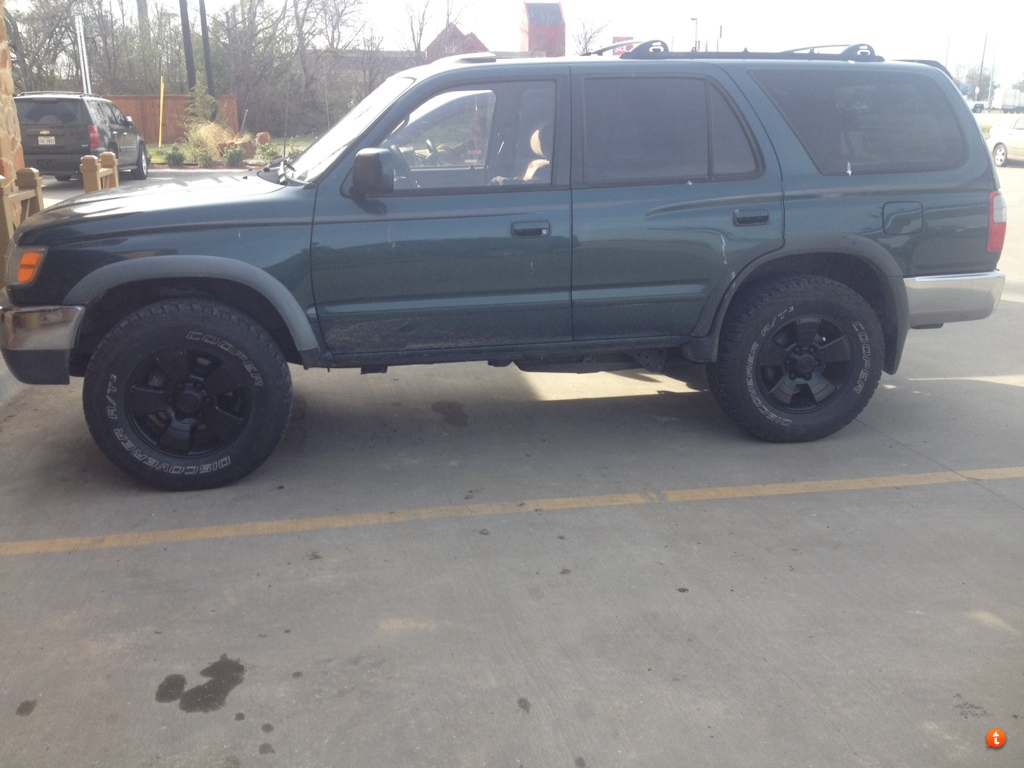

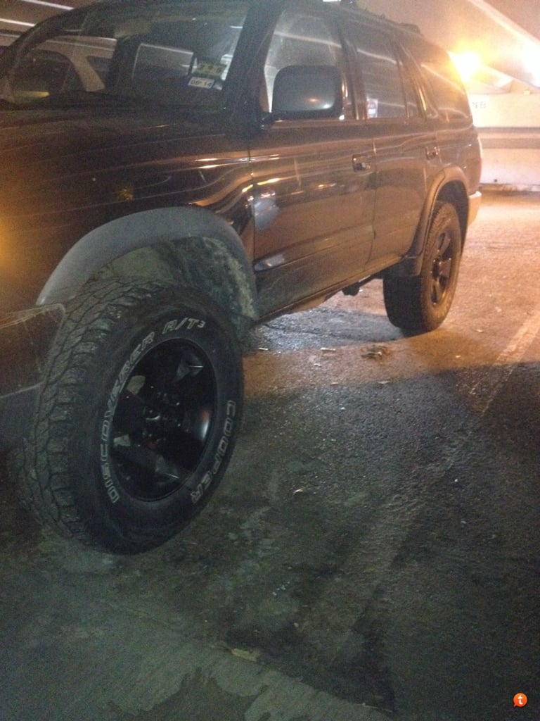

Toytec/Eibach and Tundra Bilsteins up front, LC coils and shocks out back, new steering rack, inner/out tie rods, LBJs, wheel spacers, BudBilt front skid, diff drop installed by my mechanic. My guy hooks me up big time. He can do it faster and cheaper than I can do it myself. It's still at the shop, I've got to get down and pick it up tomorrow. Here's a bad pic but the only one I took today. I'll get better ones tomorrow.
Slightly better side view. Still haven't seen this in good daylight other than the above picture. New batter going in tomorrow and alignment ASAP.
