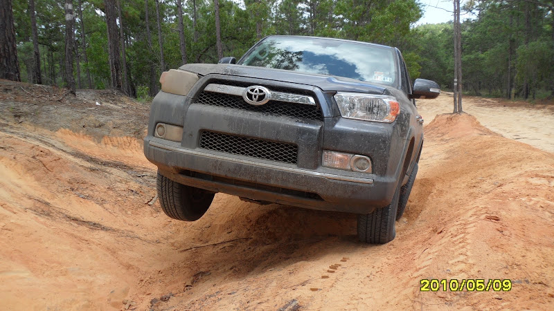

Just a little....
pic stolen from mgrande
