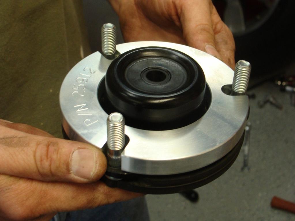

when i built the spacer lift for my 4runner, i took alot of measurements, and built the spacers from solid aluminum rod. i machined the spacers just like you see on the ebay spacer/puck lifts. i ended up fabbing them, and installing them and measuring a few times to find the sweet spot where i got the front end perfectly level. the drivers side spacer is .070 thicker than the passengers. this made the front end level out perfectly. i have 36 1/2 on both sides in the front. (stock tires) my drivers and passengers side spacers are different thickness in order to level the front end out. i dont know if the aftermarket kits are also designed the same way. i build all my own stuff so i cant say if the aftermarket springs or lifts are designed to level the front end side-side but i can tell you a spacer lift needs to be .070 thicker on the drivers side to make the drivers and pass side perfectly level.

no, i actually meant .070. thats 70 thousandths. the front passengers side spacer is .710 thick. thats almost 3/4" thick. the front drivers side is .780 thick, which is a hair over 3/4" thick. the spacer lift i built, being about 3/4" thick lifted the front of my 4rubber 2.4" on the pass side. the drivers side being a hair over 3/4" lifted the pass side almost 2.6" this leveled out my rig. my rig was a cunt hair over 1/4" off. if i can recall.... i built the lift on a sunday and had to fill up the following tuesday, and i drive about 40 miles a day, so i will assume i had about 100 miles left in the tank when i built and measured it all. so i reckon thats about 1/3 tank?
since the spacers go on top of the shocks, they are compounding the rate in which you lift the vehicle. a half inch (.500) spacer lifts the vehicle somewhere around 2 inches so my spacers being .700-.770 lifted me right around 2.5 inches.
Huh? On 4Runners the spacers lift about 2:1 on the front. A one inch spacer equals 2 inches of lift. I put a 1 inch Toytec spacer on mine a couple of weeks after I bought it.http://www.toyteclifts.com/index.ph...tegory_id=109&option=com_virtuemart&Itemid=72
edit: I got about 1 3/4 for a 1 inch spacer.......... Toytec spacer lift
are you "assuming" its a 1" puck because they said so, or did you put a dial caliper on it? believe it or not, i actually do search the forums, and look up info rather than start a million of those newB threads asking questions about simple things.
so i will refer to antman's thread about the spacer lift install. when i read thru his install, simply to figure out how thick his spacer was and how much i needed, i looked at his pictures closely. i never actually went to toytecs lift site untill now to find out the actual dimensions. i was only going off a visual perspective. in his picture i will post below, you can see the thickness of the spacer is less than the width of the guys thumb, i measured my thumb and got a whopping .651, so i assumed by the angle of the thumb in the pic, that this spacer lift was somewhere in the neighborhood of a .550 or .600
42373d1302488274-sp8ball-s-mod-thread-stealing-other-poster-s-ideas-since-mid-2010-dsc05142.jpg
after reviewing his before/after pix he claimed a 1.25 lift in the front respectively. i went with what was an assumption. i assumed his .550 spacer gave him about 36" solid. i wanted a taste higher so i gave it a judgemental overall thickness of .800 to start off. i installed it, backed the vehicle up, turned the wheels a few times and pulled forward and measured. it was high in the front, so i took it apart and machined it down more. i did this 2 times till i got the height about what i wanted. i have 36.5 pretty much on the nose on both sides. it took some tinkering and a little measuring and some guessing but i got it right where i wanted it. i put a .500 spacer in the rear spring assembly, and ended up with about a 1/4" rake with the rear being 1/4" higher than the front. i kinda wanted a taste higher in the rear so i plan on building another spacer for the rear and going up to somewhere around .700 in the rear. i want a taste of rake but not too much.
after reviewing and doing a little searching a few mins ago, i found that the toytec spacer he installed claims to be a half inch (.500) and equaled somewhere around 1.25" lift
the 2:1 theory is very close, not an exact science, its a close guestimate. my spacers being .210 thicker than his, gave me about .500 or a half inch more clearance. if you wanted to put a concrete number to that algorithm it would seem more like 1:2.38 which is still close to the 1:2 that is assumed.
