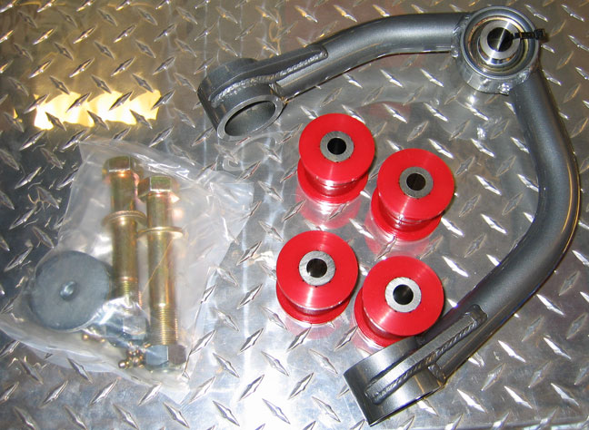

RL - Looks great. I'm thinking about the UCAs but $550 is a bit much for those, I think. Do you know how much the Hoes' UCA will be?
Nope, but I will bet there will be a package deal.
good stuff will be expensive. currently you have 2 vendors to choose from: Inland Truck and Total Chaos.
Once Donahoe is ready to release their UCA's they will be 3rd on the list.

Lance, maybe you could tell the good folks here why the new upper A arms are better than the stock ones. Why the "uni ball" used in these works better than the regular ball joint.
Yes, please do!
I would write my 2 cents but sean did a great job writing this one up so here it is :) The full article can be found here:
http://www.trailslesstraveled.com/viewarticle.php?id=35
Keep in mind that this article was based on a review for Total Chaos' UCA for the Tacoma. So the photos in here will not exactly apply to our 4th gens but it's just a reference point.
Uniball are better because it dramatically increased durability and strength as well as the potential for additional, useable suspension travel with better suspension geometry (on lifted trucks).
This image shows the full extension of the suspension (example but not specifically a 4th gen but this will give you an idea of what kind of angles it experiences). Note the extreme load that is placed on these stock ball-joints. Premature wear is a problem that is accentuated by additional lift, suspension travel and the extra weight of larger tires, not to mention hard off-road use.
The difference in quality is obvious in these two images, and the fault does not lie with Toyota. Ball-joints are adequate for most stock trucks, especially within the range of intended use by the manufacturer. They just werent designed to compete with the race-bred performance of these Total Chaos components.
Once the installation is finished, cycle the suspension fully to check for any interference. Because of the suspension geometry that Total Chaos achieves, on some trucks the spindle will make very slight contact with the upper coil bucket (usually only about 1/16th

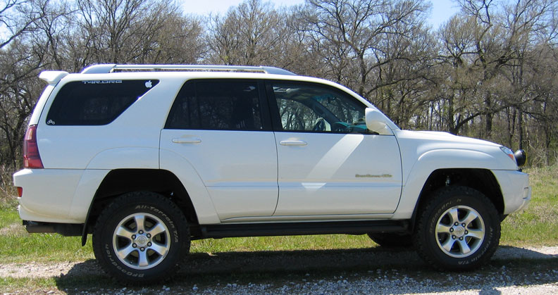

measure from the ground to the fender in the front and rear, would love to know how much lift you now have.
Tonights measurements: FR - 37.25 FL - 37.25
RR - 38.5 LR - 37.75
More consistent than I expected. I do have a full tank of gas.
The front looks great a little more than 3" of suspension lift 3.25" or so. I take the BFG into account.
The rears look a bit off, more than 1/2" is a bit much. Using Revtek or NE spacers in the rear? I assume Revtek shocks.

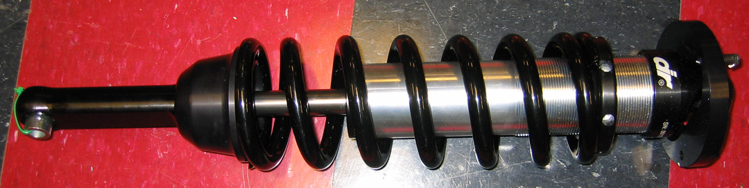

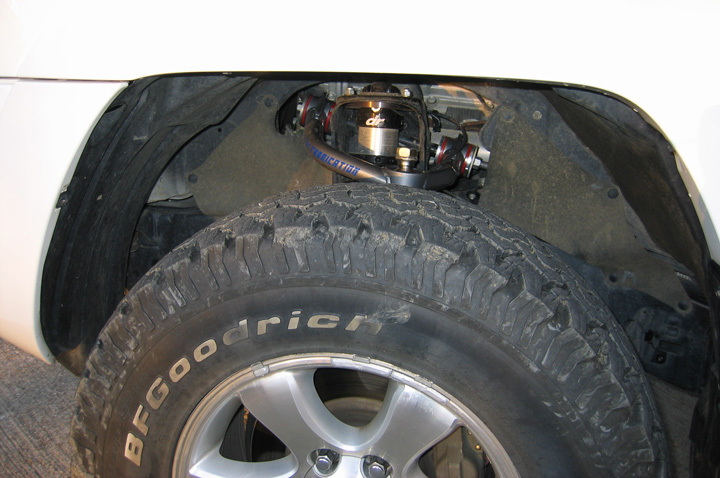

Here is another place these coil overs work great, washboards. Even some of the blacktop here in Dallas gets a washboard effect at stoplights where there is a lot of truck traffic.
The stock suspension was affected a little by hard braking and turning on the washboard. There was a little clicking from the VSC and ABS.
The spacer lift kits changed everything. They didn't allow for the necessary compliance for the tires to maintain contact with the ground. Thus it was full ABS and no braking with the same movement.
The Donahoe coil overs have given me the braking over washboards I expect from the 4Runner. That is, the washboard surface of the road has no effect on the hard barking and turning movement. The downward pressure the Hoe's place on the tires keep the contact with the ground constant. No clicks or pops from the VSC nor ABS.
This quality of the Donahoe suspension is something that you would have to drive to see. Low speed compliance over ruts and surface flaws as well as high speed firmness to keep the 4Runner going in the inteneded direction.
Additionally, I have been taking freeway ramps at increasing speeds and think that the firmness of the Hoe's offers everything the Xreas did, if not more.
