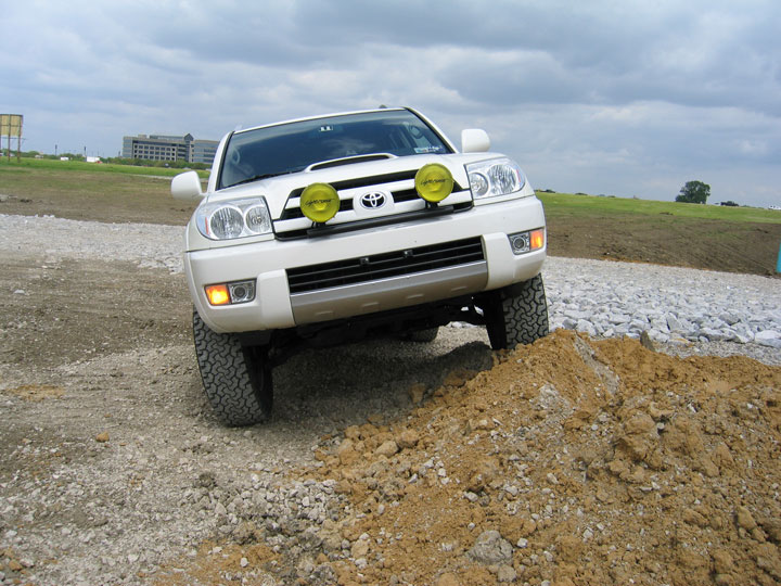

THAT'S PRETTY STINKIN' COOL!!! I love it!! I've been looking for a side shot!
Question: Now that you've "improved" the suspension. How does it ride compared to the stock X-REAS? Obviously it's lifted, so that's an advantage. But, if you were buying a new 4Runner, would buy an SR5 or the Sport model? Does it lean or feel more top heavy now?

I purchased the SE because I wanted the bigger Lexus brakes, the 17" wheels (I always keep factory wheels), and didn't want the extra stuff that came with the Ltd version. Xreas was very attractive too - only later did I learn how expensive it is to repair at the dealership. Oh yea, I like the scoop too.
The ride is better than stock, and much better than with the spacer lifts I tried. I feel better on freeway ramps now than I did stock. Mind you, it is not the same as the Z06 I have driven.
Regardless of the amount of lift you dial into these coil overs, the ride and drive is superior to stock. But then, you might expect that for the $2,200 cost of the parts and installation labor.

Thanks. The more I challenge the front suspension the more I'm glad I made the investment. There is a street here with surface storm drains at every intersection. The Hoe's make blasting across them smooth.

Good Times would be the best source for maximum info. When the installer completed mine they said that the 3+ lift I have is it, and still do an easy alignment. The Donahoe's come with 2.5" of lift set. On my set-up I was limited by the NE rear spacers which I kept awaiting suitable replacement springs. The installer leveled the frame making for the ideal ride height. The easy part of the Donahoe's, or any other coil over, is that we can easily readjust the front lift with a spanner. Small adjustments are not supposed to affect the alignment.

Knowing what I do now, and if there were no other option than a spacer lift, I wouldn't buy one. 1) Too stiff of a ride, which transfers too much of the jolt to the 4Runner. 2) The stiff suspension caused the 4Runner to hop over sharp pavement angle changes. 3) The tires would lose contact going around corners where there was a crack or pothole.
The Donahoe coil overs, for not that much more money, make a huge difference. All the best parts of a compliant ride found in the stock set-up, yet the ability to go well beyond the speeds of the stock 4Runner with full composure.
I was chasing after an end-dump that had just dropped a load on my project. I was flying across a hard, rough & rutted field at over 50 to cut off his escape. The ride was smooth and controlled.
